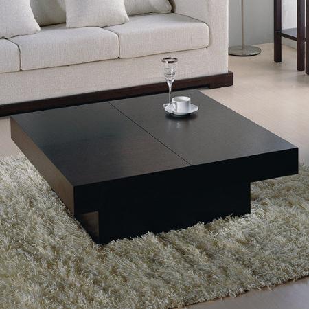

Hi!
I need a coffee table for my living room. After an extensive research I've noticed that if I want something in my taste, the price is sky high (to me) for a relatively simple thing.
Hence now I'm thinking about building my own table. I want it to look something like in the photograph below. Just simple, with no hidden storages etc.
I was thinking about building the structure of an MDF or plywood and I think that I should not have any particular problem with that (I might be wrong though?). The problem is painting. I do not have much expirence in this field. I want the surface to be hard, durable and shiny (high gloss). My questions are:
1. Are MDF or plywood (which?) right materials to use?
2. Is it possible to achieve a smooth and glossy surface without a specialist equipment?
3. What kind of paint, primers, (varnish?), equipment do I need and how expensive they would be?
The job could be done in my friends garage so the time or smell are not an issue. The structural material would be cut to size by my local wood supplier. I've got a 1/2 size sander. It is not a top class stuff but it does the job.
Thanks you guys in advance for any input!

Not really - MDF is the material to use, and essentuially all you are building is an upturned box fixed on top of another upturned box, so....
Unless you are an experienced sprayer with the equipment I'd say forget the high gloss unless and go for something somewhat more achievable. High gloss requires decent spraying equipment and high quality preparation work - which is why car sprayers charge so much for it!

1. MDF - you'll never hide the end grain of plywood all that well
2. I very much doubt it.
3. You'll need to be able to sand-out the surfaces to about P320 - so a decent orbital sander at the very least. The finish is obtained by sealing the MDF edges (2/3 coats), flatted between coats, then building several coats of high-build primer, flatted between coats to P400 minimum, last coat taken to about P1000. Next surface colour build, 4 to 6 coats of matt acrylic, denibbed between coats, finally 2 to 3 coats of clear acrylic lacquer, again denibbed between coats and buffed-out with a body polisher and through several grades of Farecla on a wetted foam mop. Cleanliness IS next to godliness in high gloss - NO dust, EVERY piece of kit air-blasted out or vacuumed out at EVERY grit change

If you peg your requirements a bit lower - at, say , gloss, a lot more can be achieved

You can get a relatively smooth finish, providing you use a short pile sheepskin roller cover - just as you would for oil glossing a door. Please note that a gloss finish is much easier to obtain than a high gloss one - hence my differentiation
