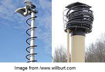

I would not venture an answer other than an undocumented recollection that the SWR ( Standing Wave Ratio ) of a transmitting antenna on an extending mast varied depending on how far the mast was extended, Was it the coiled feeder cable or the varying distance between the antenna and the roof of the vehicle or both.
A mast like this
As I understand it, SWR will only vary if the relationship between the impedance of the load/termination and the 'characteristic impedance' of the feeder changes - and I wouldn't have thought (although certainly may be wrong!) that coiling would affect characteristic impedance (appreciably if at all) - that (I thought!) being primarily dependent upon the dimensions of the inner and outer conductors and the nature of the material between them.
Height or more correctly distance between the antenna and the ground would have a very significant effect on the impedance - so much so that any effect from a coiled cable would be undetectable.
I'm sure that's true, but the ('my', or my friend's) question is whether or not, for a given distance between the antenna and the ground. the difference between coiled and non-coiled cable would "be detectable"? Do you have a view on that?
