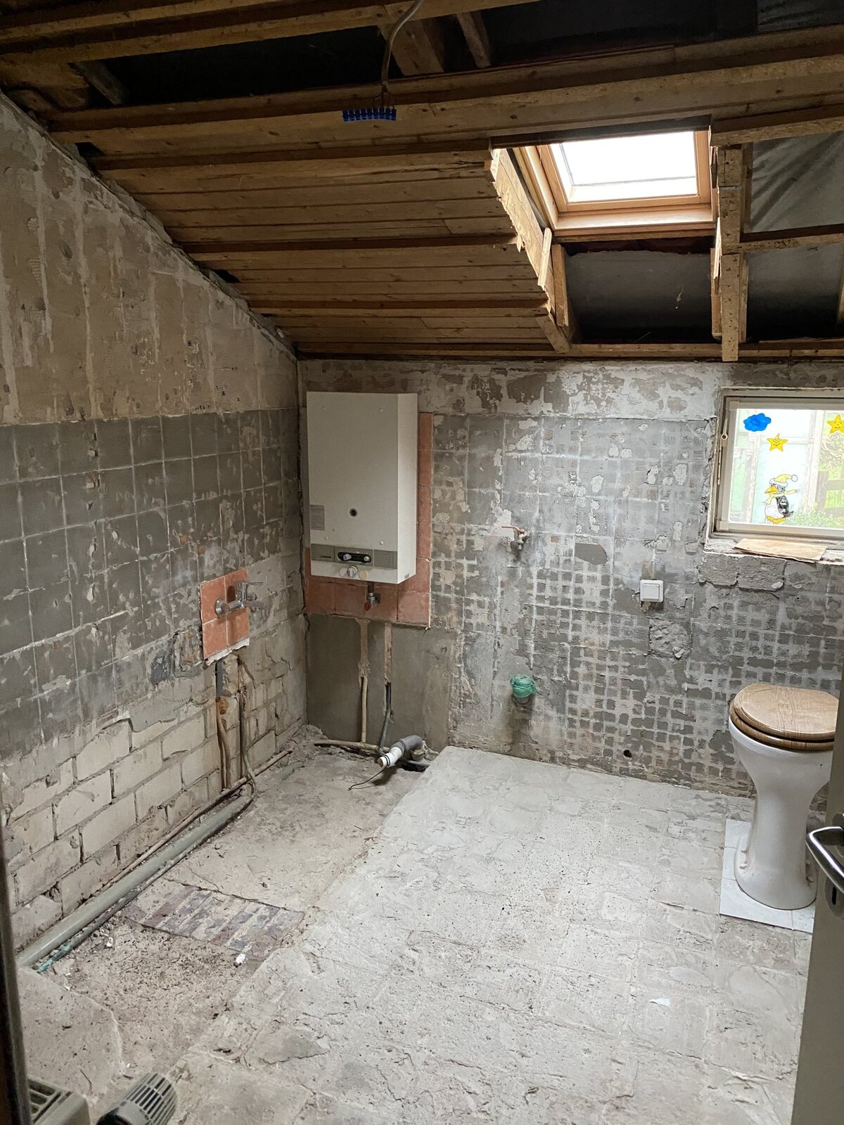

We are having a new bathroom installed in our unoccupied house, and just finished demolishing the old bathroom. This includes removing the ceiling which exposed the roof. It's cold in the room now and I don't really want to leave the heating on in this room. There is a hot water boiler and the taps are still connected. The pipes are not drained and the boiler is still on. The radiator is set to the frost setting.
If there are some days and nights where the temperature drops to 0C, is the water in the pipes at risk of freezing? I don't really want to turn the water off at the stopcock and drain the entire water system because we are visiting regularly and doing work and having running water and heating is very useful.

The hot water boiler is actually in the bathroom. There is no hot water tank. We have 2 boilers. One for the radiators, and another for hot water. You can see the hot water boiler in the attached pic.
The heating boiler is from '96 and there is no program.

Is there a thermostat anywhere in the house for the radiators? If yes, set that to 10° and leave the boiler on (so if temp drops below 10 it'll fire up and warm the pipework and radiators).
I'd be tempted to turn the cold water stoptap off while you're not at the house- if a pipe does freeze up (low odds unless it gets really cold) you'll get a small puddle on the thaw rather than a disaster

The least I would do is turn off the incoming main when the house is empty.
No the only thermostats are on the radiator valves.
Ok if I turn off the water at the stopcock, that shouldn't have any effect on the heating system because it is a closed system, right?

That's right. And if you sping a leak it will run out eventually

And yes, ch will run fine with cold supply off.

I don't remember seeing a controller during the viewings. You set the radiator to 3 and the room should heat to 20C.
