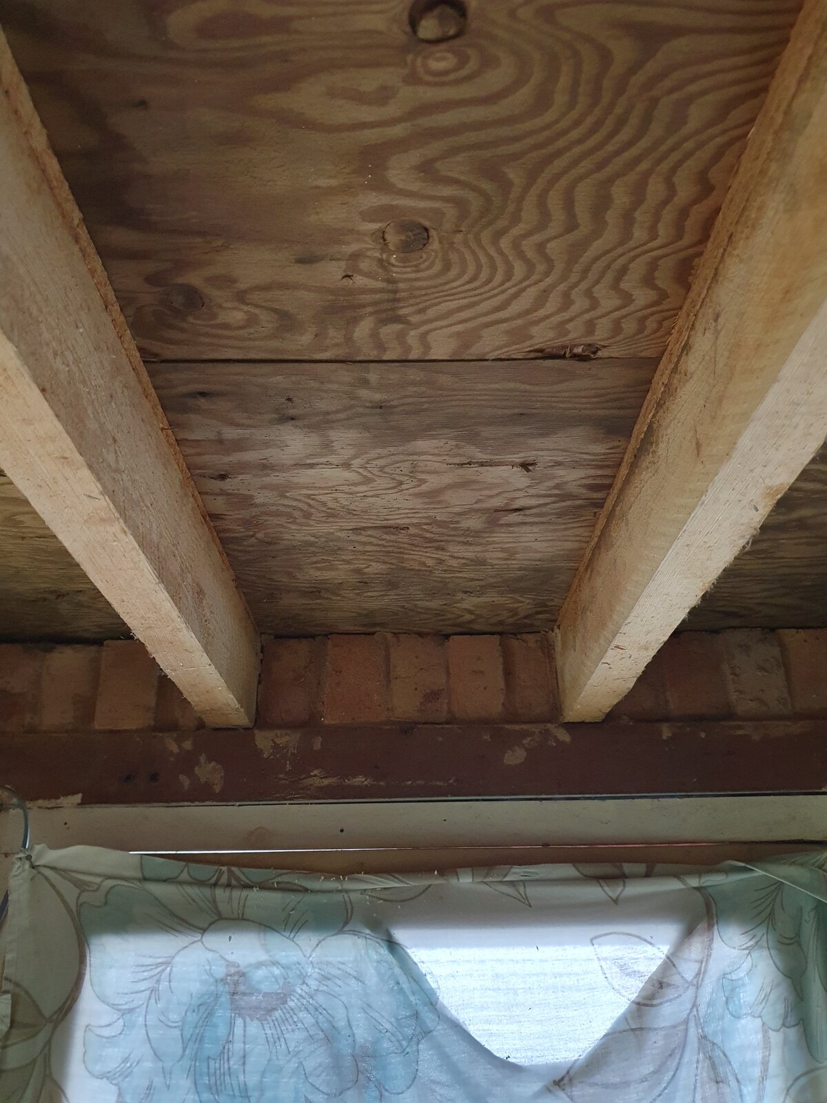

I am an absolute novice DIYer trying to insulate an already existing outer building for my small lizard collection.
I thought insulation would be easy, however the theory that seems to go in to cold roofs to ensure they are warm, and do not rot seem to be much more complex than I imagined...
The problem I have is that I have no ventilation or overhanging from the flat roof to add some.
Is there any other way I can sort this and make it work?
I have built a stud wall away from the already existing brick wall and this has a 50mm gap the whole way around the room, including up in to roof.
Hopefully the photos explain better than I can..
I did try and put board up, but after 3-4 days I started to see water marks coming from under the roof beams, I took it down and the roof was soaked.

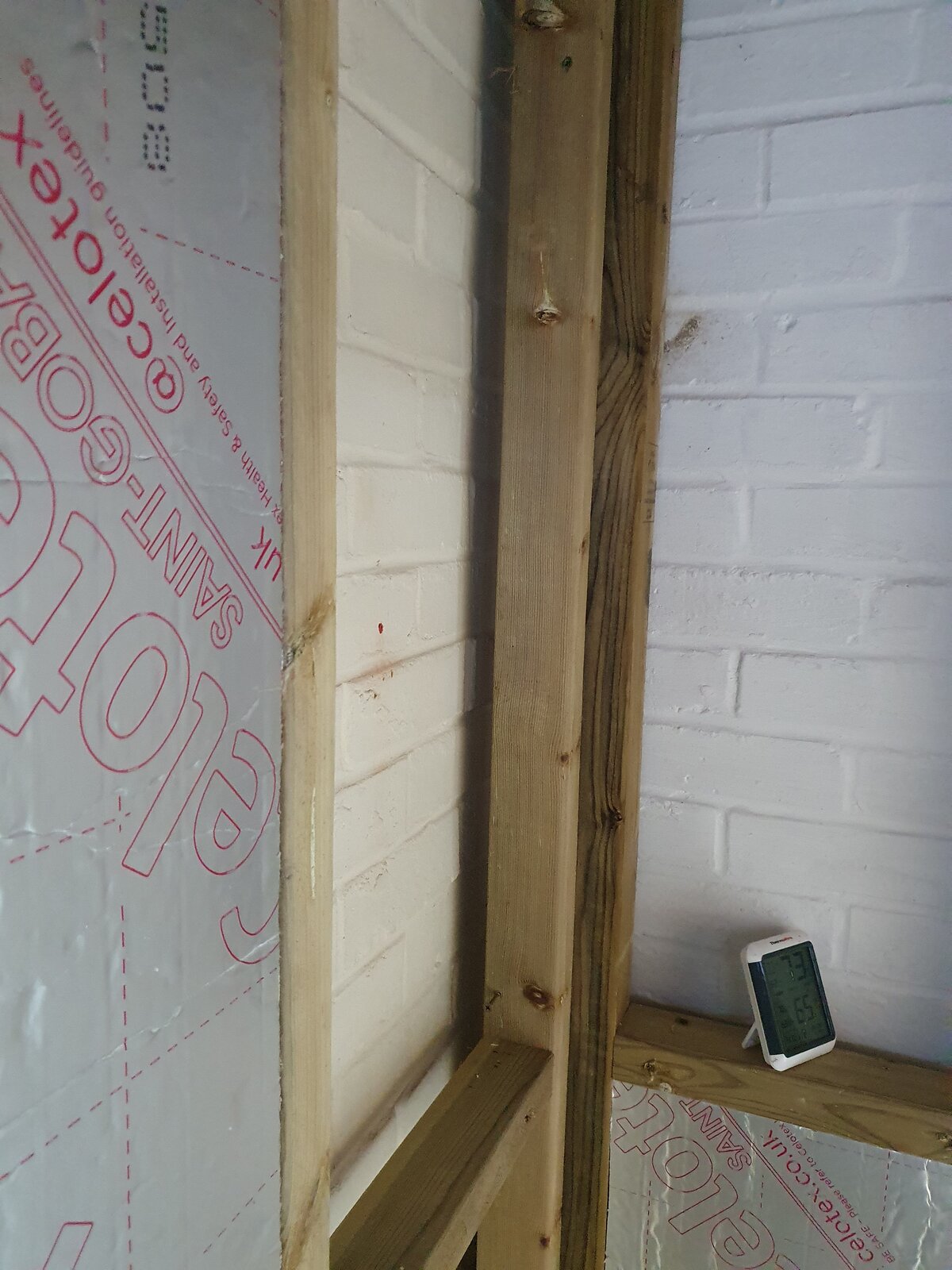

Finally, in regards to wall insulating, I do not need ventilation other than what I have correct? I still have a 50mm gap from wall.
I guess what I am asking is, am I OK to fit the rest of the PIR boards to the walls without worrying? I do not need to seal walls or anything stupid?
Any help massively appreciated. Losing sleep over this as Winter and Storms draw in quickly.

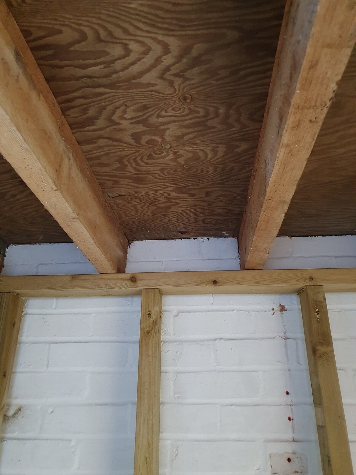

Photo 1 ) Looking upwards from wall into roof.
Photo 2) Wall Insulation.

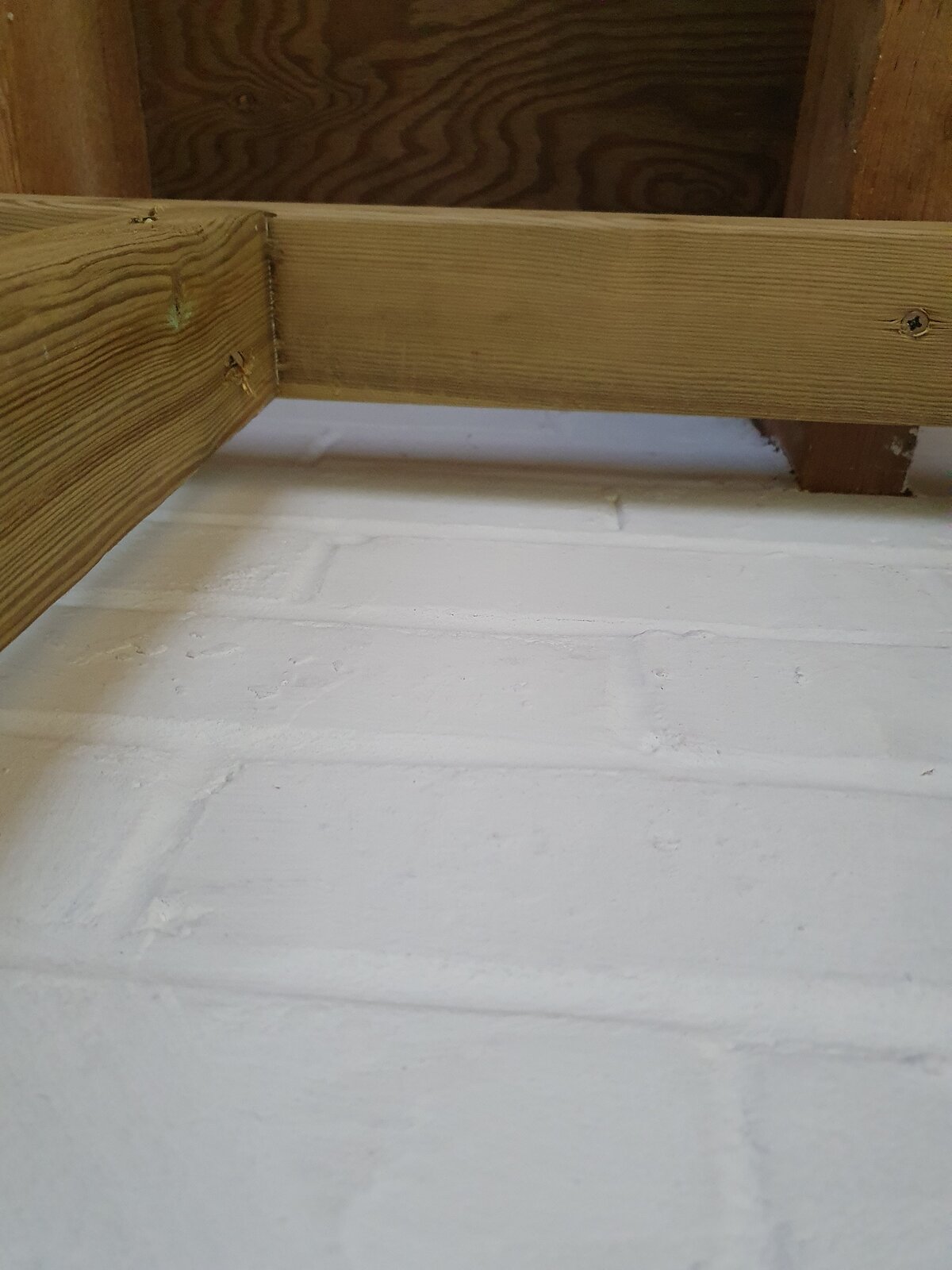

Photo 4) Roof side 2.
Water is coming from where? Best to get that fixed or it will ruin everything else.
No water as such.
When I looked up I saw water marks coming through the beams either side of the 1 where I had laid insulation.
I had basically done 1 strip, between 1 beam.
If you look at the final photo, imagine that gap between the 2 beams had a strip of PIR board between them.
What I saw is water marks in the 2 canals either side, just starting to seep across.
Complete novice and really struggling to explain myself. Was hoping someone would =D
When you say water, presume you are talking about condensation.
Lots of flat roofs are now warm roofs insulation on outside, which will help stop condensation.
Insulation on inside can promote it, hence the need for ventilation. Can you add any ventilation?
If not, I've seen it mentioned on here, that you can push the insulation boards up, tight to the underside of the roof and leave no gap, the idea being condensation can't form. Not something I've done, so wait to see what other comments you get from others who have.
I'm presuming you will be using insulation boards for the roof?

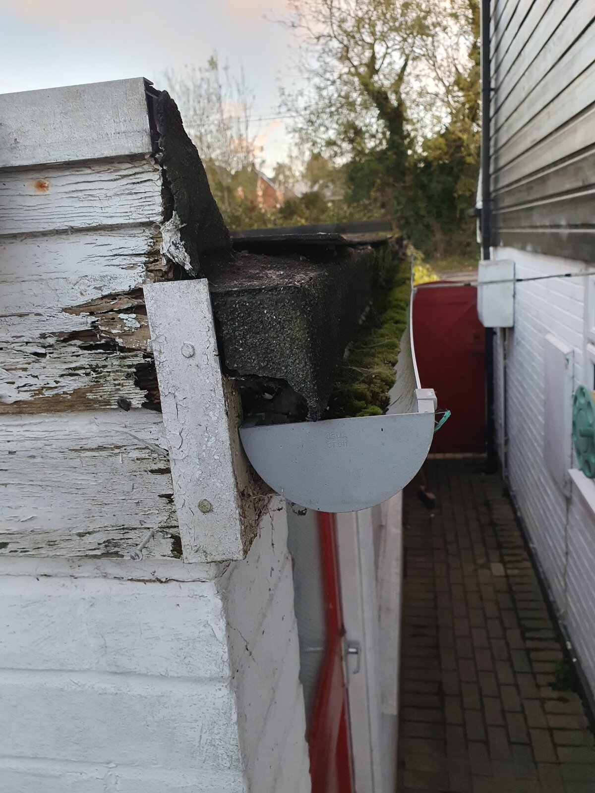

You say that you have 'no overhanging' on the roof.
Does it have a gutter, where does the rainwater go?
If you removed one of those bricks that sit between the rafters, would it lead to the outside?

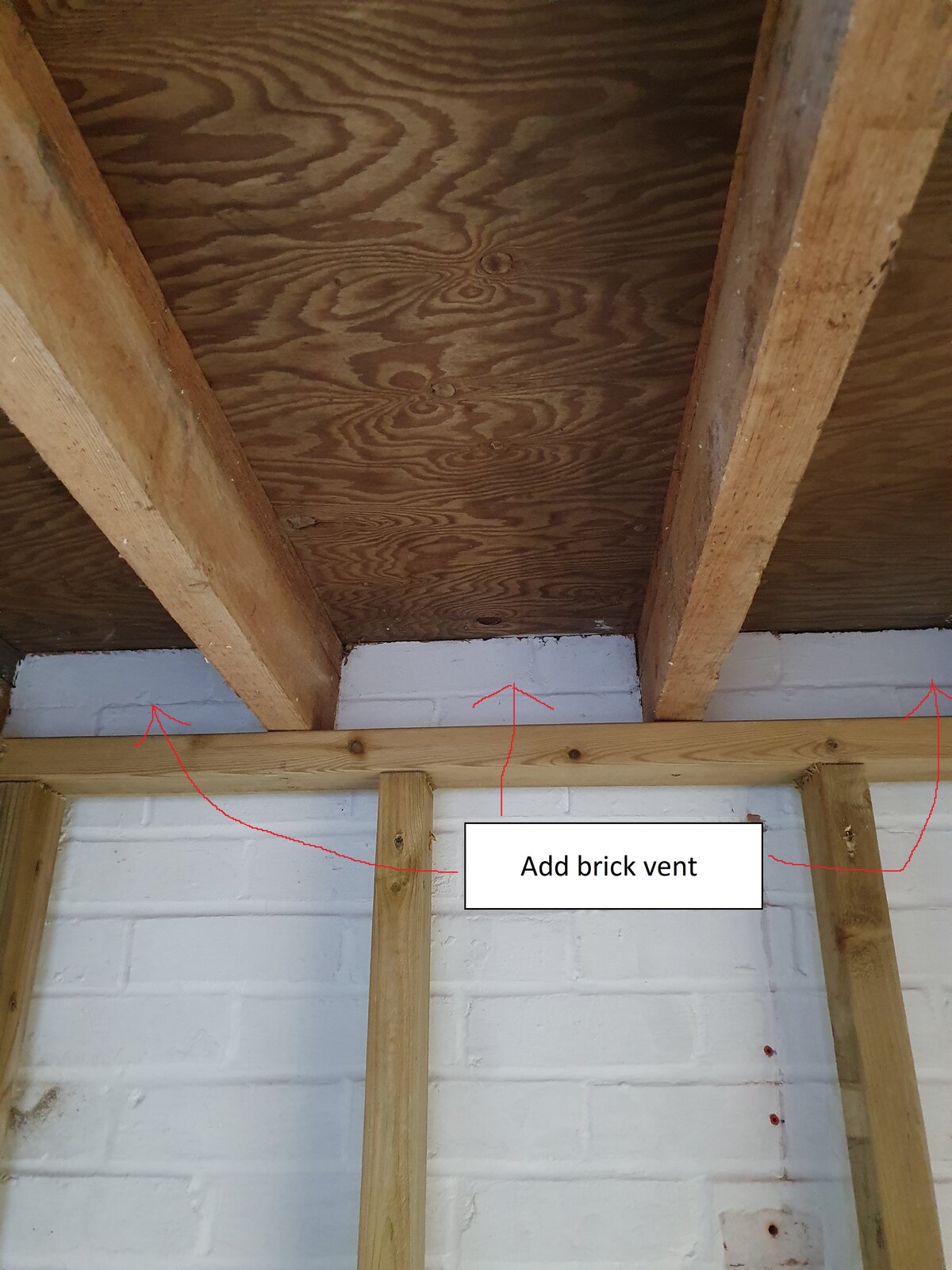

I was hoping I could remove a brick high in the wall and that would cause ventilation behind the studwork and up in to rafters. Is this something that anyone has heard of working?
Like this..

Are you sure it's condensation? I can see a gap above the curtain, opening to the out side. Condensation can only occur when warm air meets cold surface. Having a gap like that, I don't imagine there is much warm air.
Yes exactly that. You could fit an air brick between each pair of rafters to add airflow.
You will then need to leave a minimum of 50mm airgap between the underside of the roof and the insulation, and preferably insulate underneath the joists as well.
Looks like you have 100mm deep joists, so wedging 50mm of insulation between, flush with the joists, and then a minimum of 25mm underneath (or as much as you can bear to lose ceiling height)
Don't forget your vapour barrier, a thick plastic sheet over the whole lot, or aluminium tape over all the joists and edges of the insulation boards.
For airflow, it's really advisable to have cross ventilation, ie: the air can pass from one side of the roof to the other.
Do check that the roof definitely isn't leaking after a heavy rain shower before proceeding.

I can confirm it is definitely not leaking. The "Gap" you can see is the gap between the top of the door and the closing panel. That sheet is over the door.
It was only soaked under the one board I had put up as tester, and I had watched it for 2 weeks prior in bad weather with no leaks, and since - no leaks.
I had put up a length of PIR board, and only left 1 end open with air flow (Not parallel air flow, as I mentioned with not taking the PIR all the way to the walls and thinking the air flow would go up and under. 2-3 days later it was soaked. The room would have been a steady 22 degrees.
The joists are actually measuring about 125mm at the highest point, and 100 at lowest. I have 60mm PIR board.
Adding 20 air bricks is not ideal, but if that is my game plan, then that is what I must do.

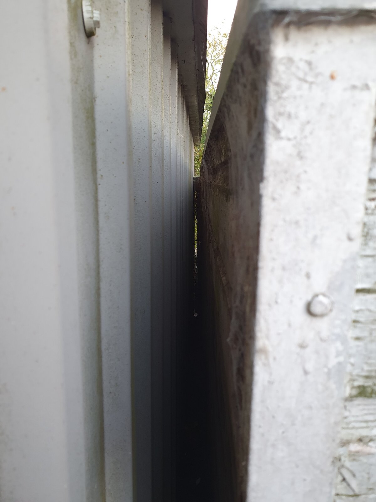

On the other side of those top bricks is there a fascia on the outside?
You could just knock out a brick and have your vents on the fascia/soffit.
I have no real idea, so here are images :)
The roof isn't great, I need to get it done come the warmer weather, but i just need to get through winter.
If the roof isn't great then the water is coming from the outside. Trying to insulate a failing roof seems a waste.
The water is categorically not coming from outside, as I have stated.
When it appeared and I found it, it had not rained for a over a week, since removing it is has done nothing but raid 20 hours a day, and there are no new water marks, wet marks, dampness or wetness anywhere in the room.
The underside of the roof was very cold, and very wet upon removing the single piece of PIR board I had put up.
