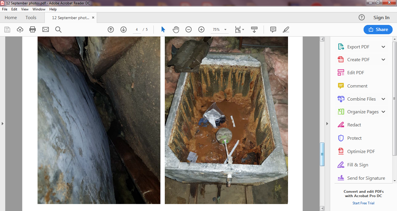

is there any legislation or anything to state a CWST in a loft needs to be ion a platform. I had insurance work done and they have removed the old tank and left it on 3 x 2 beams and its cracked leaking the remain of the tank in.
I need abit of proof to say you cannot leave a heavy tank not on a platform.
Much appreciated
If full of water, definitely needs to be on platform to spread the load, or the tank will fail because load is concentrated on too small an area. Also needs to be in area with some kind of solid support underneath, ie. top of walls or other substantial structure. Lot of weight in a full tank. Each litre is a Kg.
Its not full of water but this is how they have left it and it cracked the ceiling below . ( Dyno Rod).

In short with your old cistern. There is no requirement for it to be on a platform other than common sense dictating that the residual water shouldn't be a risk and the weight is spread across enough area to not cause a sag in the ceiling.
The new tank needs to be on a platform that is larger than the footprint of the cistern and is covered by the manufacturer instructions and IIRC the building regs.

They was not ment to remove the old tank. They was ment to install new in a separate area of the loft. Engineer decided to move it on own with water in and the base of it crack leaking on ceiling below causing a brown stain. Also moved all the insulation in the loft to put it there.

A photograph of the cistern from above and the damp patch below should be proof enough.
The problem is how they left the insulation and moved it with water it and it leaked on my ceiling below .
