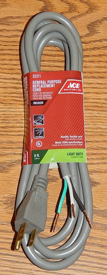

So yes, the color coding on flexible cords follows that of fixed wiring: Black = live/hot, white = neutral, green =earth/ground. That's where color coding is used, which is normally just cords which have a separate outer sheath (types referred to as SVT, SJT, etc.).
Many appliance cords where a ground is not required are still of a single-insulated type, akin to the "figure-8" or "zip cord" which used to be used in Britain years ago (type SPT, commonly referred to as lamp cord). Where identification is required, you'll find that the strands of conductor are different inside: Plain copper is used for live/hot, silver colored for neutral. A similar convention is applied to the screw terminals on some plugs and receptacles: Plain brass-colored heads are the "hot" side, plated silver color for the neutral (and the ground terminal screws normally have a hexagonal head with the top colored green).
Where needed, 4-core flexible cords add red to the black, white and green for the second "hot" conductor, as typically found for heavy range cords.

Here you go, this is a typical replacement cord with molded plug:
