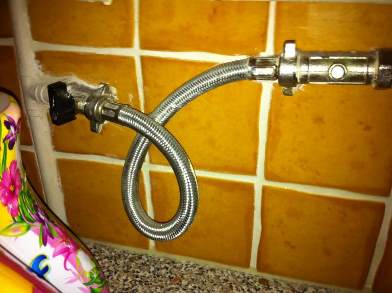

Oh, also, the refill pipe to the boiler is permenantly connected? I hear this is a "bad thing"?

This is not supposed to be permenantly connected? right?
Can I remove it somehow without water spurting everywhere?

Ive been turning that black valve to top the boiler up when the pressure has been getting too low... so yes, it is turned off but its still connected to the mains supply... If I take it off water will go everywhere...
The end with the black head on the valve is turned off, the bit in the other end of the braided hose is a non return valve. So, unless any of the valves on either side of the hose is passing (the black one is unlikely), it will be ok to remove the braided hose (leaving both valves in place).
