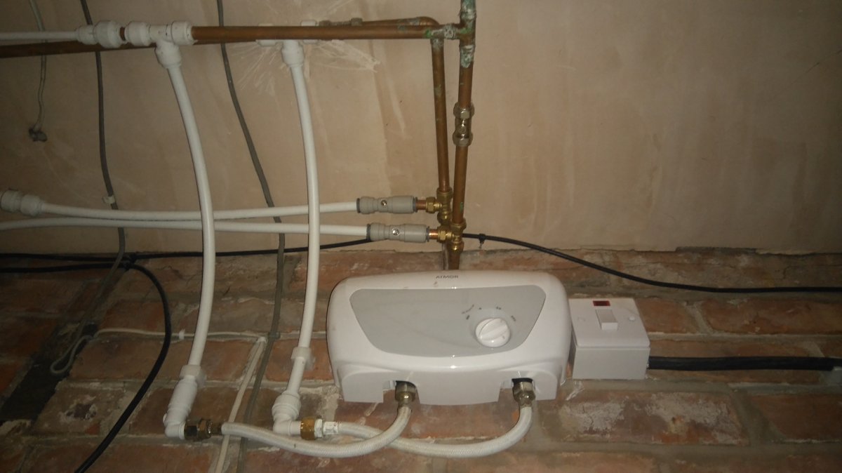

To cut a long story short, as part of the en-suite refurbishment, I replaced the old electric shower in the en-suite with a conventional shower but also installed a 10kW instantaneous electric heater in the supply pipes to the en-suite.
I was lucky in that the H&C feeds to the en-suite run at garage ceiling level (the en-suite is above an integral garage) and it was simply a matter of mounting the water heater high-up on the garage wall. By means of a series of valves, it's possible to supply the hot pipe via the boiler or the electric heater. The old high current cable that previously ran to the electric shower was rerouted to the instantaneous heater.
This arrangement has the added benefit that, as well as the shower, the basin and bidet in the en-suite are also supplied from the electric heater in case of boiler breakdown.
I then got to thinking that every combi boiler installation could be backed-up this way. Simply install an instantaneous heater close to the boiler with a changeover system...

I can see that having a copper cylinder for solar would be a must, however for most standard combi installations I think my solution is cheap and space saving. Here's a pic of heater in place

Sorry for resurrecting this almost four year old thread but my boiler has broken and I'm using this project in anger - so glad I did it!
Genius!! So you shut off the hot from the boiler and the heater feeds hot water direct from the cold pipe?
So if you did similar in, for example, an onsuite in a loft conversion you could supply it with a single cold pipe?
You certainly could. The other benefit I am finding is that the hot water comes through much sooner, as the source of heat is close to the place of use - I might leave the en-suite in this mode even when the new boiler is fitted...
