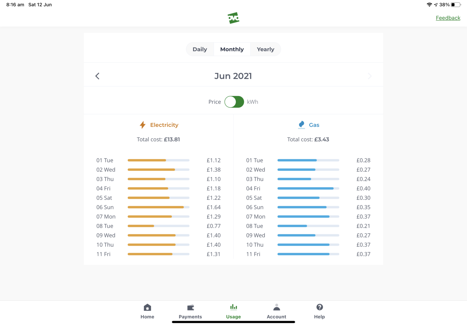

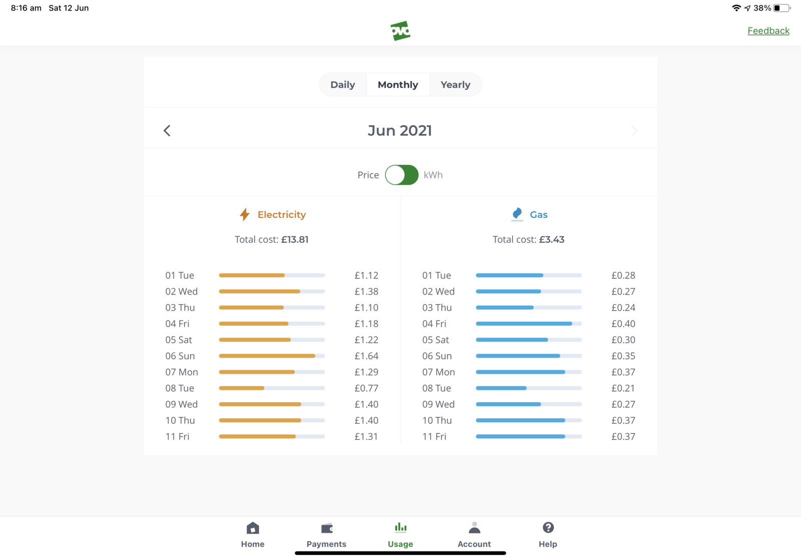

Our gas heated hot water is on 24/7. We're never short of hot water. We also have a gas hob. Two of us having a long shower each day. You’d be surprised how little it costs when you are just heating water in the summer when the heating is not being used. Literally pennies. I think it would probably cost more if it was on a timer.
