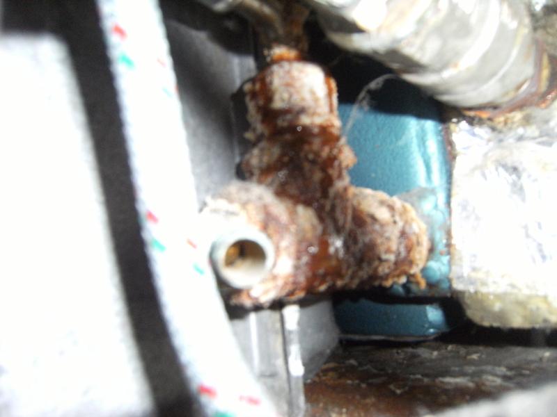

I am the long suffering owner of a Grant 90 Combi boiler. This has caused a right bit of trouble over the years and has its second pressure relief valve problem in a matter of months.
With the problem recurring so quickly, I called the guys back to sort it out. they have highlighted the fact that a valve at the base of the boiler is severely corroded (which i can confirm) and that the boiler is done and needs replaced!
If that is the case then i could give consideration to changing to gas but it seems odd that a boiler be beyond economical repair after such a short time (it was installed by the previous owner of my house). Could this be right?

It could need replacing, depends really on how well it was installed in the first place. In the last three weeks we've replaced two oil boilers, one six years old and one nine years old, both with knackered heat exchangers that were BER. One definitely had no corrosion inhibitor in the system whatsoever and I suspect the other didn't either, this is always going to lead to trouble. Could well be the same issue with yours, it's rusted out because there's no inhibitor there, hard to say without any pictures though, try posting some...

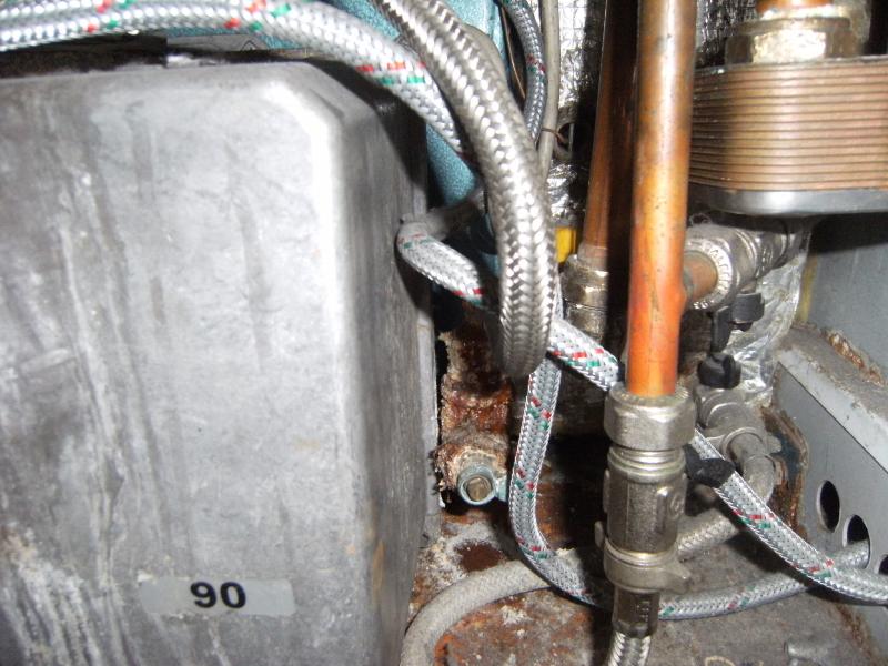

Great reply muggles thanks....the general level of installation work in the house wasn't good.....I've had a look at the valve and will try to get a decent pic. It's not in good shape even to my uneducated eye!

that very much looks like a leak from the expansion vessel hose on to the boiler.
This boiler looks like it has at least another 10 or 12 years life left in it.
We have loads of problems with the expansion vessels on oil boiler failing quite quickly.
This is part caused by the design and the proximity to the heat exchanger which gets just too hot for the expansion vessel and it perishes the diapragm.
I often leave the old vessel in situ and fit another on the heating circuit elswhere in the house. Normally solves the problem and they are cheaper.
Unless the main exchanger is leaking on your boiler i would get it repaired but get someone else in who is prepared to rather than the change bits

Cheers snb......I think there was a new vessel put in just two yeats ago.....and of course there have been the two PRV failures in quick succesion. I also think they were concerned about that valve at the base falling apart if they touched it due to the extent of the corrosion.
