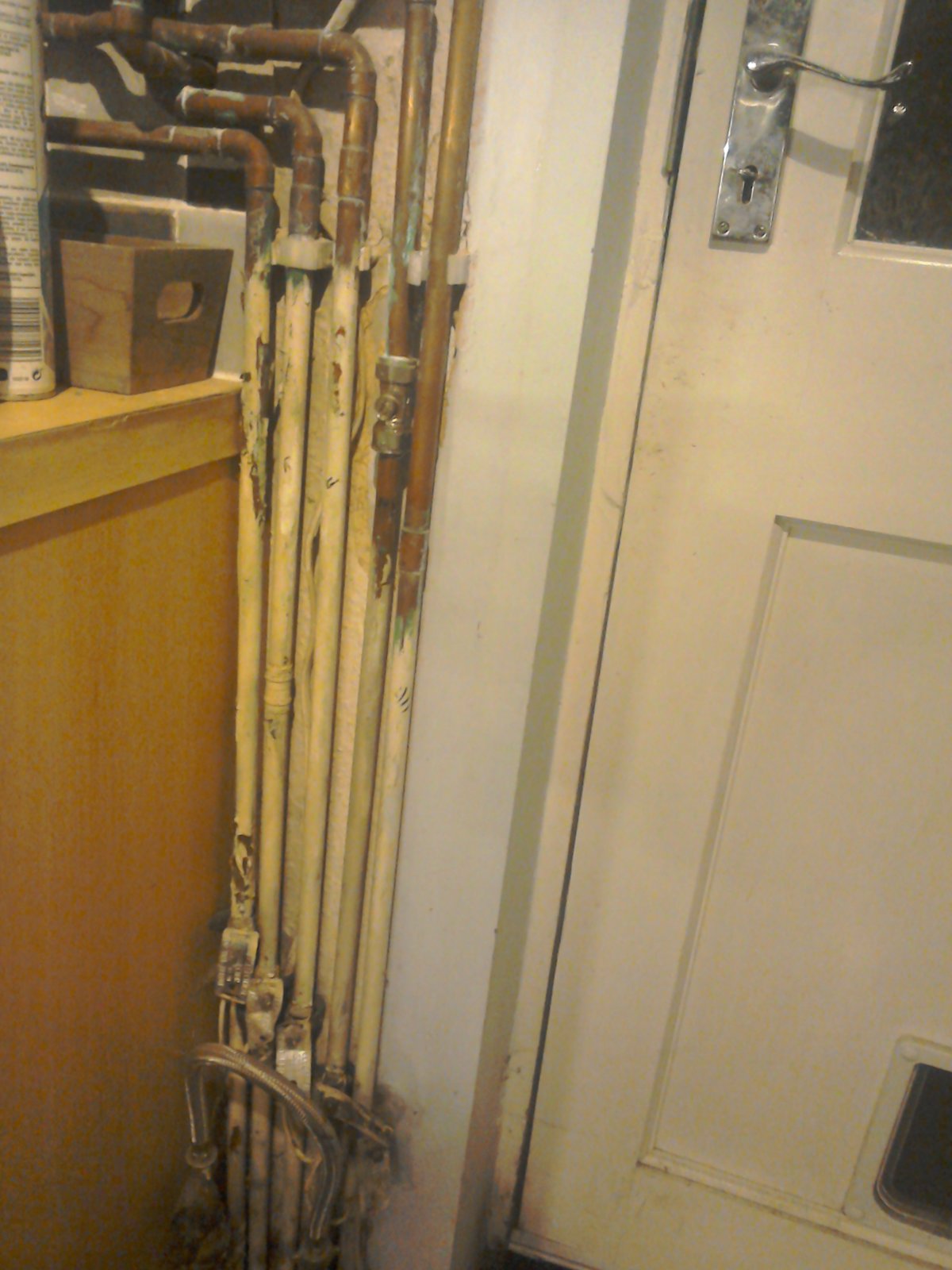

Hi, hope someone can help please.
I needed to change a bathroom tap washer so I turned the screw on the isolating valve which feeds the mains water into the Combi boiler.
I turned the screw 90 degrees but a fine spray of water came from the isolating screw (presumably as it couldn't cope with the man's pressure?).
I quickly turned the screw back, but now I can't stop a slow weep from the screw (one drop every 10 secs) no matter how careful I am turning the screw back to the correct position.
So I think my next option is to turn off the mains stop cock under the sink and replace the weeping valve/screw. Only trouble is I can't turn the stop cock as it seems to be seized.

You won't stop the valve leaking, it needs replacing. You could find your outdoor stopcock and see if you can turn that off, then take the opportunity to replace your indoor one with one that actually works

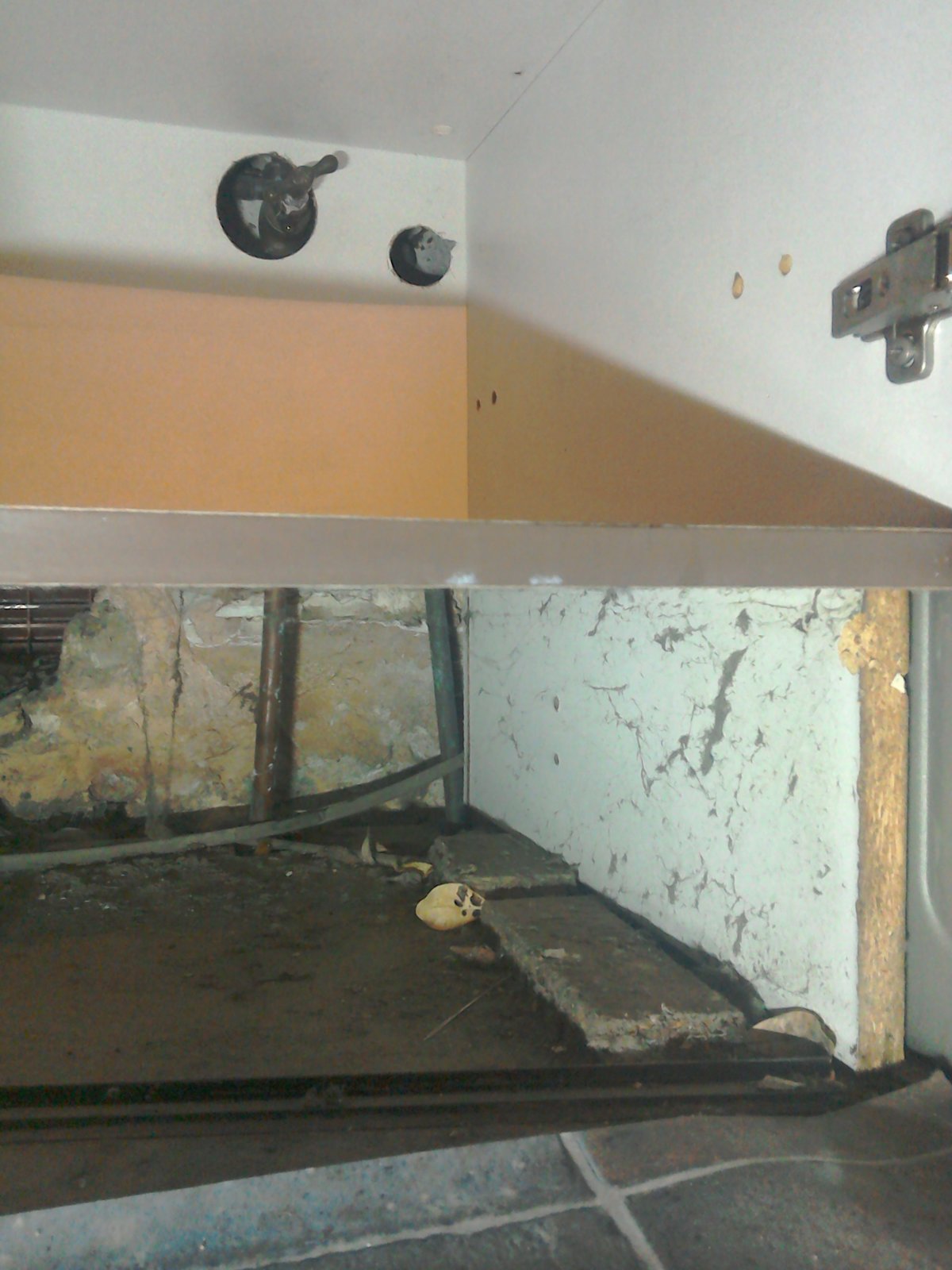

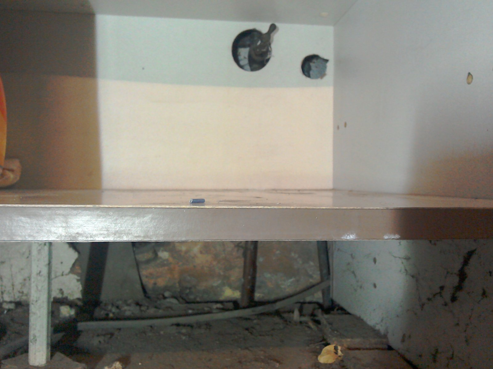

Attached is a photo from under the sink. Two pipes are visible in the lower half of the picture:
The one on the left I assume is the main stop cock (large tap handle in left side of upper half of picture)
The one on the right goes to the isolating valve (just visible in right hand access hole in upper half of picture) for the cold kitchen sink tap.
There is a further isolating valve higher up for the hot kitchen sink tap.
Is it possible there is another stop cock? I can't seem to find one.

Definitely a stopcock ,but can't be the main one if other outlets give water continually whilst it's closed.
Do you have a water meter ? Or trace the external stopcock to isolate water from coming into the property ,to enable you to swap the leaking isolation valve.
Thanks again for your advice.
Seems strange to me that there could be another stop cock as it is only a one-bedroom ground floor flat (converted victorian house). But as you say, as closing this stop cock off doesn't shut off the water in the bathroom, there must be another source.
I have seen the external stop cock out on the pavement but I think I will have to admit defeat and call in a plumber tomorrow.
