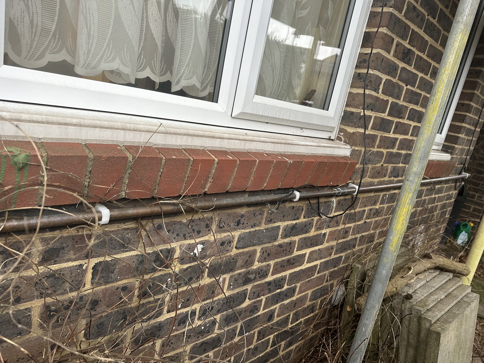

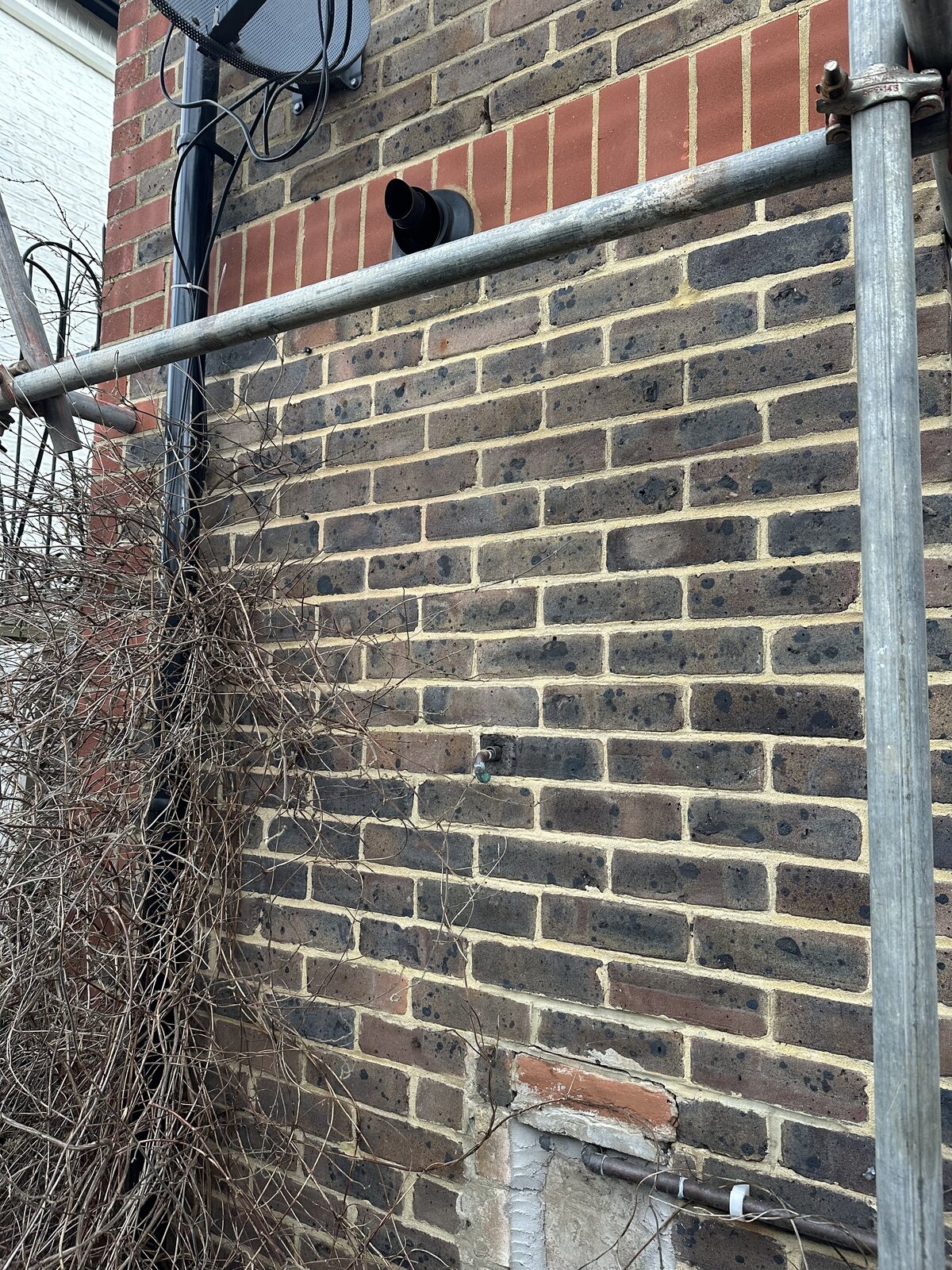

I’ve attached everything I could. The current boiler and its pressure, the piping under the boiler and the only pipe I could find outside the house. It feeds directly into the kitchen and (I’m assuming) the boiler. I couldn’t find any obvious signs of a leak! Apologies for the state of our front garden, we’ve got scaffolding up!
Look on the external wall that the boiler is mounted on.
The pipe in your pic is probably a gas line.
There’s a boiler flue but no other obvious pipes…is there a cause for concern or am I just being dim and missing it?!
Your being dim !! It's the little stub of pipe sticking out the wall a few feet below the flue !
Hahaha! I just assumed it was the leftovers of old pipe work. It isn’t currently dripping or leaking…however it does look fairly oxidised?
Tie a plastic bag around it ,to catch any water that comes out. If nothing appears after a few days ,the leak is elsewhere.

Genius. Will do that now and keep you updated. Thanks for your time and patience, by the way. It’s really appreciated.
