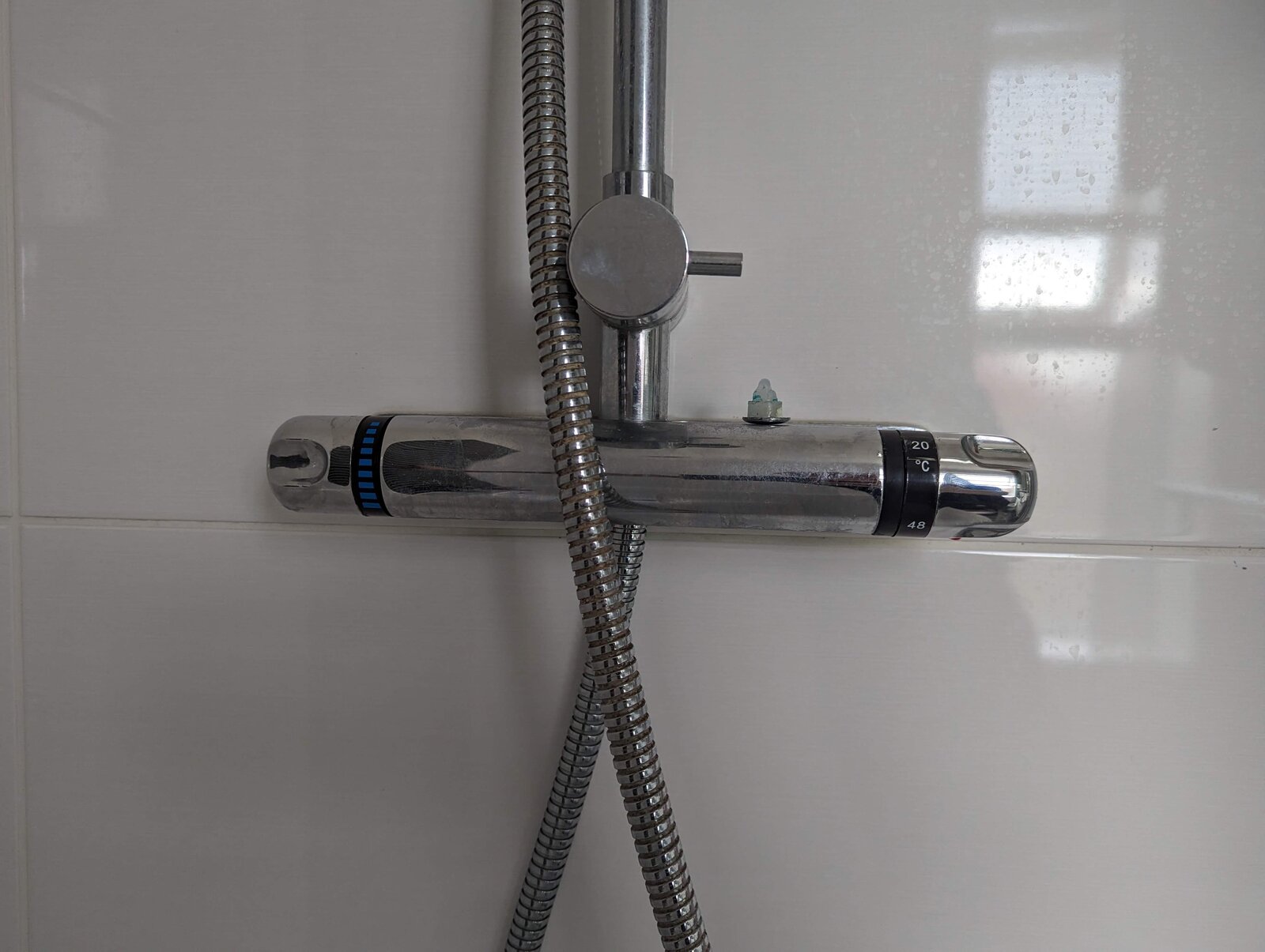

Hi, a heating engineer came to fix my combi, but ended up concluding that there’s a hot/cold water crossover caused by the thermostatic valve in my shower (he checked the tsps and mixers on all the other basins ).
However he ‘only does boilers’ so he didn’t want to touch the shower :rolleyes:
Can I just replace the valve on the right hand side to fix this? Is it as simple as turning off the water unscrewing and replacing ?
Many thanks

The nrvs are in the wall mount supply to the shower , you would need to take the shower off the wall and clean or replace .
Is it part of the mixer or could it be anywhere on the pipes leading in?
Its part of the mixer, if you undo the large nuts holding the shower to the wall the nrvs are in the "legs".
Thanks that's really helpful.
Just switch water off at the stop tap?
