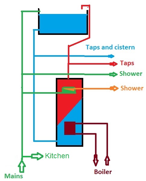

My choice was a heat only boiler and cylinder with a "shower coil"
Depends on what you want from the system
If your cold mains will be suitable, a combi will still struggle with more than one hot outlet open at a time unless the HW system is well tuned using water saving outlets etc. Gas will supply normally needs to be upgraded
Open vent gravity is a tried and tested system. You already know it needs pumped to increase the HW pressure. Your system can be updated to a modern HO boiler without issue as long as the current system is nice and clean. HW options are several, depending on your cold mains dynamic flow and pressure. Very DIY'able.
