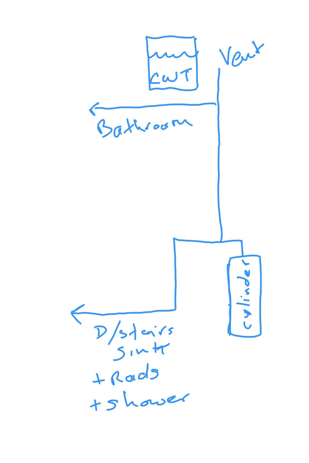

Can people please offer some advice on the following choice?
We are in the process of fixing our old central heating system which is open vented and has almost no hot water pressure upstairs (cylinder and boiler downstairs). Our plumber suggests sealing the system and installing a mega flow to run off our existing system (i think it called) boiler. Its a four bed house with wet underfloor heating (soon to be installed) in the kitchen / diner, an up and downstairs shower with a new electric shower upstairs. Our mains pressure is 6 bar.
Our alternative is installing a combi boiler (donated from family and less than 6 months old). Both plumber and builder think this is not the right choice but I do like the idea of instant hot water.
Are there any recommendations?

A sketch of the existing system would be useful.
I tried a sketch of the HW. The mains water is more of a puzzle, however we just installed a new mains feed from the stopcock and it'll be re-done: mains to water softener (and then to appliances and bathrooms etc.) and also mains to kitchen sink and outside tap. The flow is very good out if the new mains if that's what you meant .

Back to the OP, I support what others have said, that the dynamic water pressure is what matters. If your 6bar incoming pressure remains above 3bar when 12 litres/minute are being drawn then you will have good service from an unvented cylinder, Megaflo or otherwise. It would be wise to upgrade the cold water service pipework to 22mm all the way to the UV cylinder, and to feed all the previously tank fed cold taps and showers from the regulator (pressure reducing set) for the UVC. This means the hot and cold pressures will be balanced (better for showers). For this reason it may be advantageous to site the UVC either in the loft or in the airing cupboard.
Give careful consideration to locating the cylinder as close as possible to the main hot water point of use, to reduce the wait until hot water flows, and to save heat energy (reduce the cost of use).
A combi can be used for your heat source. Just about all modern combis are of the sealed system type, so have a pump and expansion vessel built-in, though you will very likely need to fit a supplementary external expansion vessel. The only change when using a combi as a system boiler is that a single hot water outlet (basin, utility room sink, etc.) should be fed from the combi's DHW outlet. In your case feed its cold inlet from the pressure regulator as above, because 6bar is too high for most combis.
