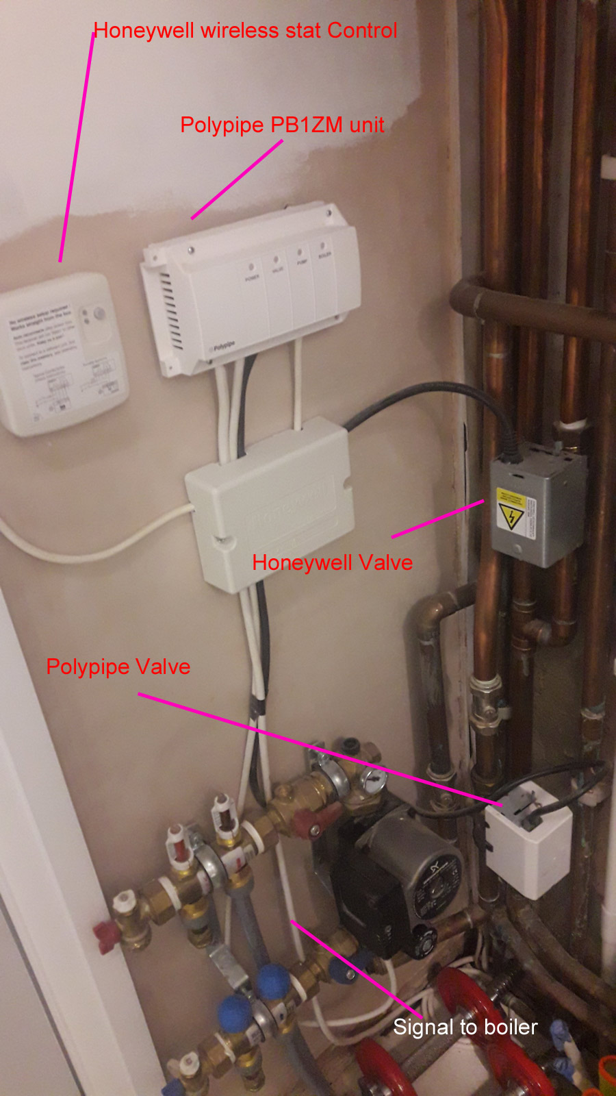

This issue dates back to our extension and cowboy-ish builder.
In short, they made a monkey out of the polypipe UFH kit. Pump was missing, stat was a timer, and plumping was incomplete etc. We were nearly left with a non-operational heating when he finally got a 3rd party heating engineer to rewire things and fit a thermostat.
Although we got an operational system, instead of a 2-zone split between heating/UFH we have 1-zone control, heating both the house rads and wet UFH screed.
System:
They wired the honeywell valve (ad-hoc) to open at the same time as the polypipe valve, so all UFH/rads run together. The plumbing/valves are in place for this to split easily. I will post another pic with the wiring L/N/E/L1 in view.
I want to fit another (wired) stat in the kitchen for independently controlling the UFH and let it run much longer as required to maintain screed temperature correctly.
How should I go about this?
The master unit is 1-zone, my understanding is that I need to replace with 2-zone so that it can take in 2 stats and control 2-valves separately, while boiler takes signal from the unit.
Alternatively, could I not just rewire one valve to signal from the new stat? both stats would need to signal into the 1-zone unit, so if one stat is on at any time the boiler keeps running. Not 100% this will work...
