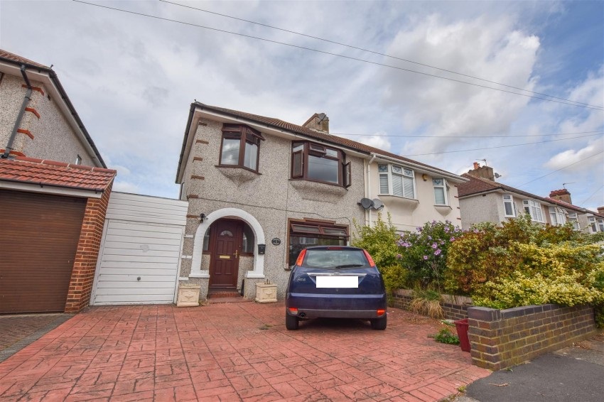

I am looking at a couple of options in terms of putting in a planning application. The list of the works that I am hoping to do are as follows.
Hip to gable extension
3m single story extension
Building a porch at the front of the house
Now, there is also a garage as well, I plan to convert the garage to habitable living space and also incorporate a porch. I understand that this has to go to full planning.

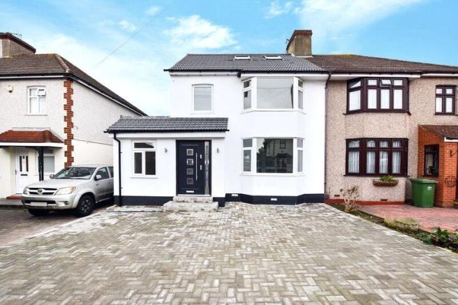

The porch would need p.p. if on the front and > 3 sq m. Putting a window in the garage instead of the door would not need p.p., even though it changes the appearance. If you put some sort of canopy over it, continuous with the porch roof, then that would need p.p.
Thanks for the reply, the attached picture is what i want to end up with.
In this picture the porch is more than 3sqm, If i kept it within 3sqm is it just a lawful development certificate that would be needed ?
