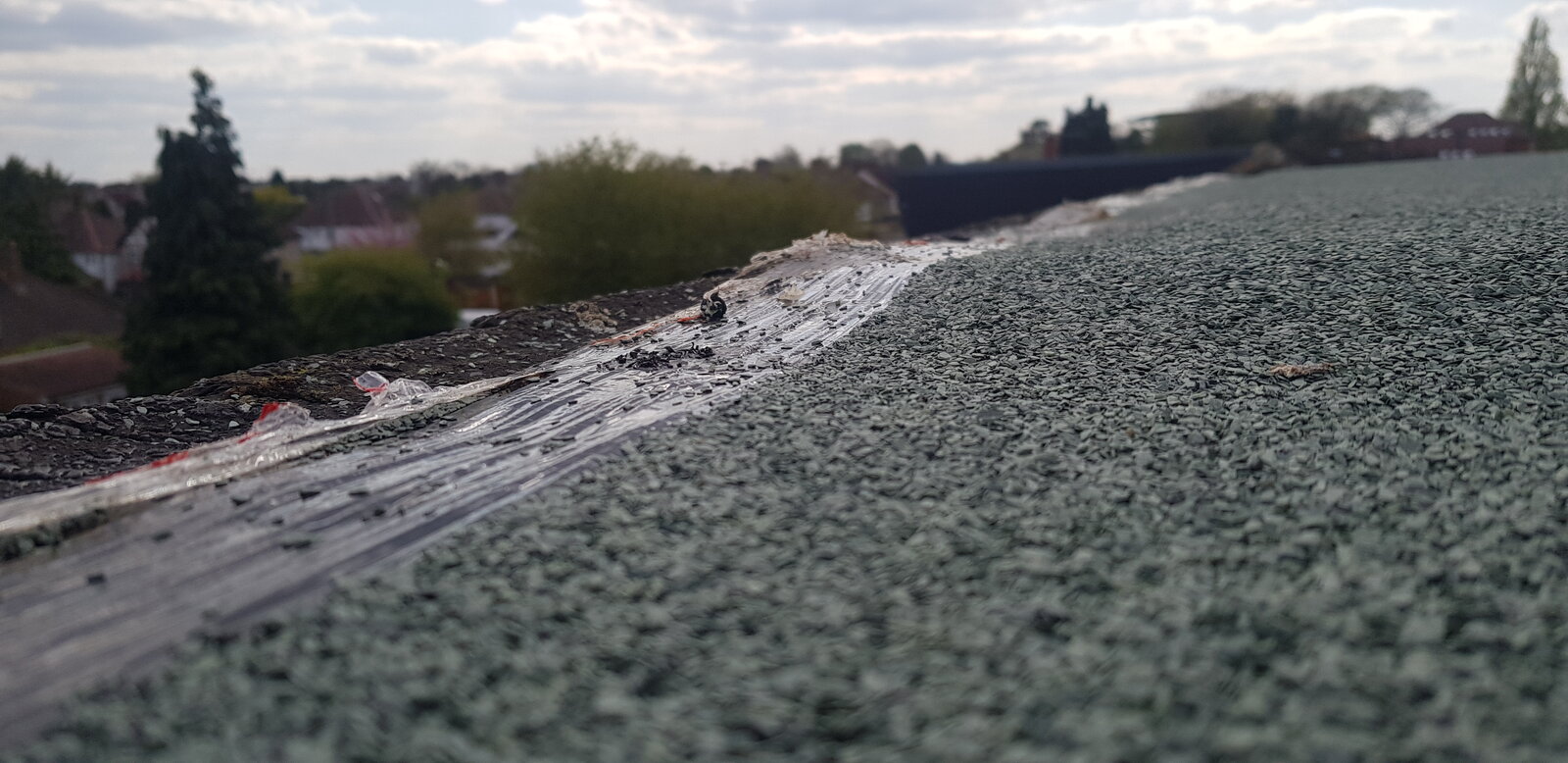

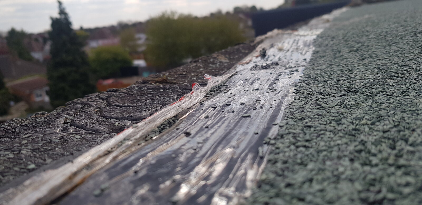

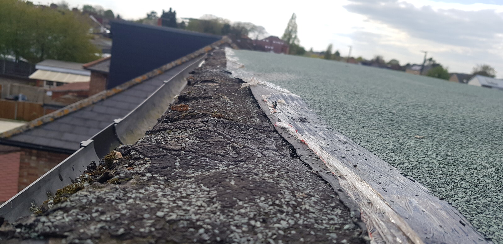

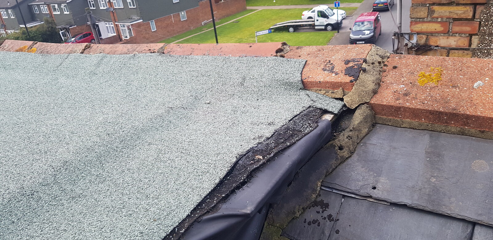

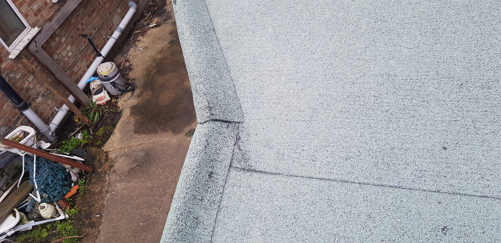

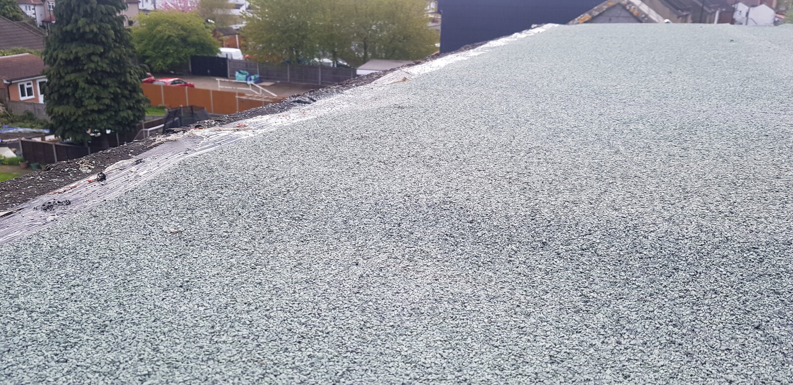

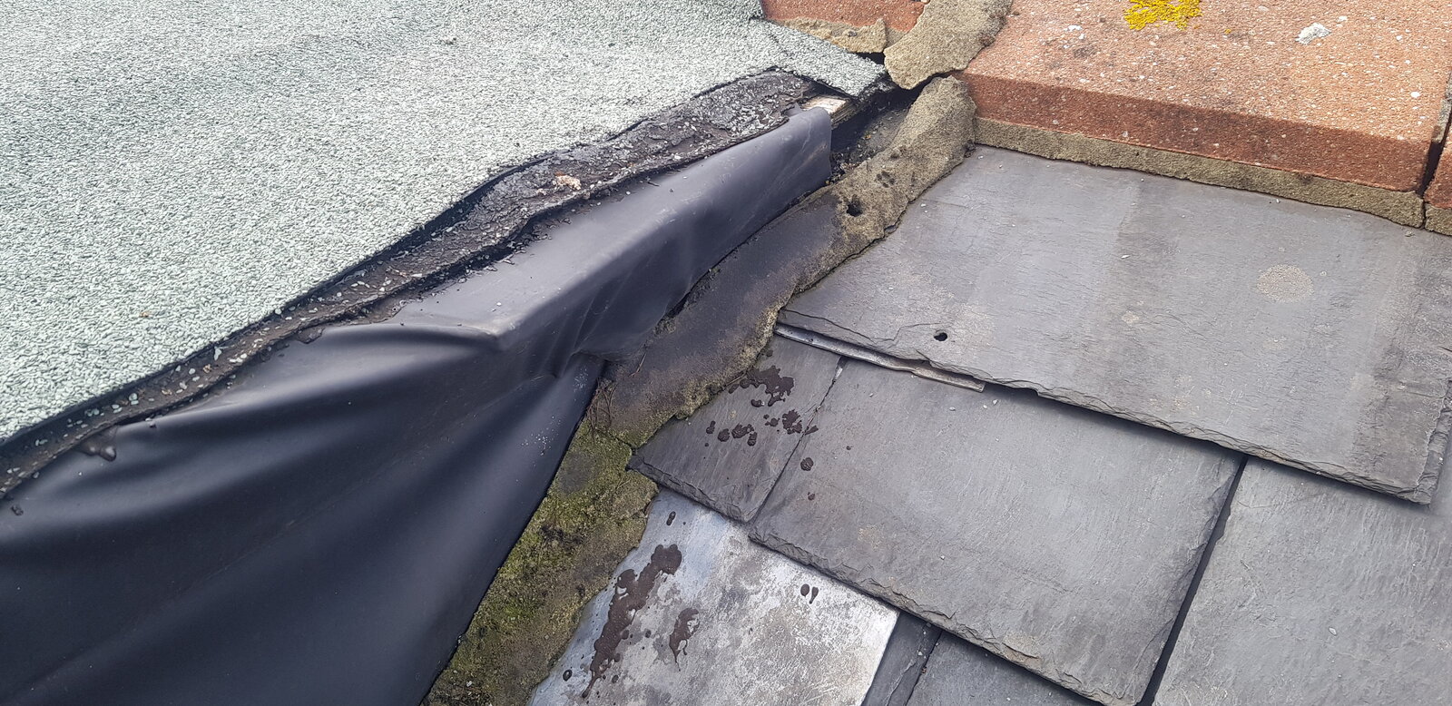

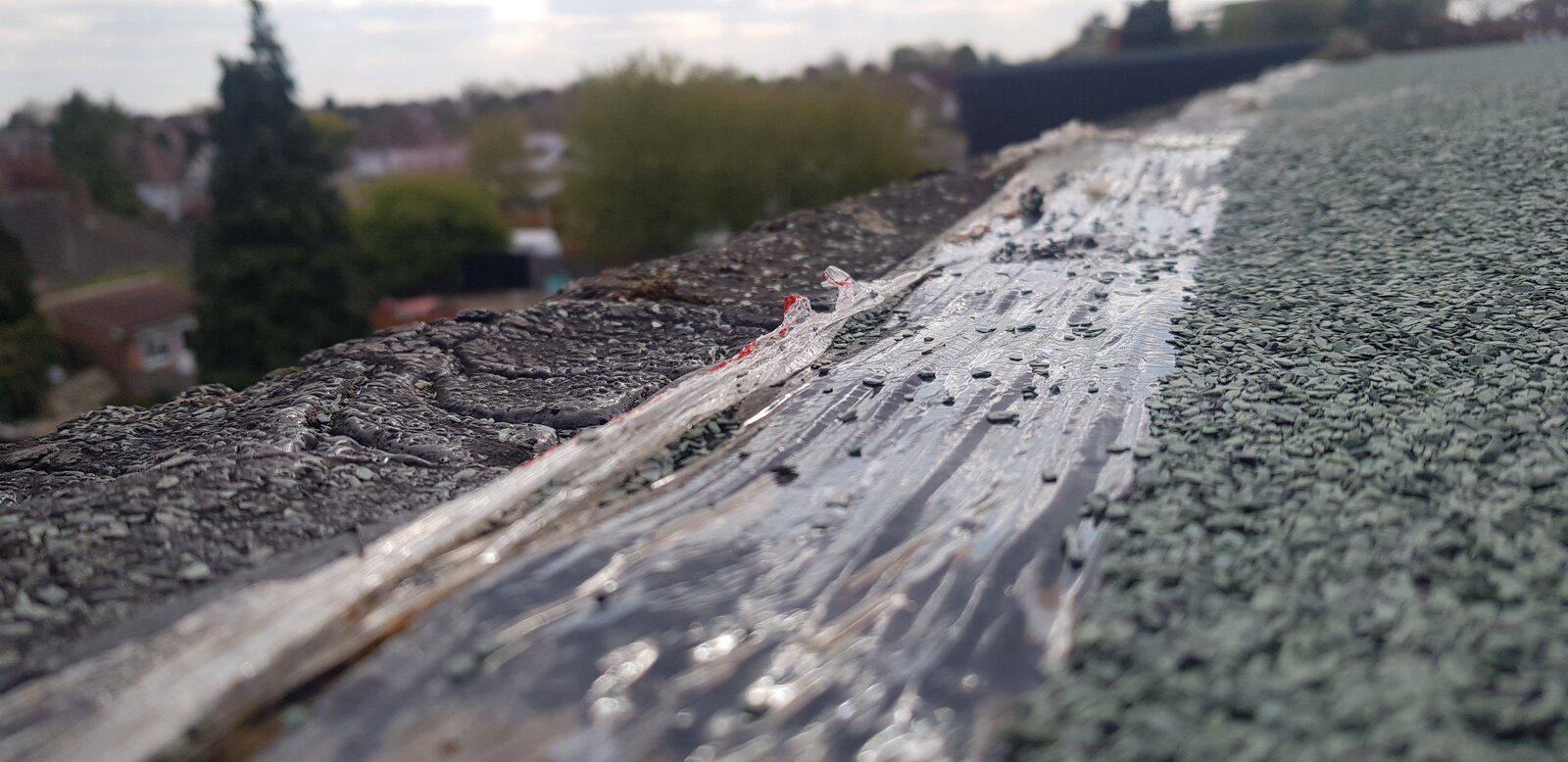

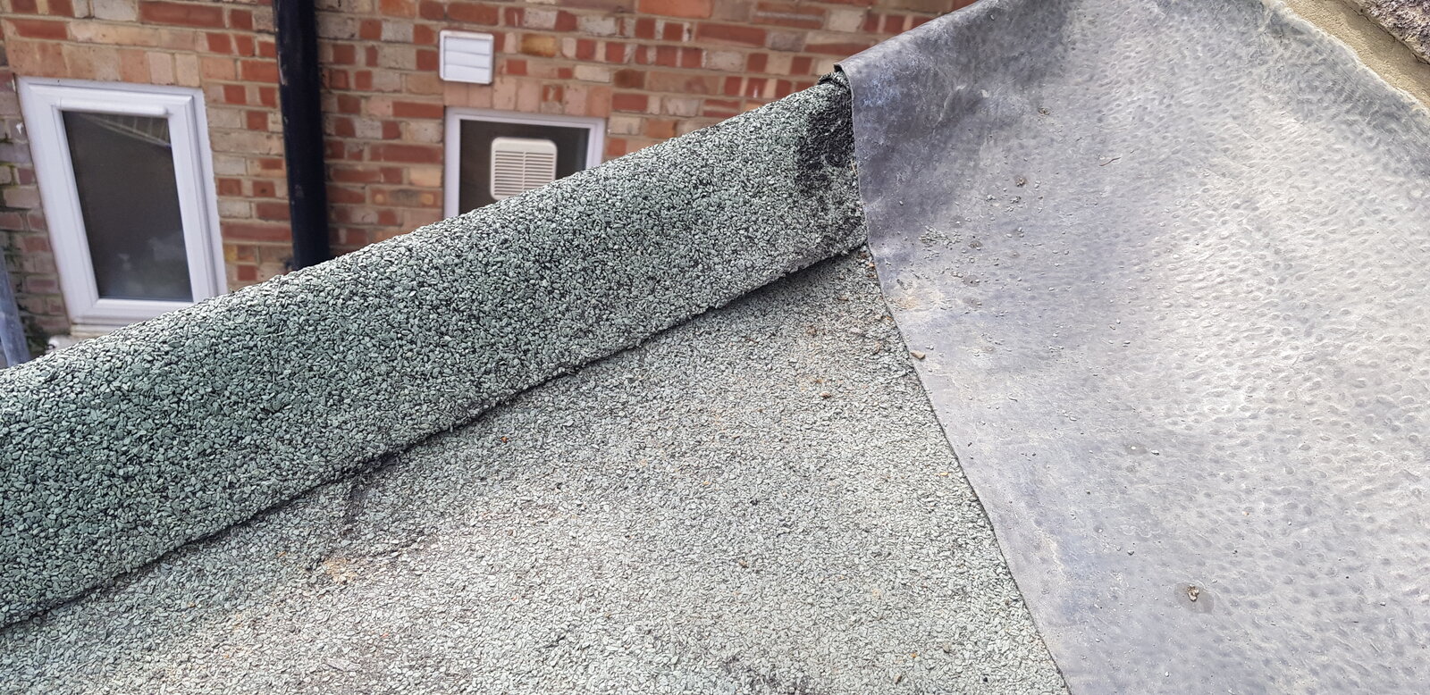

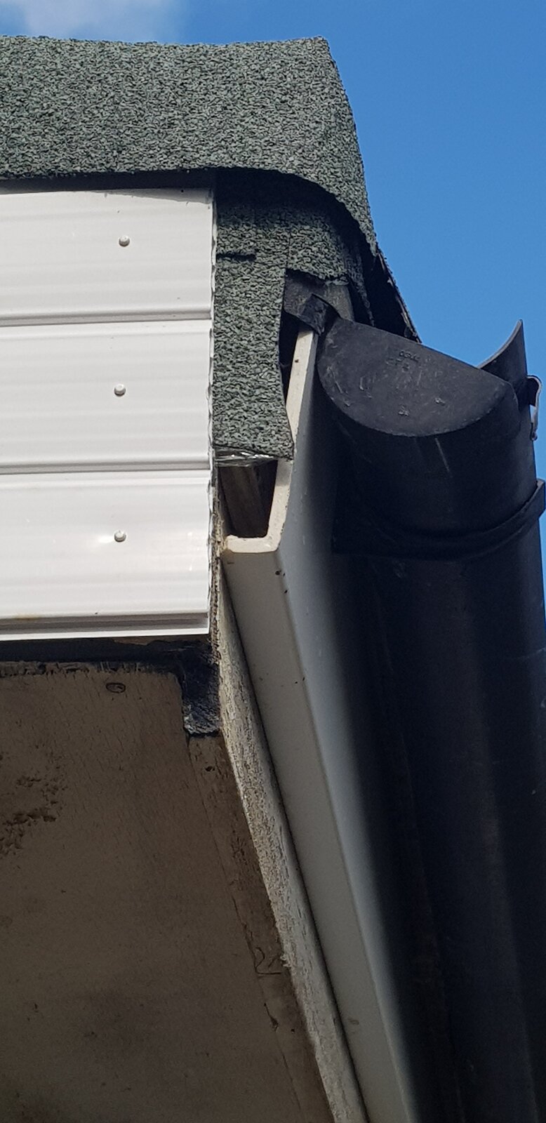

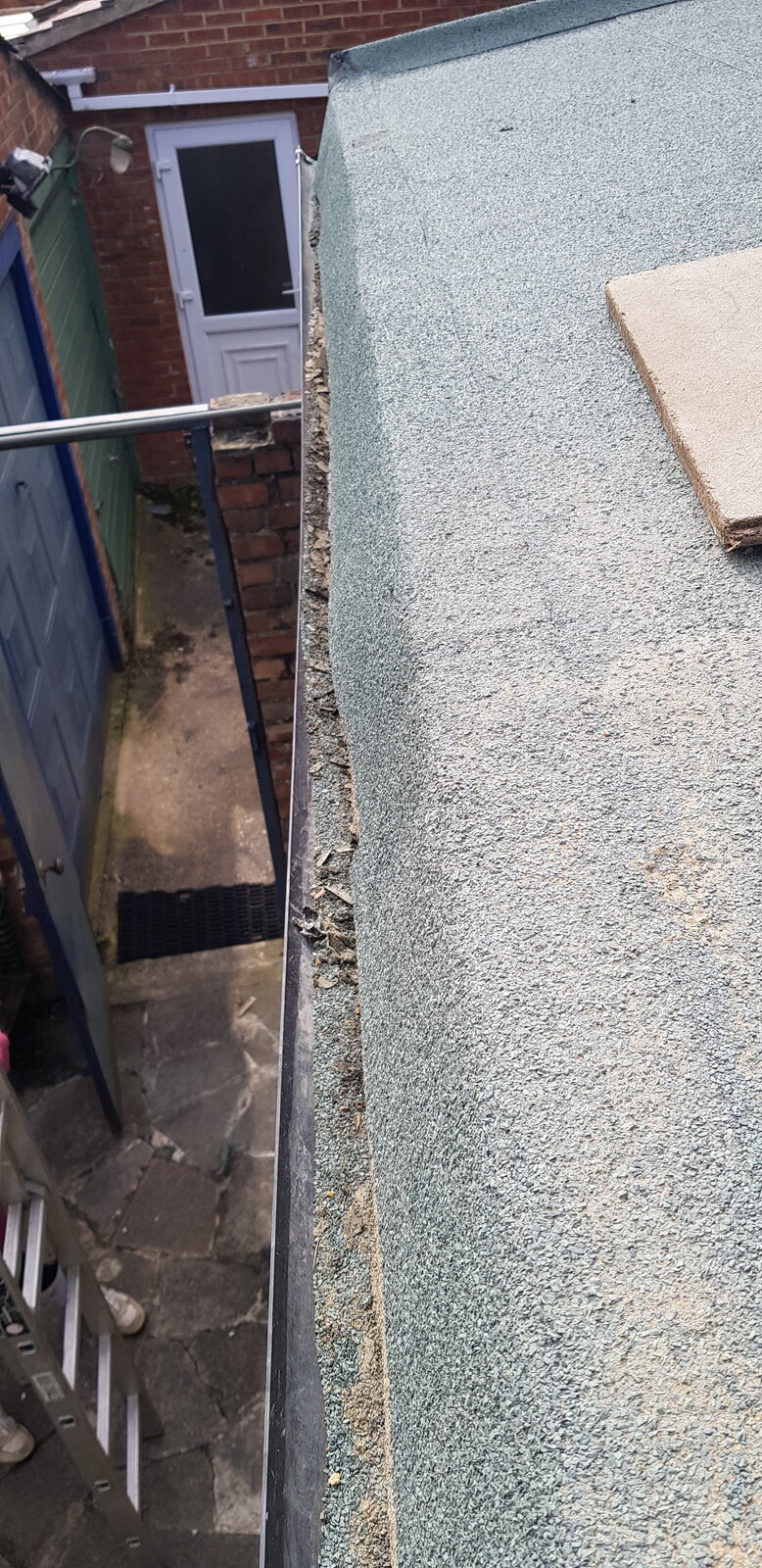

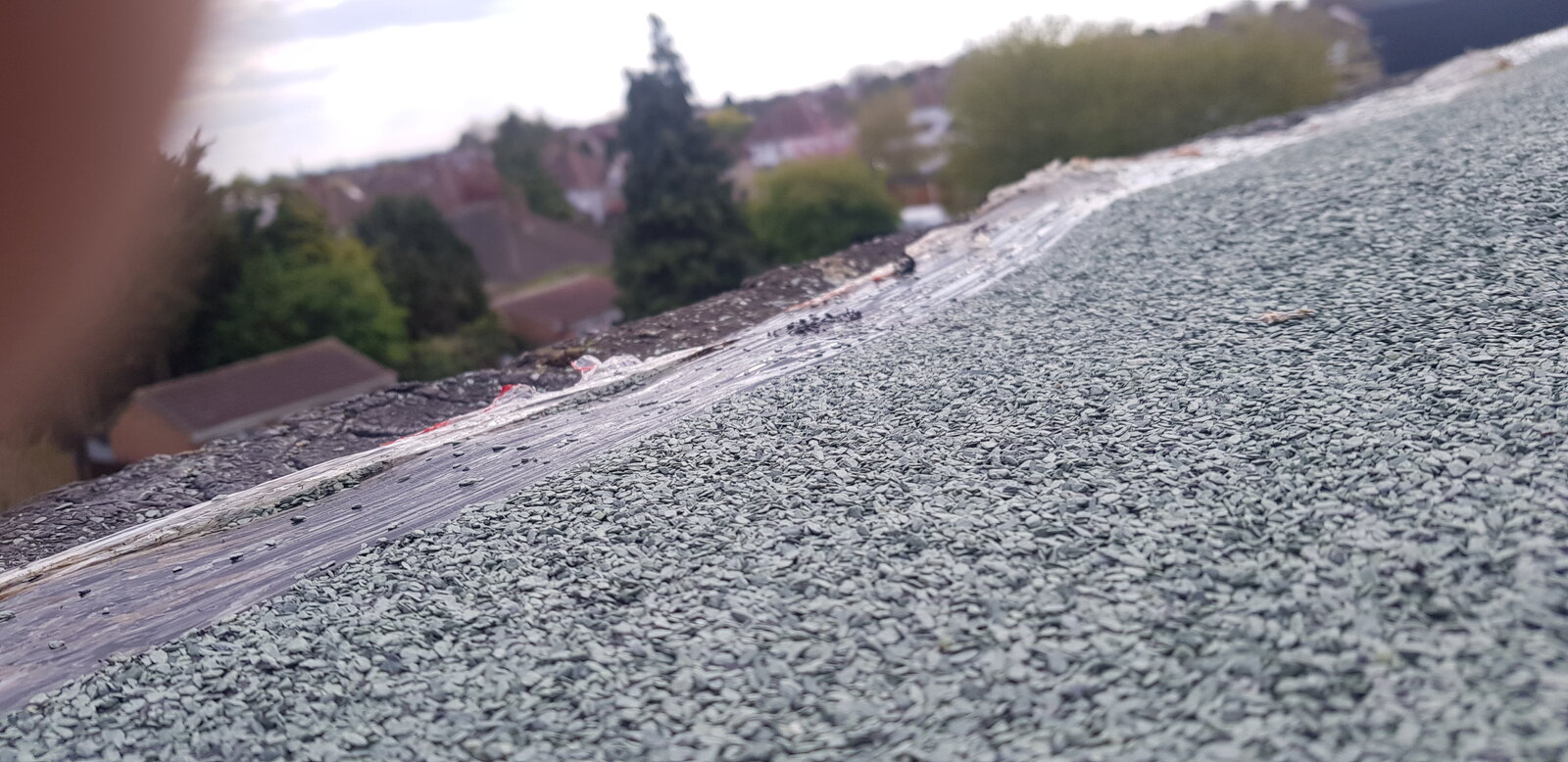

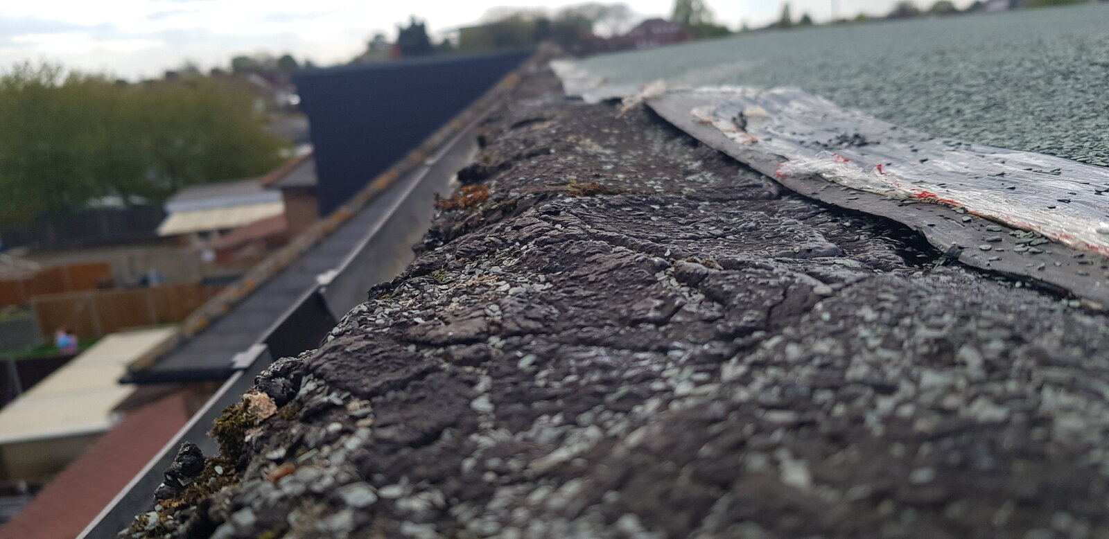

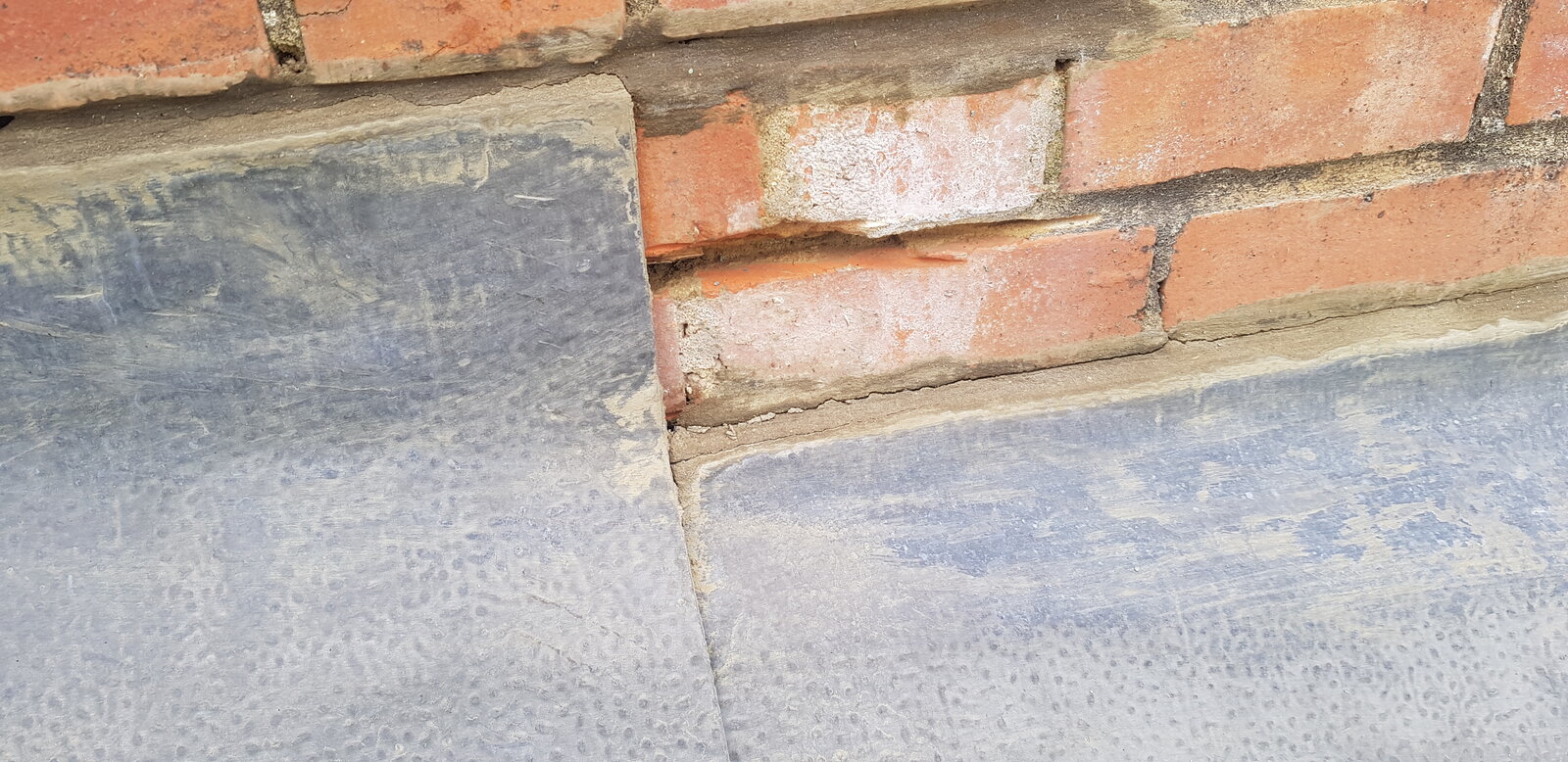

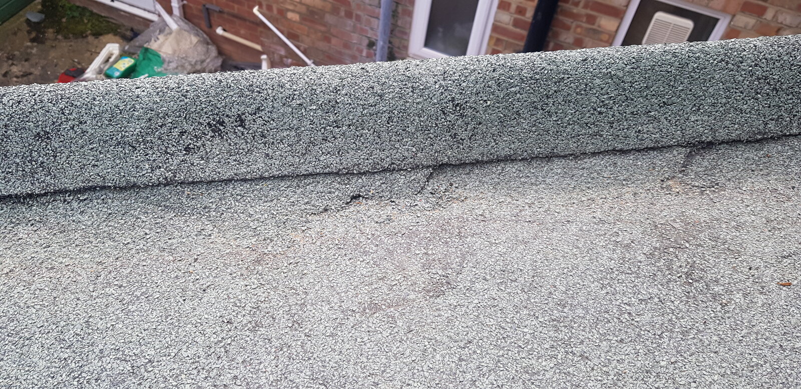

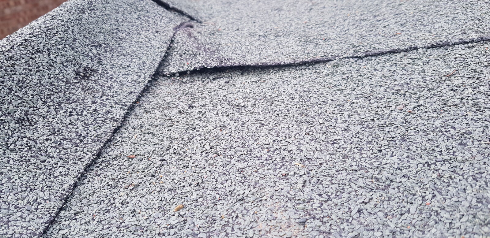

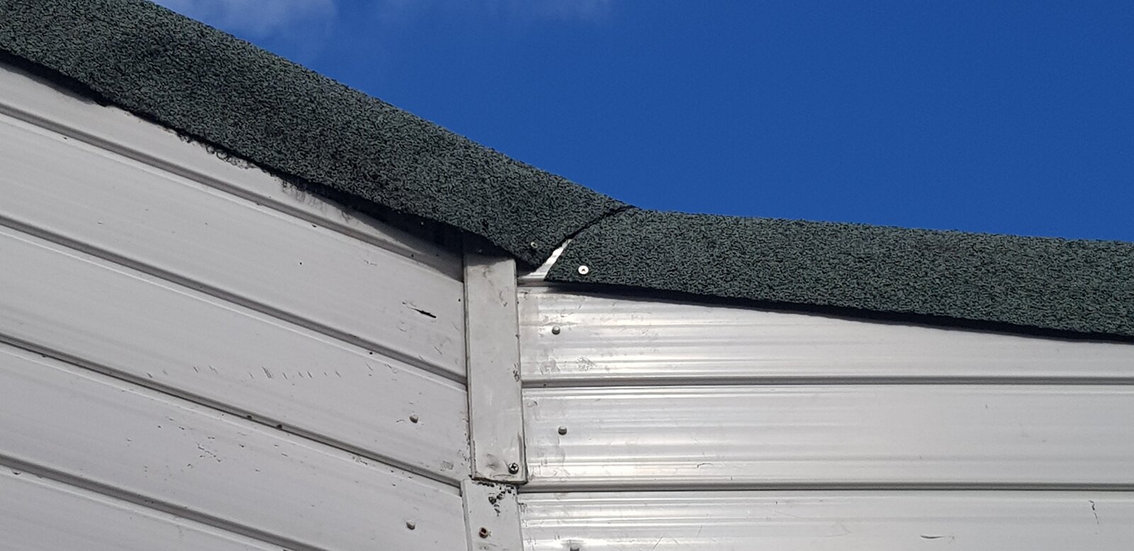

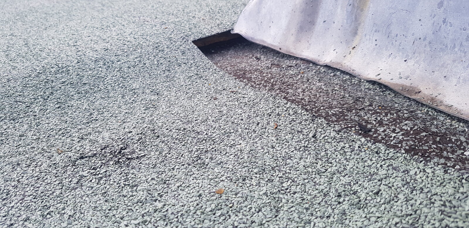

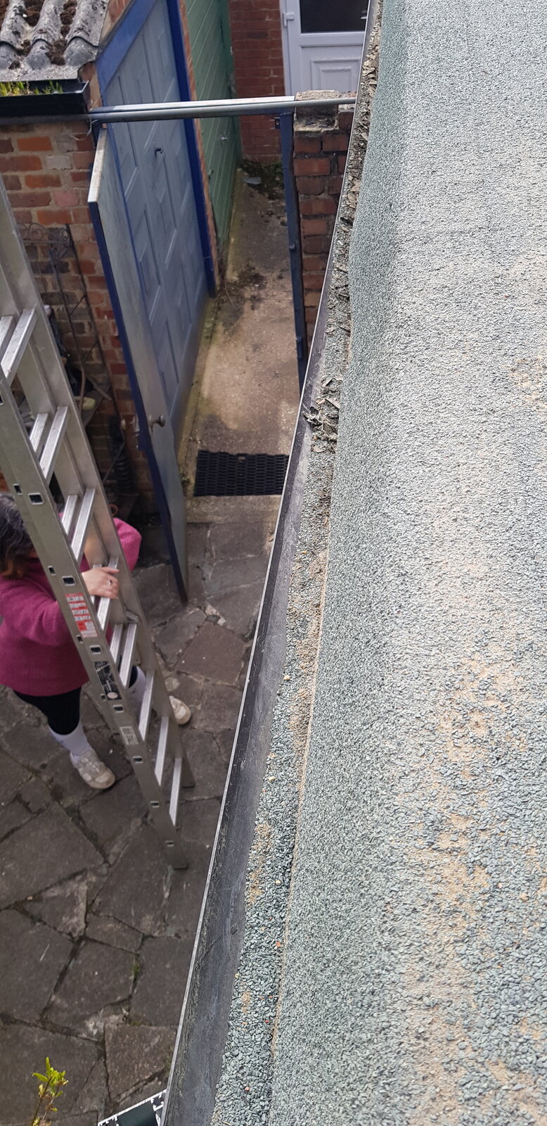

My friend called me in tears because she had 2 flat roofs reboarded and refelted and as soon as they finished they both leaked.
I went there today and took some pictures.
Any comment welcome.
I am not a roofer but I'm sure these guys aren't either...

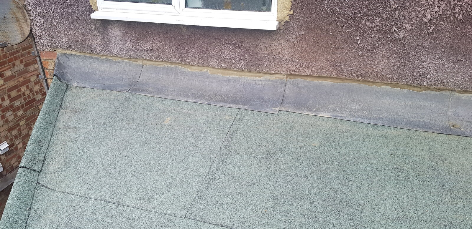

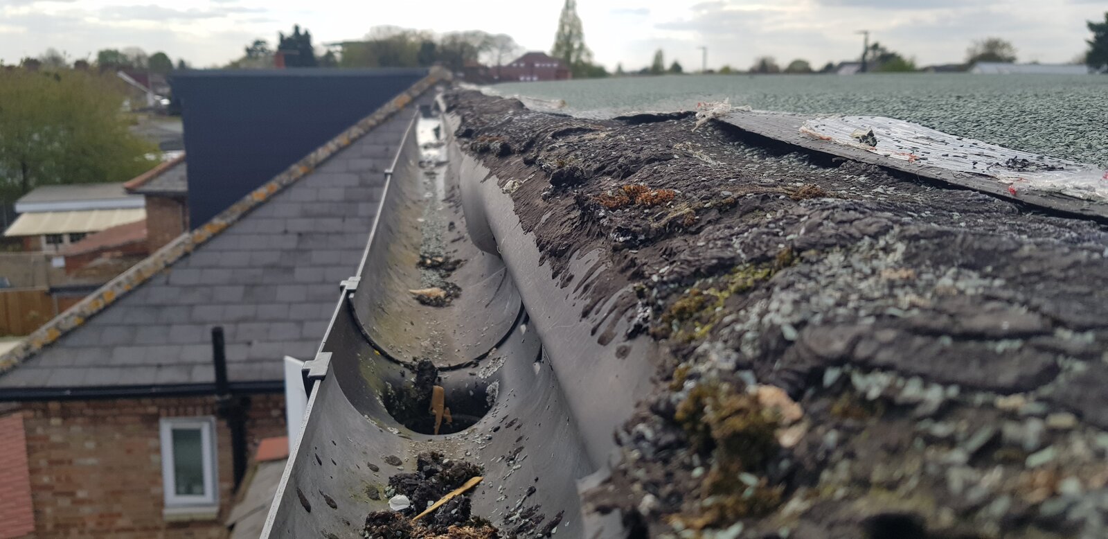

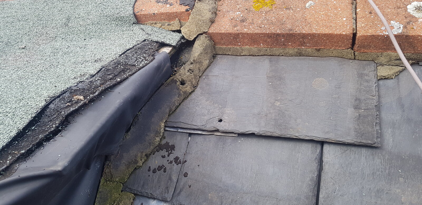

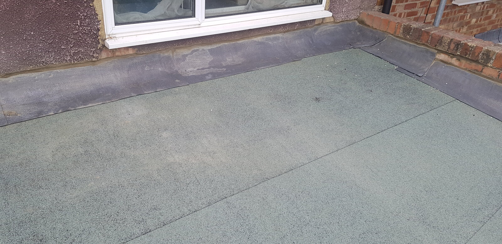

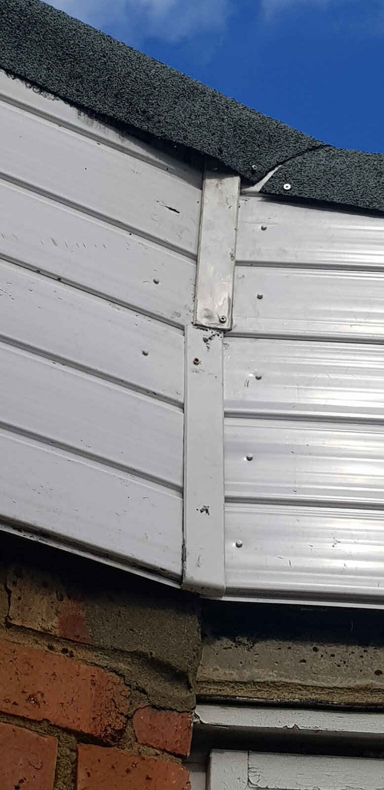

One thing's for sure, the resultant work is totally sh1te.
The felting and leadwork speaks for itself and hollow soffit has be used (and fitted) incorrectly for vertical fascia/cladding.
It's not just poor quality, but it is actually incompetent/fraudulent, and if she gets no luck from the roofing firm, then its one for the council's consumer protection/trading standards to get involved with.

Today she had 2 real roofers around to quote for repair and both said that the first roof needs 2 more layers of felt (the cowboy only laid one).
The second roof needs stripping to the rafters because the bodger has simply thrown some felt on it hoping to get paid before it rained.

The work has to be ripped off and started again.

Well you have had the advice. The guy is a fraudster and should be reported. It's not likely that your friend will get her 4 grand back but she certainly wont unless you go down official routes, such as they are. The whole lot needs taking back to the roof and if that is rotten due to leaks then that will have to be replaced along with the felting and a complete job done.
