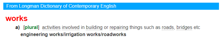

However, I'm not entirely sure what "Minor Electrical Installation Works" means nor if it makes sense.
Is just one job MEIWork and more than one MEIWs?
I have done two electrical works today ??? Perhaps if you had written two plays - Two works of Shakespeare.
Isn't a "works" a factory or something similar - or a third person singular verb?
Is there perhaps a missing apostrophe? No, it's not an "Electrical Installation's Certificate.
... However, I'm not entirely sure what "Minor Electrical Installation Works" means nor if it makes sense. .... I have done two electrical works today ??? Perhaps if you had written two plays - Two works of Shakespeare. ... Isn't a "works" a factory or something similar - or a third person singular verb?
Indeed but, at least in the minds of some 'authorities', there is another meaning (we are, after all, all fairly comfortable with "road works" etc.) ...
