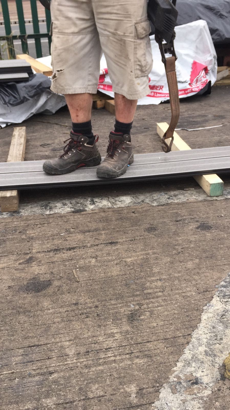

I have a balcony that is in the process of been replaced.
I have planned to put composite decking down to try and reduce maintenance.
My problem is: I have 5 support beams protruding from my house, they are each just short of being 1 metre apart. with the total distance being 4.8 metres.
I am therefore looking for composite decking that can straddle the ~1 metre span without sag and ideally have no joints.

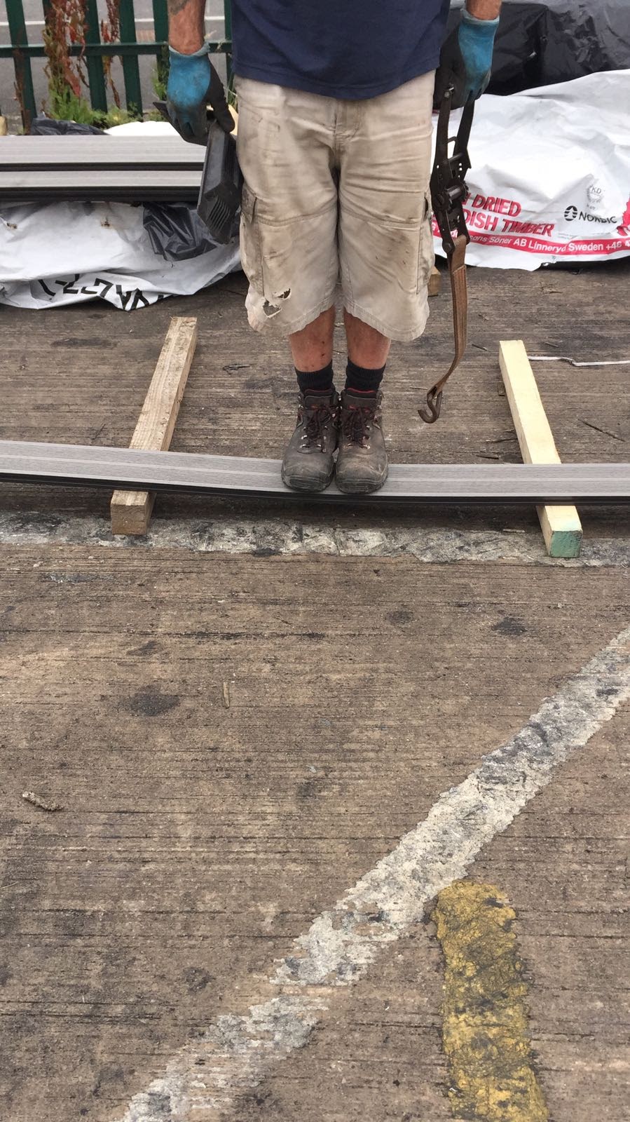

I have tested this at a local building supply and their 25mm thick hollow section sags a lot (see pic).

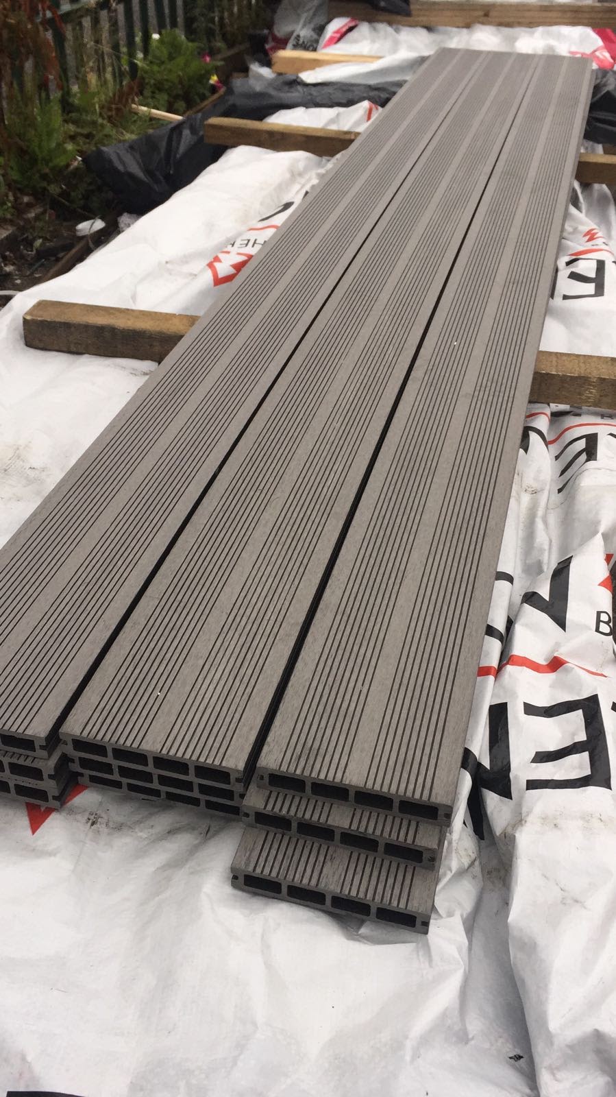

I have since sourced 30mm hollow section but doesn't come in 4.8metre lengths.
Does anyone know if 4.8metre x 30mm or thicker lengths exist?

You could add extra timber in between existing to reduce span or overboard with ply, then you can use any thickness of board on top .
