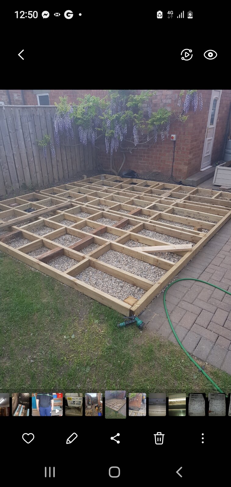

Hi I'm looking to put some composite decking down and was wondering if any installers on here can recommmed any do/donts on what type/brand to use.
The decking will be going down on a timber frame (pic attached)
Pic attached

My experience of decking is largely limited to the stuff we used at home.
We had a (pretty expensive) solid core decking.
It has a slot to accept the fittings that hold it down.
Shortly after fitting it (we went for a red brown, cedar type finish), I noticed that it had developed a very, very slightly mottled finish- not a biggie.
The stuff is really hard to cut though. I purchased a chop saw capable of cutting up to 315mm for the diagonal cuts on the outer (single groove) strips. The stuff has so much resin in it that it punishes the blade.
The decking won't rot, but at the end of lengths, I have noticed that it can warp upwards- the single fitting screw in to the softwood timber frame that holds down both boards simultaneously doesn't cut the mustard in softwood timber over the years. BTW the screws are semi proprietary (square head) . They provide a square head screwdriver bit. I guess that I need to replace them with longer screws of a similar diameter, but that is pretty low on my "must do radar".
As I said my experience is limited.
I have a customer in Barnes that has a (reinforced) hollow core decking. It is in front of the entry to their "summer house". I has splits along the length of it. The lengths are only about 2m and to be fair, there has been a transition of mud under it over the last few years.
I cannot ever see my Trex splitting, but composite is not as hassle free as the manufacturers would have you believe.
Sorry, that probably isn't what you want to read, but my lay advice is to find a brand and then drill down on reviews for the product.
