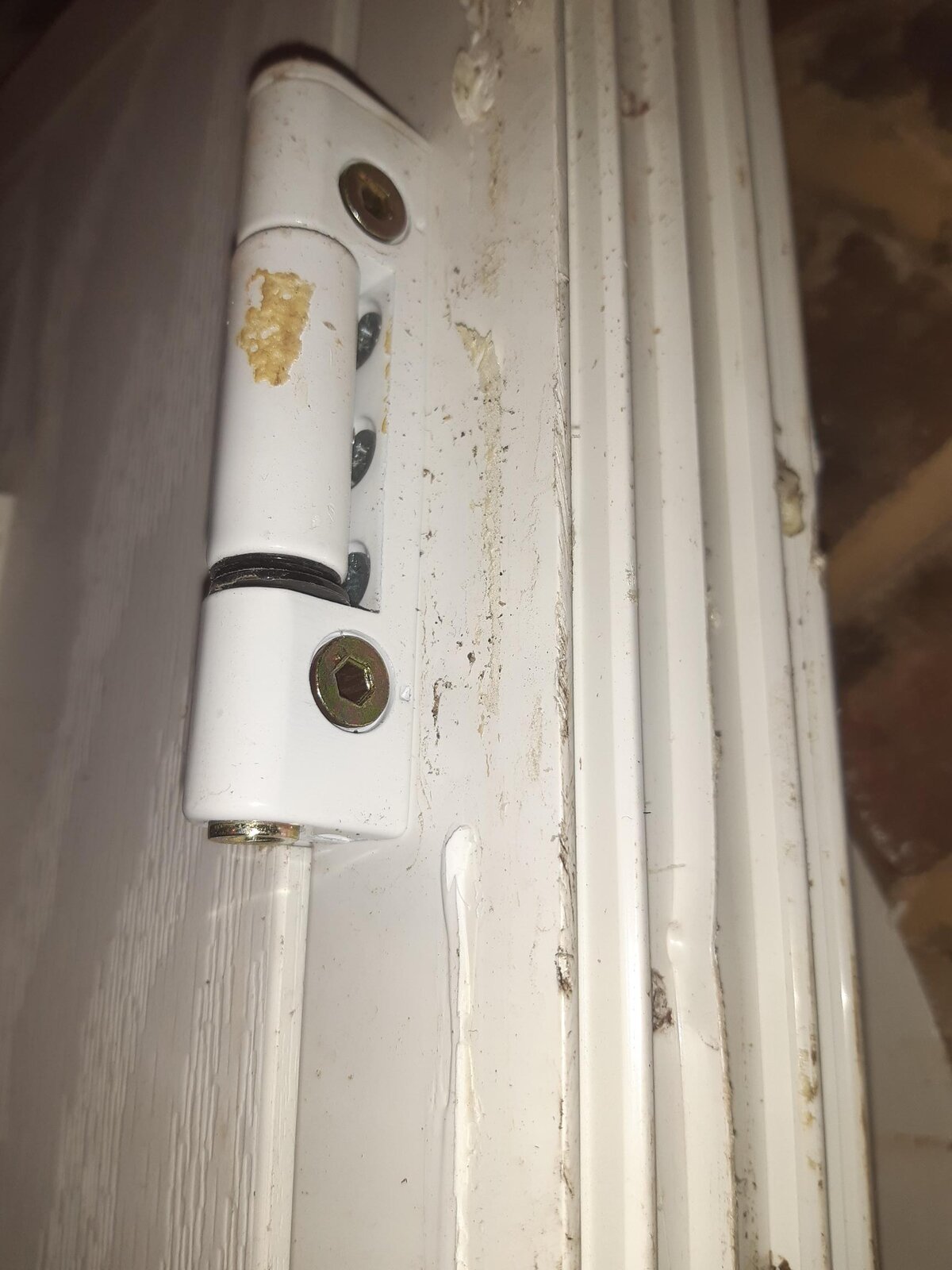

I've just bought a second-hand composite door which has dropped on one side (catching at the bottom).
I've had an initial play with the hex screws and think I understand what does what. The door margins vertically are not too far off but I can't seem to be able to raise the door on the non-hinged side sufficiently to stop it rubbing (I can lift the door on the hinged side so that it almost touches the top of the frame). My thoughts are that either the frame itself is not true or I need to try and push the door out at the bottom to lift it which will then put the vertical alignment out.

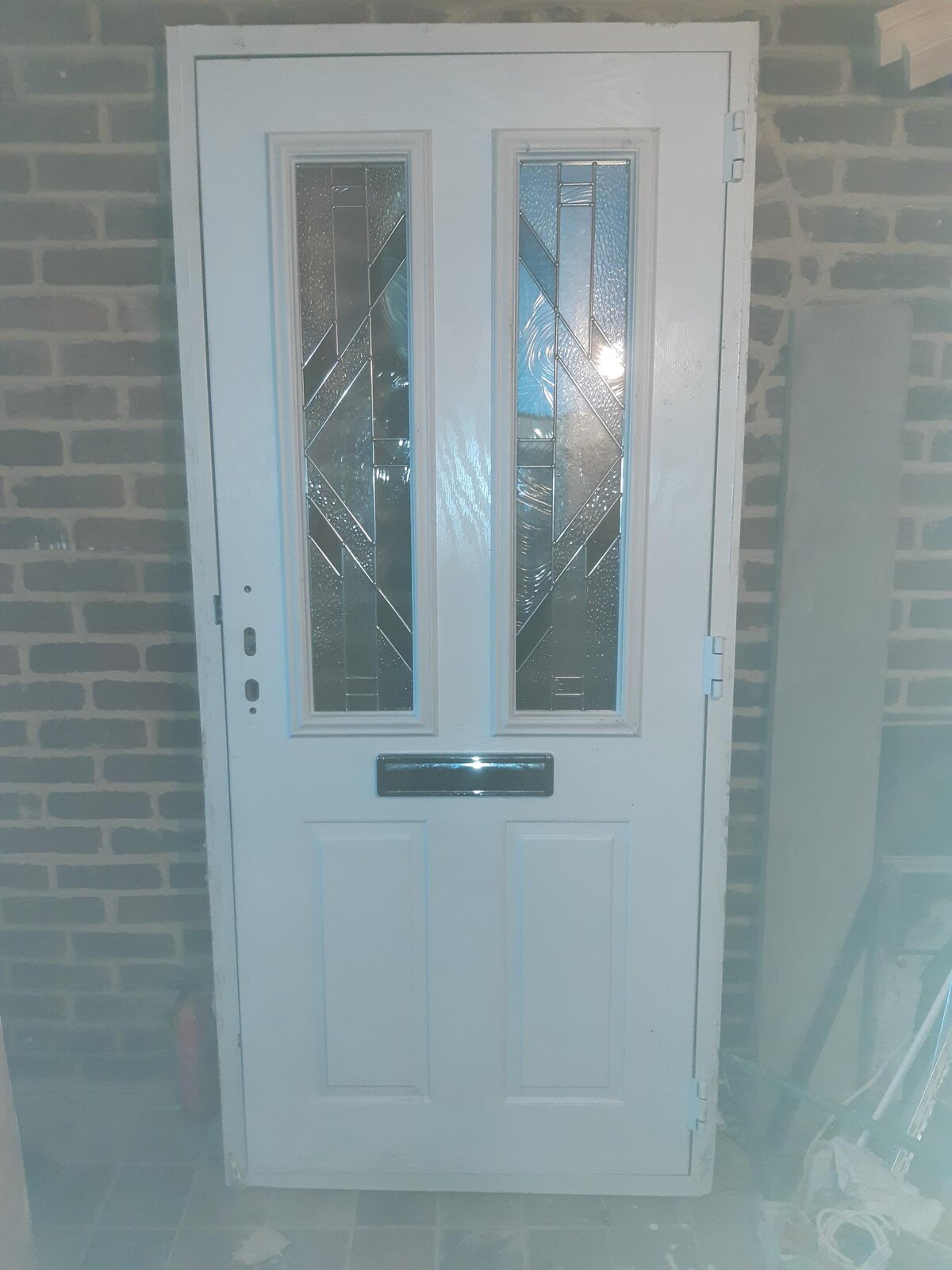

I've attached some photos - apologies that the quality is not brilliant.
Any ideas?

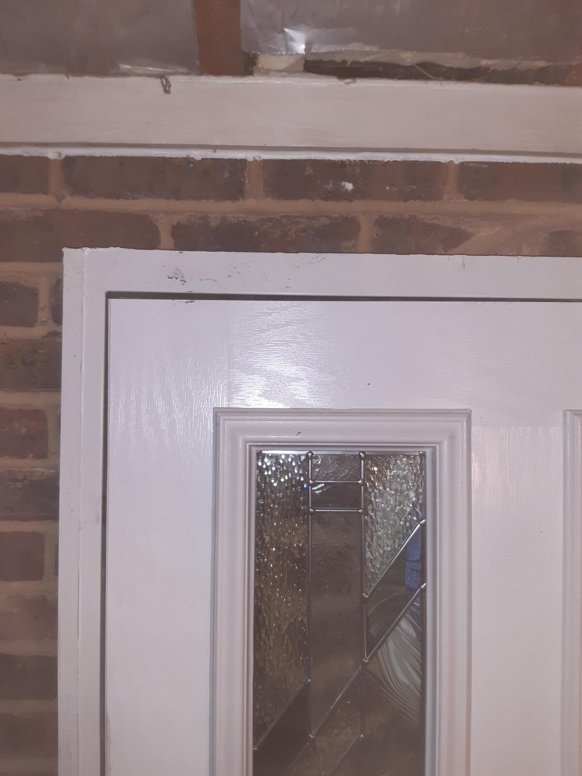

As the gap on the hinge side looks even it seems probable that the frame is not square. Do you have a large square to check it? Alternatively measure the frame diagonals to see if they are equal. It appears to me that the bottom of the frame needs lifting on the hinge side to allow the frame to drop on the lock side.

I had a quick check with a large square and I think the top is slightly out. I realise now that I should have checked all four corners (I just did the non-hinge side) plus measure the diagonals - I'll try and do this tomorrow.

The door itself will be square so just pack the frame to suit the door and get the gaps equal , shouldn't need to do any diagonal measurements

You need to pack under the frame on hinge side to lift the door OR pack the locking side down. But it's not installed yet anyway so the frame is all over the place right now
