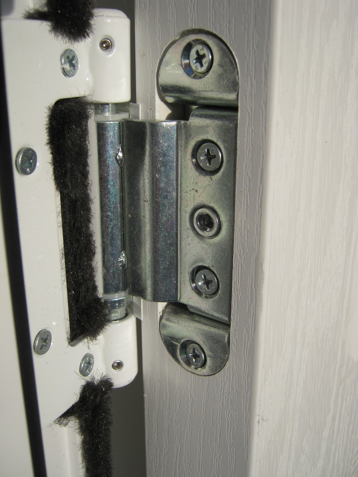

Hi,
I wonder if anyone can identify these composite door hinges? more specifically I am looking for guidance on how to adjust them.
Dynamic 2D
Open the door 90°, tighten that allen screw on the bottom cylindrical part of the hinge,
  • for lateral adjustment loosen the two middle screws on the frame part of the hinge and then adjust using the centre allen screw.
  • for height, pop the cap at the bottom of the cylindrical section and insert an allen key.
