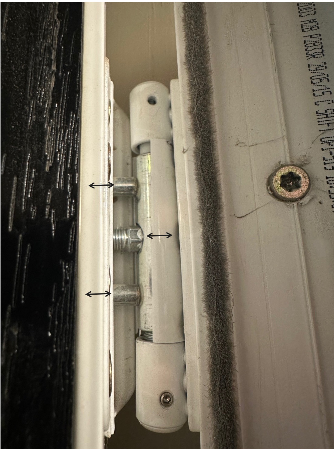

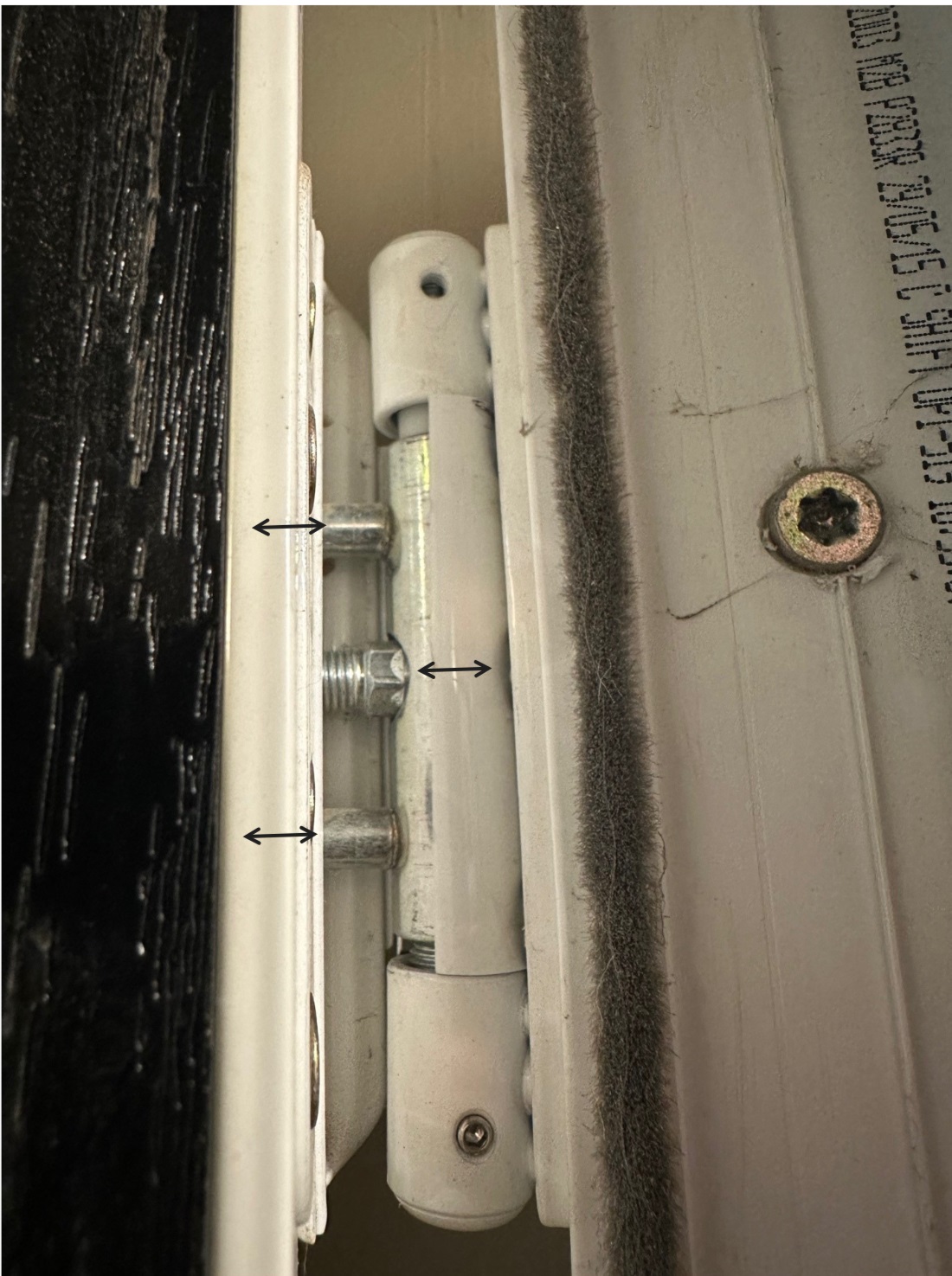

I have noticed 1 - 2mm of movement in the top hinge of my composite door.
This is causing the door to 'catch' at the top edge.
See photo of position of movements.
The middle of the 3 metalic pins moves to the right. So the nut you can just see is moving further into the cashing inline with the 2 grub screws top & bottom.
I have noticed the top grub screw is missing so i will replace this although cannot see any movement through the grub screw hole so do not think it is contributing to the movement.
Any ideas how i can resolve this issue?

The hinge moves on its own.

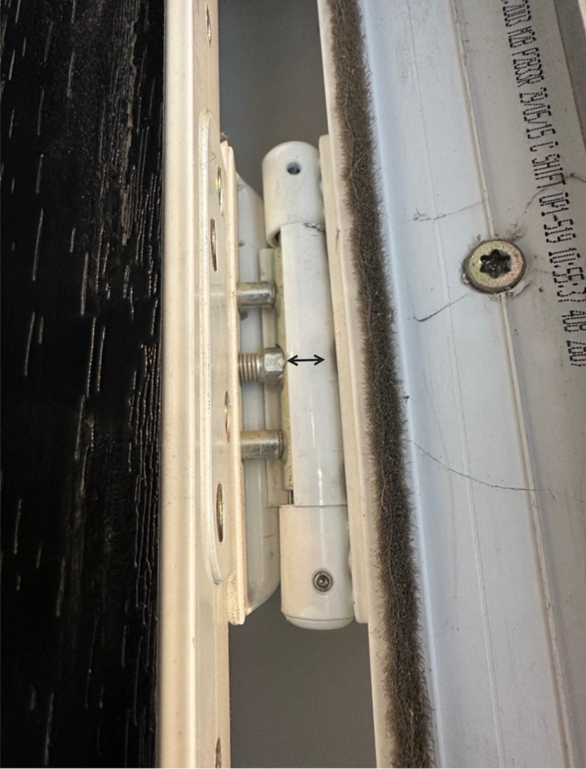

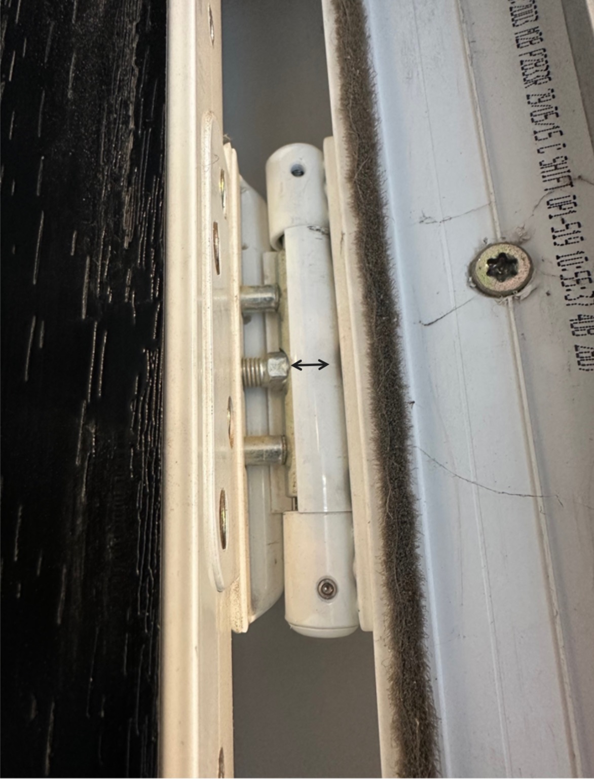

I have taken a clearer photo.
I can lift the door and the nut moves into the housing by 1 - 2mm.
The top and bottom pins move into the door.

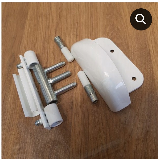

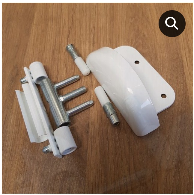

It appears i have one of these types of hinges, https://www.ukdoorlocks.co.uk/product/sfs-composite-door-hinge-sfscomp/
They don;t even look replaceable :(

There is a cover on the hinge centre that shows an Allen key hole , in line with the nut BUT if its moving on its own then the thread is pulling the through the upvc and has damaged it. You may get lucky and find adjusting the bottom hinge the other way might help but ultimately the thread is now damaged within the pvc ( it normally only threads into the pvc and unfortunately these hinges are notorious for doing this).
