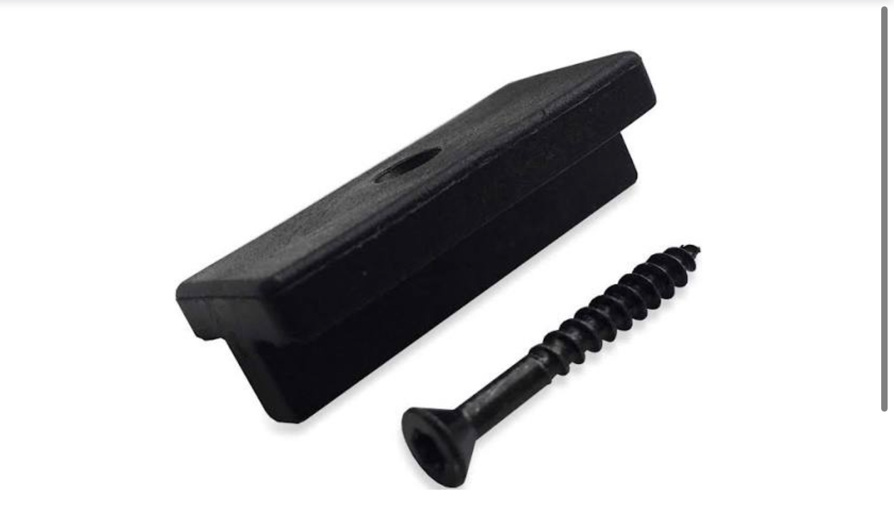

I installed a 9m x 6m composite decking in my garden. When I installed 18 months ago the expansion gaps were 3mm and perfect. Now they are all uneven (see pic). What should i do to fix this to ensure it doesn't happen again?
Any help would be appreciated!
Your timber frame has most of the movement , composite has very little expansion.
The boards are all expanding at different gaps so I'm not sure its the timber
Those fixing look like they only hold via friction,? ,would imagine they are not very effective with smooth material like composite boards.Are the external ends of the boards restricted from movement( framed)?
