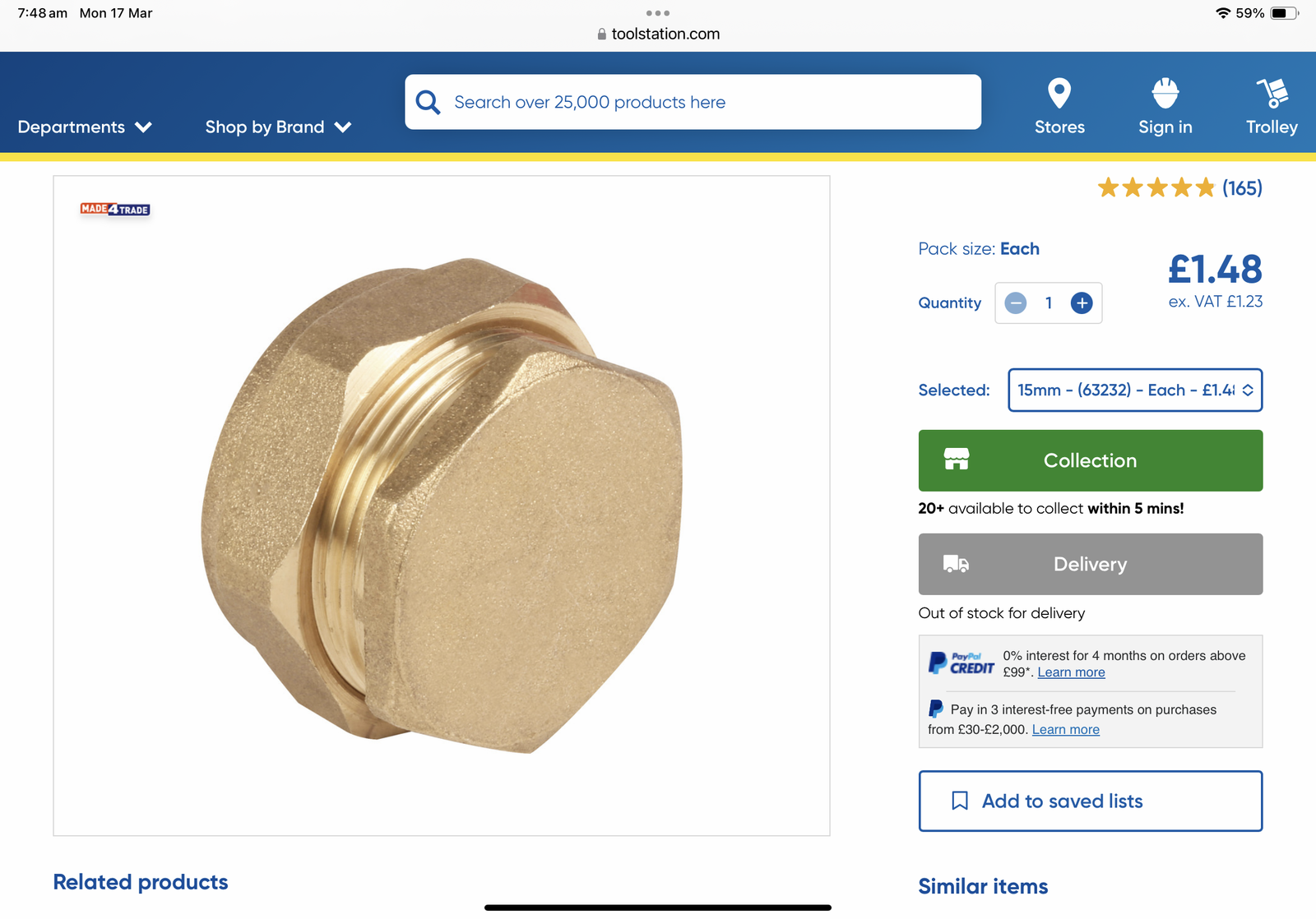

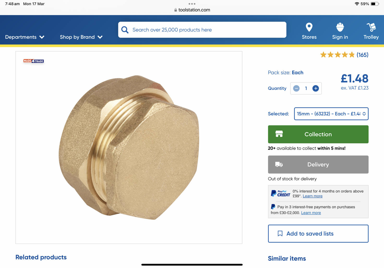

Can’t you just use the centre piece out of this?
Erm, not sure that male cap would fit onto a female threaded leg of an elbow?
@imroberts either or will do but as suggested, don't over tighten it, the fluted end on the elbow that takes the olive can cut into the seal in the blanking cap and then it'll leak. May be easier just to use a little stub of pipe and use a push fit stop end?
This would work just as well actually - I have no need to leave the elbows in place as the whole lot will be replaced at a later date anyway.
I'd just assumed I would leave them in place and blank off the open ends.
Removing the elbows completely and fitting the centre of this on the end of the pipe I'm left with would probably be a better solution.
