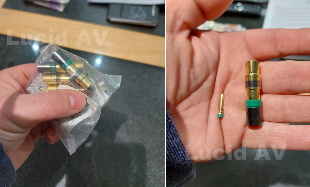

As for compression RF plugs, I have some that I use with a nutter-mad super-shielded BBC RF coax. The cable is daft money per metre because of the huge copper content and its rarity. The plugs aren't exactly cheap either, but they aren't stratospheric. If you absolutely must have some compression RF male coax plugs then I could sort you out as long as you don't need more that say half a dozen or so.
FYI, here is what the compression coax plugs look like.
Note, you're seeing this in pre-compressed form, so the barrel length is longer because the plug hasn't yet been closed on to the cable.
It's very generous to offer to supply the male coax plugs, but I probably need closer to 10-15 and I was looking for a way to purchase additional ones in the future if required. If it's a case of getting the f connectors and then using an adapter (like this, https://www.screwfix.com/p/labgear-f-to-coax-plugs-pack-of-10/39772) then so be it.
Edit: I wrote the above and then saw your more recent reply with the photos - they look like the ones that are listed on the tdi group website.

Regarding the coax compression plugs, I have them on the van, but never use them with an ordinary TV job. It's OTT for a couple of reasons.
The first are practical reasons. By the time I've gone and got these out of the van I could have made up 3 or 4 plug ends with ordinary coax plugs using the knife and cutters I carry.
Second, the longer plug barrel can put more strain on a coax socket, or just get in the way more.
Third, other than cosmetic reasons, it doesn't make much difference. Fit a standard coax plug well enough and it will work just the same.
Finally, if ever I needed to shorten a coax cable then I can do so without binning an otherwise perfectly serviceable plug end.
In short, I don't bother with compression coax RF plugs, or F plugs with adapters for the same reasons as above when a Belling Lee RF plug or socket does just as well and, in some circumstances, maybe even better.
