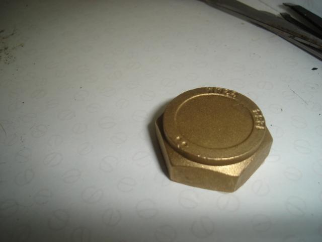

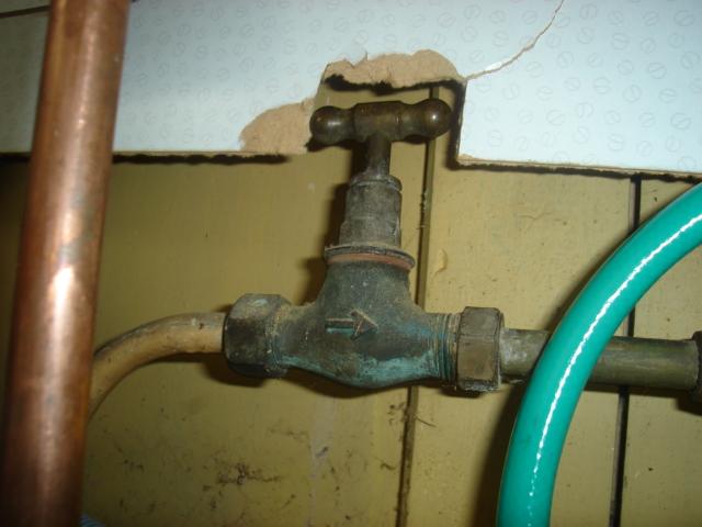

Where I choose to put the tap under the sink was after the water shut off tap, which makes a lot of sense incase anything bad was to happen. Everything okay so far,, However I did notice that the new plumbing has avoided the shut of tap for the water, bit of a worry... Anywho.. I cant switch on the tap and get the water outside as at the end of the plumbing section is a elbow joint with no cap on it.... I went to b&q and they had two sizes of cap one at 15mm and the other at 22mm. Looks like a standard fitting.. Bought the 22mm compression cap, however Im having trouble with it. It will not screw on and the rubber cap inside is not helping. I have an ajustable wrench that fitts the capp but im not getting anywhere. Is there an easy suggestion out there,, I cant solder and dont have access to soldering equipment so thats out the window..

Best bet is probably to dismantle the 1/2 inch compression joint, one back from the elbow. A 22mm nut will not fit on a 3/4 inch thread. 15mm and 1/2 inch are usually compatible, and you should be able to use an ordinary 15mm compression stop end. Note that what you have at the moment is not a stop end but a blanking nut.
By the way, to do a proper job you will need two adjustable spanners.

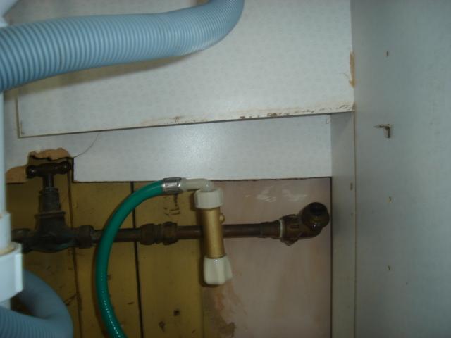

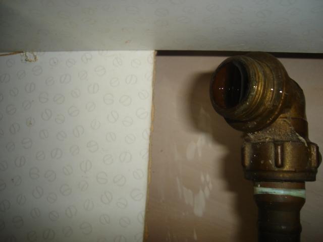

Do I dismantle the compression joint after the place where I put in the outdoor tap insert? - as per picture
What do I put on the pipe after I have taken of this joint??
Many thanks
oops, didn't notice that it was attached :oops:
In that case cut the pipe between the outdoor draw-off and the elbow, then use a 15mm stop-end.

That's right, screwing the two parts together deforms a compression ring (olive) which grips the pipe. They shouldn't be overtightened, and if it should leak despite being nipped up a bit tighter, you may need a bit of jointing compound or ptfe tape around the olive.
