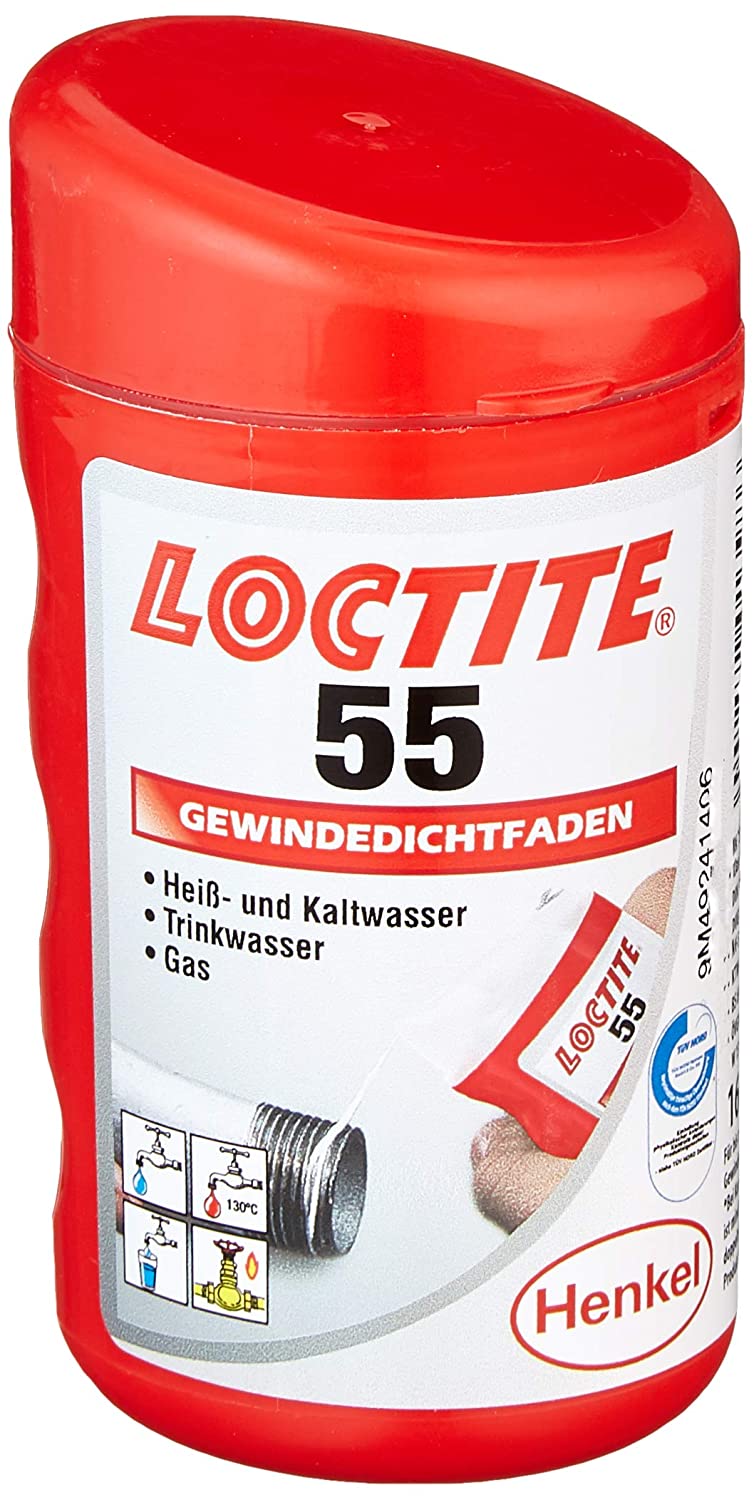

Not heard of Loctite 55 but may have to use that if I can't get a suitable washer.
It allows you to wind tight and even back-off a little and still remains water-tight.
Loctite 55 it is then, seems good stuff from all reports.
Thanks muchly :D
