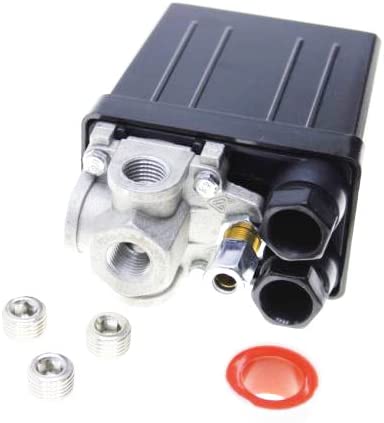

A new generic one seems to be about a tenner.
https://www.amazon.co.uk/214124-Com...2&sprefix=Compressor+presure+,aps,160&sr=8-10
The one above looks very similar but it lacks the female nut where it meets the male part on the tank.

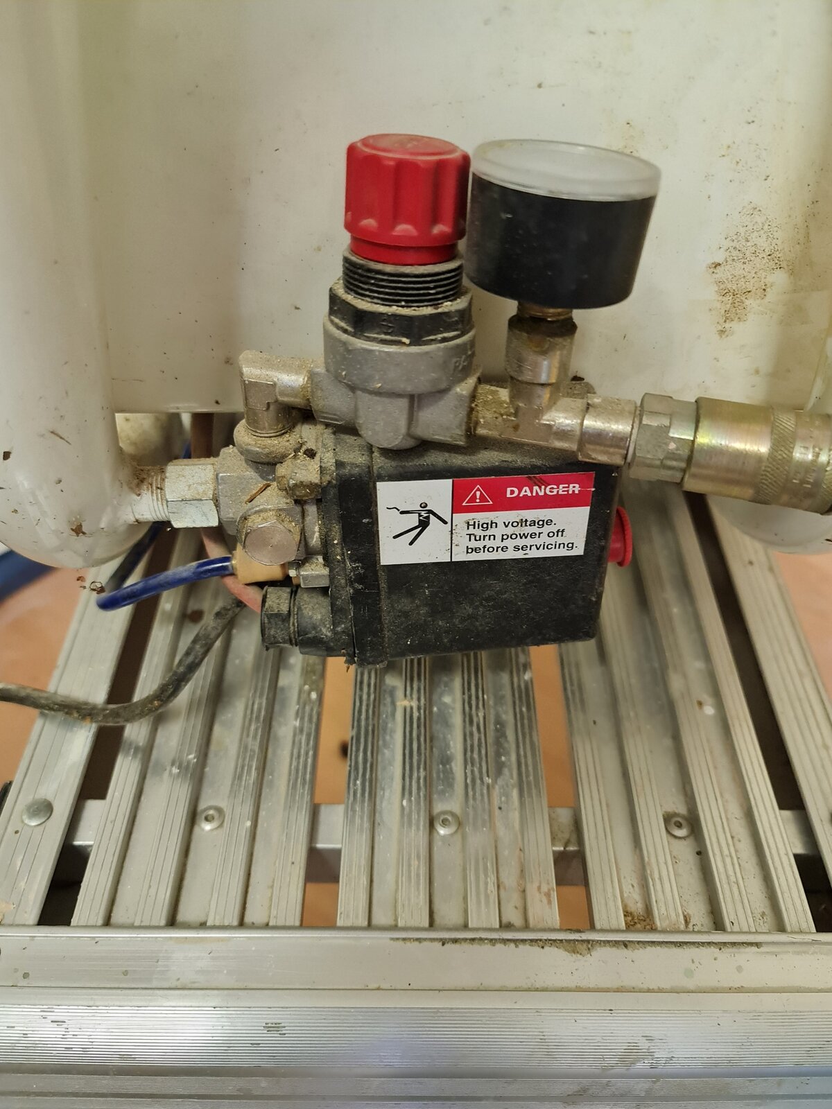

Mine looks like this
The other thing I can't work out is how to remove the blue pipe. The amazon replacement seems to have a nut where the blue pipe goes.
Try pushing the metal shroud around the pipe, while pushed up pull out the blue pipe.

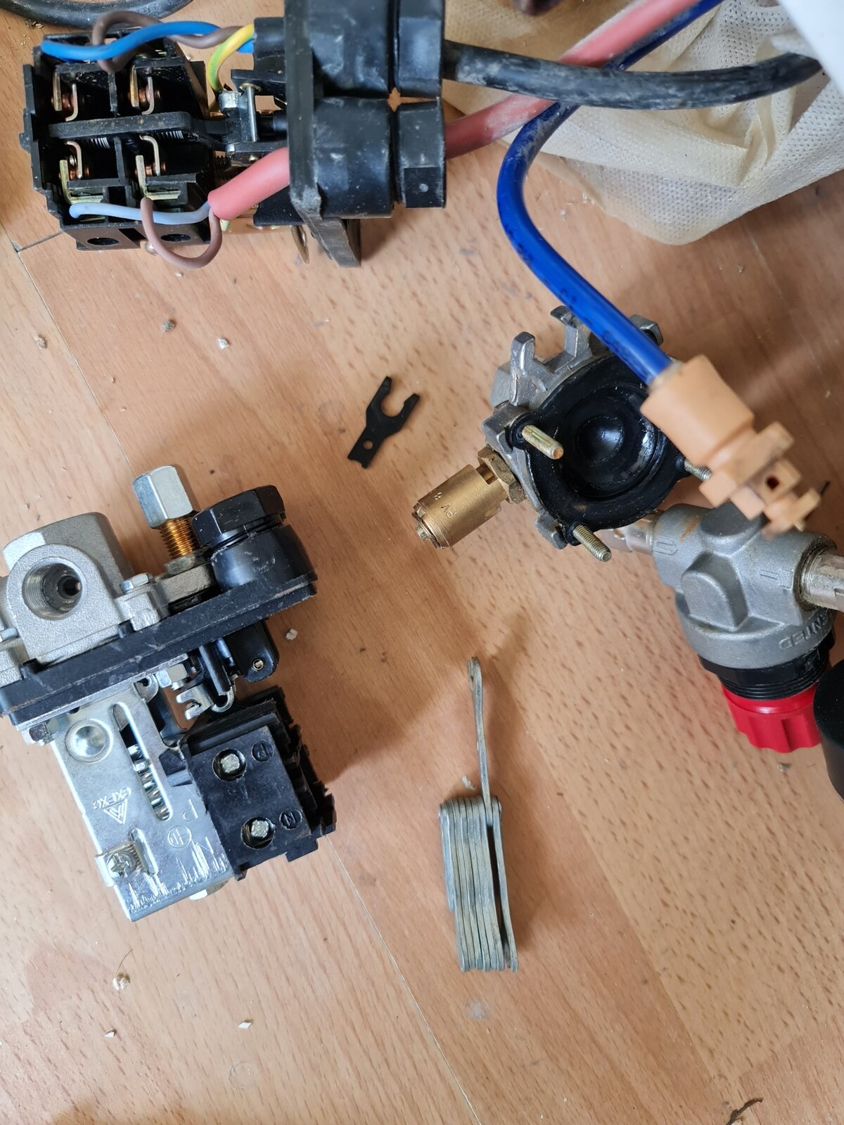

Update
I did clean out the old switch but it made no difference.
I worked out how to remove the blue pipe- once you remove the back of the switch there is what looks like a toy black spanner (see middle of photo)

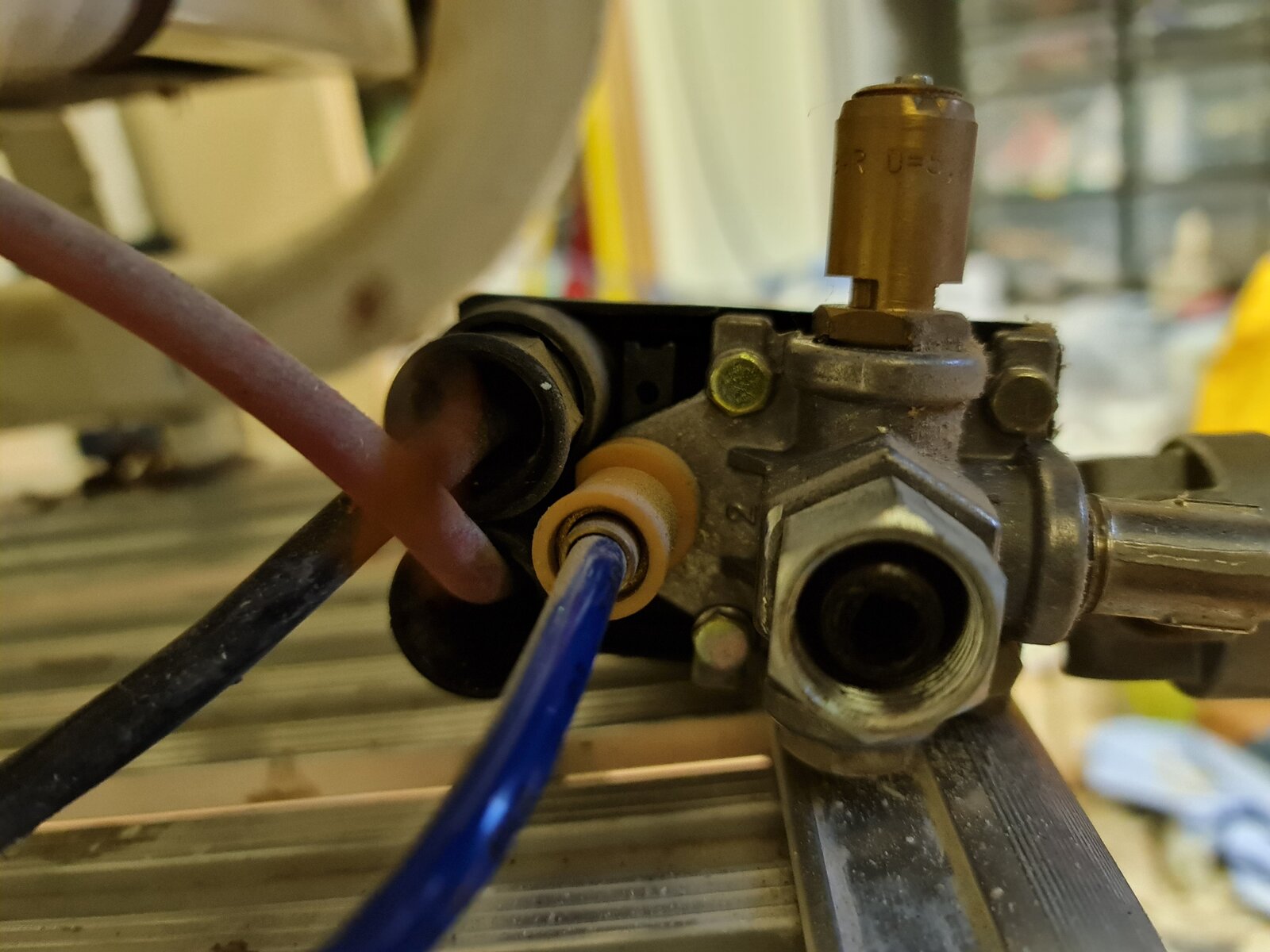

The problem I now have is the nut (connected to the old switch) that runs from the switch unit to the reservoir. I have no idea how to remove it and fit it to the new switch. Initially, I assumed that I just needed to put an Allen key in it and unscrew it, but none of my metric or imperial Allen keys seem to grip anything. The hole inside looks round. The nut can be seen in image 2 and 4.
I guess I will need to order a male to female connector. Does anyone know what size they are?
I have used the red twisty knob thing to reduce the required pressure. It reaches the lower level and still keeps on running.

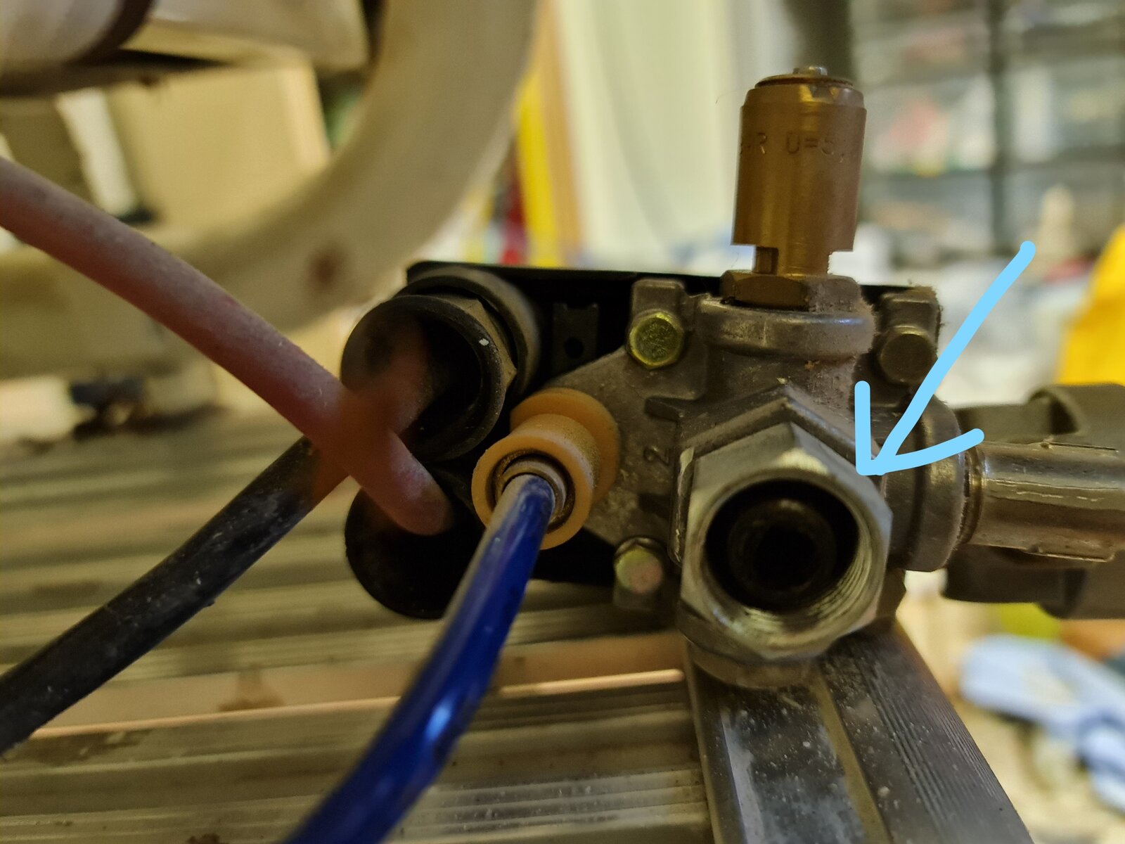

Next problem....
The new pressure switch has a 1/4 inch female port. The reservoir has a larger male port.
The old pressure switch had an male to female adaptor. I had hoped that it was fitted to the pressure switch by using an allen key. There is no hex inside the fitting, meaning that I cannot remove it and connect it to the port on the new switch. See image
I did measure the male fitting on the reservoir, according to my callipers it is 0.66 inches. The 1/4 inch blanking plugs supplied with the new switch measure 0.4"? I have no idea how you measure BSP fittings but given that the male is approximately 50% bigger than the male blanking plug I guess it means that I am not looking at a 1/2" to 1/4"? So do I need a 3/8 to 1/4?
