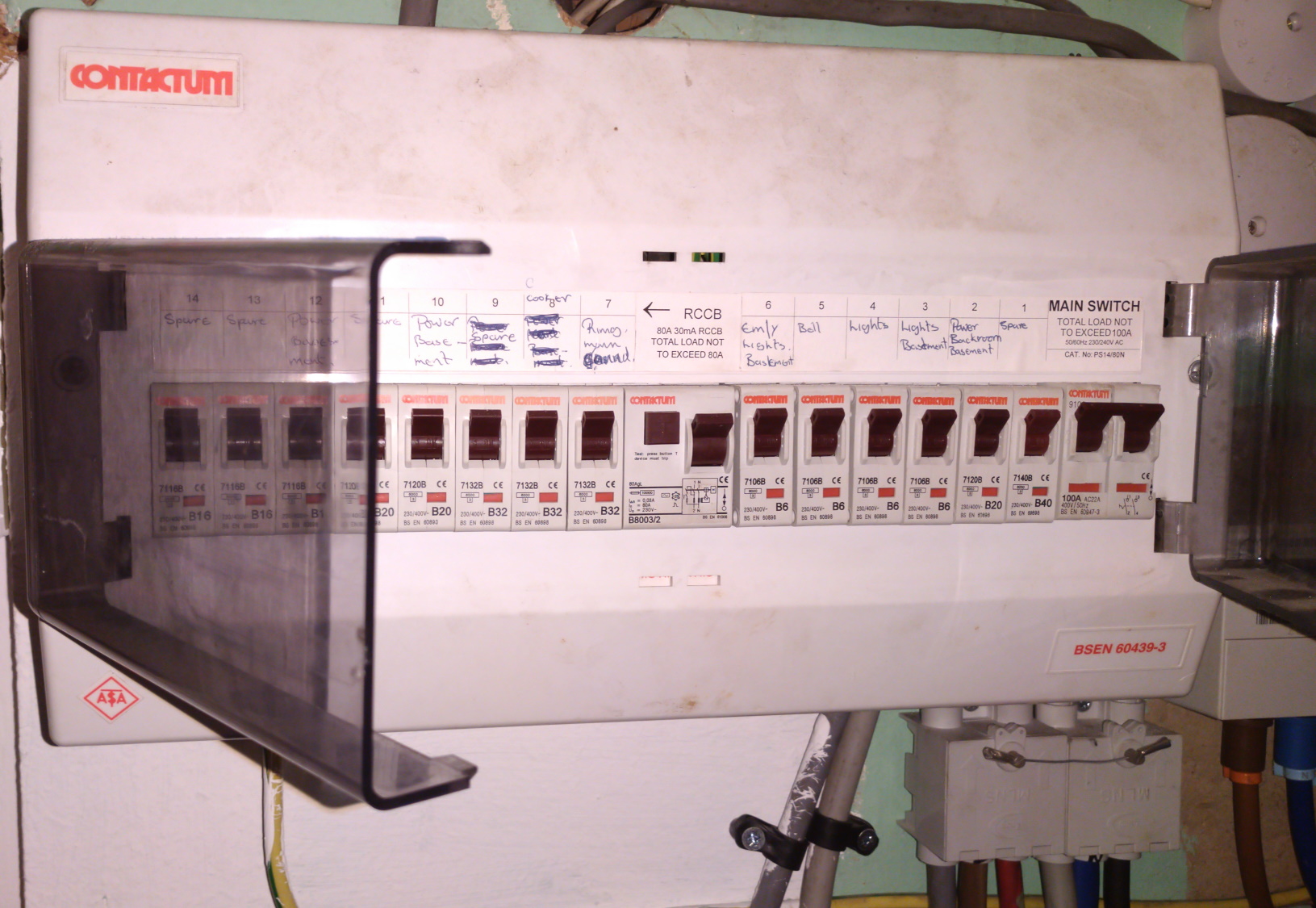

I have a self built PC and I'm having trouble with it switching off when other circuits are switched on and off. I've already swapped the PSU from a cheapish brand to a Seasonic Focus GX.
I did try connecting via a UPS but that seemed not to help, the PSU would turn off one in three times when the UPS was self tested, but that could be due to the UPS being consumer grade and I'm unsure what exactly what (or where) the surge suppression is in the circuit (although I suspect it's a MOV type). I'm probably going to send the UPS back as it is supposed to cope with a PFC type PSU.
The thing that does work is a PD Devices surge protector (RS 206-7522) in a 13 amp plug and that has stopped the PC from tripping when switches are turned off and on. The mains sockets themselves test okay with a Kewtech 107 and it's loop impedance test is fine.
So while I'm happy I've fixed my current issue, this leaves me wondering if I have some sort of electrical fault or just a very fussy computer which doesn't like light switches.
Is worth getting an electrician in to try to diagnose things? Would a new consumer unit with surge protection built in help?
I've attached a picture of the current consumer unit.

I would think almost certainly the latter. I've never heard of this happening even when large loads on the electrical installation are switched on/off, even without any 'surge protection'. One might hypothesise that some fault in the electrical installation's earthing might somehow be implicated, but since your Kewtech shows an acceptable loop impedance, that's more-or-less ruled out.
Do you mean that the PC's PSU is shutting down? If so, I think the first thing I'd look into would be the possibility an imperfect (high resistance) connection in the signal line (maybe at the connector) that turns the PSU on/off (pin 16 of an ATX connector).

Definatly something odd going on here, I could quite beleive a cheap and cheerful PSU beig affected by switching noise etc, but for it to continue with a seasonic is odd as they are far from the cheaper end of the scale! The fact that a surge suppressor helps does point to it being switching noise though. I would have guessed earthing issues but that appears to have been ruled out, Could the noise be entering the computer another way, perhaps through a network cable or similar. Can you disconnect everything else from the PC and see if it still does it (does it do it everytime w switch is flicked, or would you have to leave it a while to see if its cured it)
Could the PC case be picking up an earth at a different potential from anywhere else? (i.e. sat against a radiator) etc

I'm still thinking earthing issues with a flakey earth that the kewtech socket tester is failing to pick up

To be specific the machine just dies and needs the "soft power switch" pushing which restarts without an issue, from memory the lan link light is still on at this point.
It's been stable since I started using a surge surpressor plug but that doesn't really help with narrowing stuff down.
For testing purposes I have found that switching the downstairs toiler light off and on a few times seems to cause the PC to turn off (usually when the light is turned off)
I suspect the PSU / motherboard is a bit sensitive as it doesn't cope with the UPS self test very well the failure mode seems to be when switching back to local mains(roughly one in three times) having gone to battery backup this was definitely worse with the previous PSU which just failed the UPS test almost every time.
Given the plug tester gave a safe result on the earth this give me some reassurance it's not an obvious issue. In an ideal world I'd attach a DSO on the PSU outputs but these days there is so much stuff between that everything else these days it's a bit of pain to test. (also I don't have easy access to a DSO these days)
