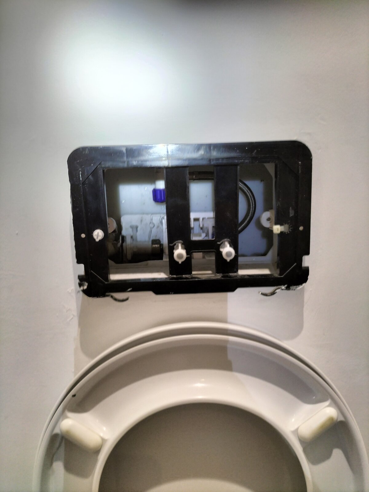

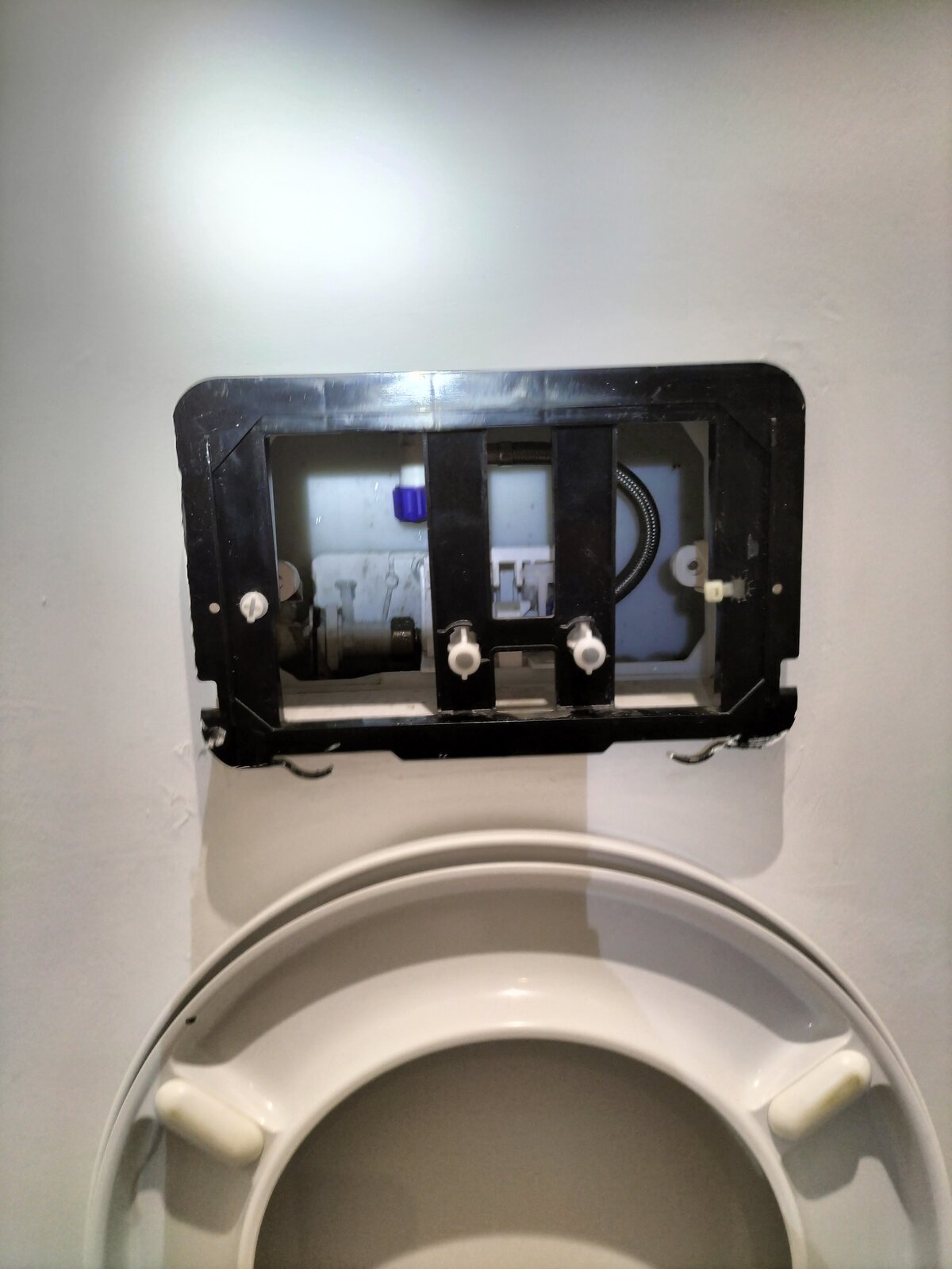

It would be a case of removing the flush plate and seeing if I can see what make the cistern is and order parts?
Sounds like float valve not shutting off properly or the flush valve not seating/letting by
Could be it not seating correctly? As they say they are able to stop it. I guess there double pressing the button or something?
Going to have a look tomorrow. If it's not sitting back correctly after flushed it maybe the flush valve? I have only worked on the grohe ones before. Which were easy to get to every thing

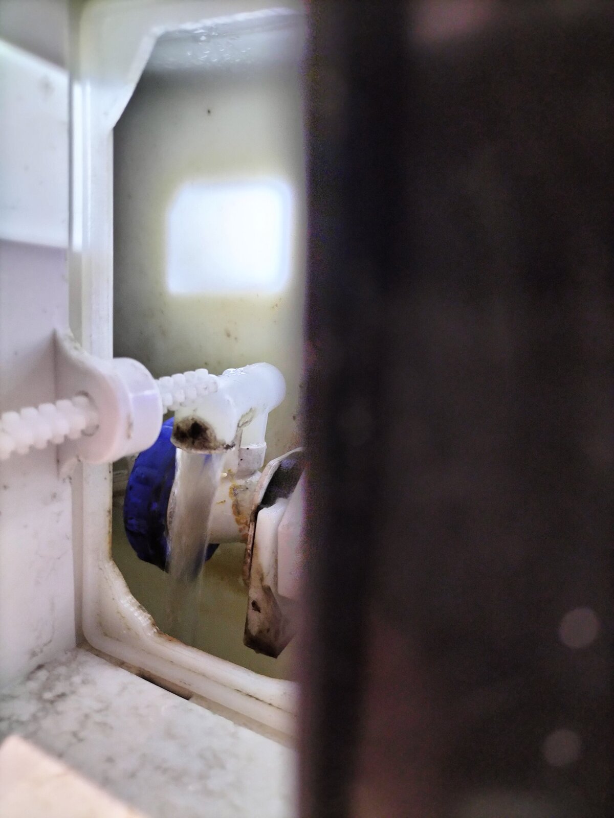

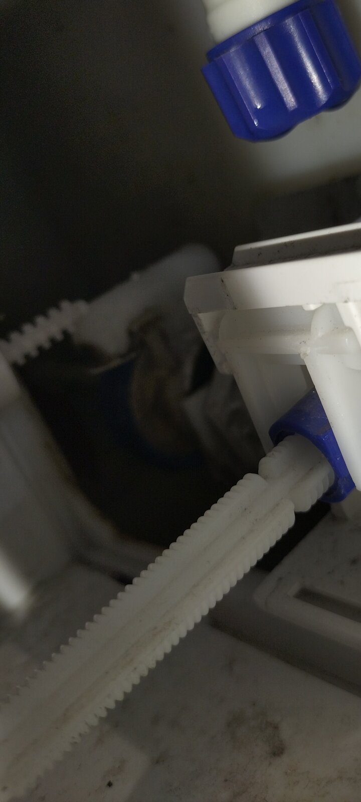

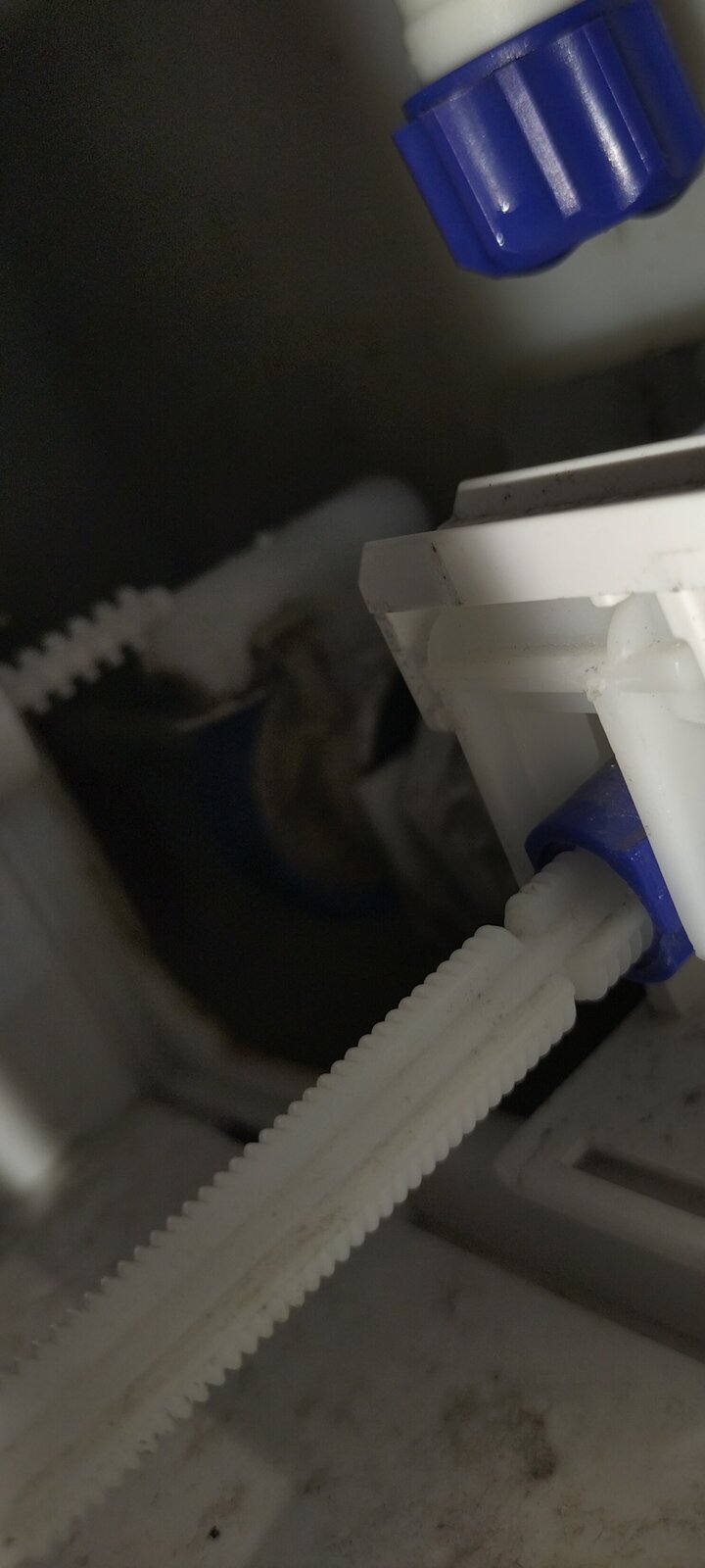

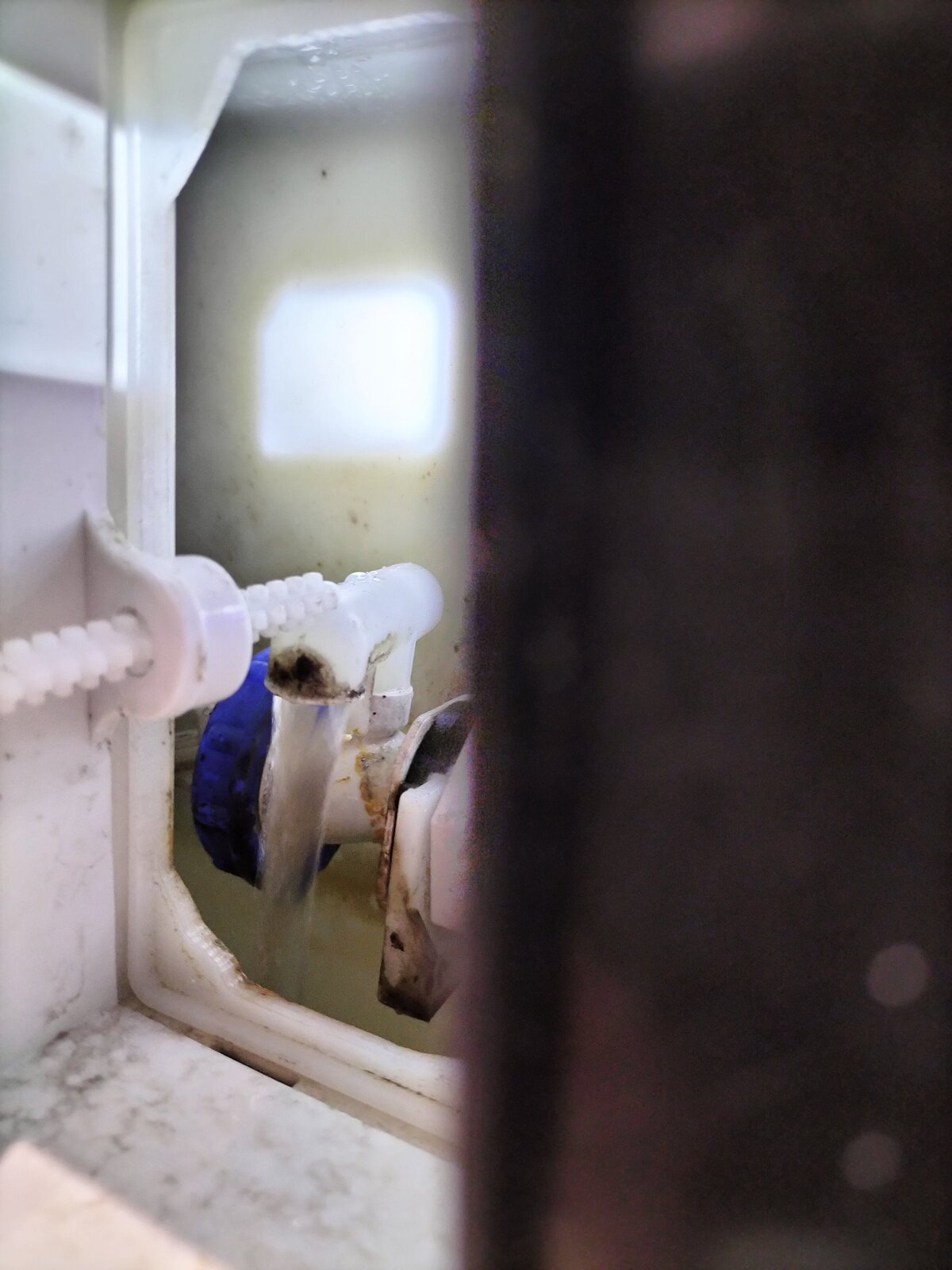

So it's the fill valve not shutting off. Strangely enough the fill valve does eventually shut of by repressing the small fill button. The flush valve is reseating ok and making a seal. It's an ideal standard. Any one had this before? I was going to order a new full valve if I can identify the part.
Does it look like a side entry Torbeck?
