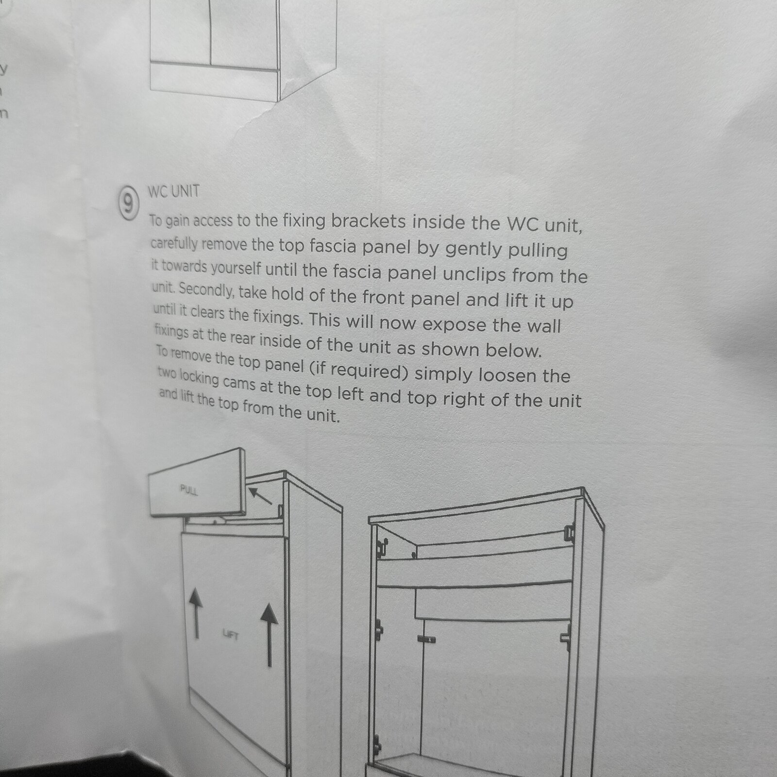

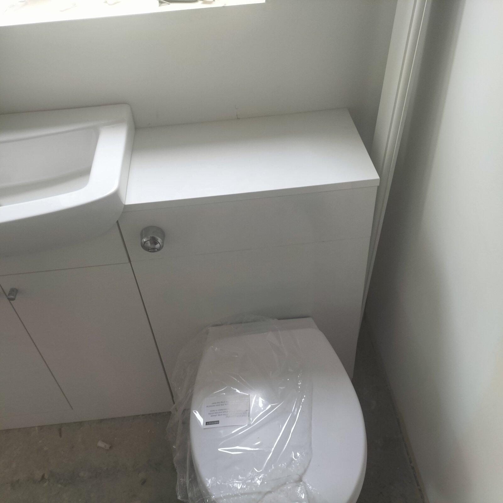

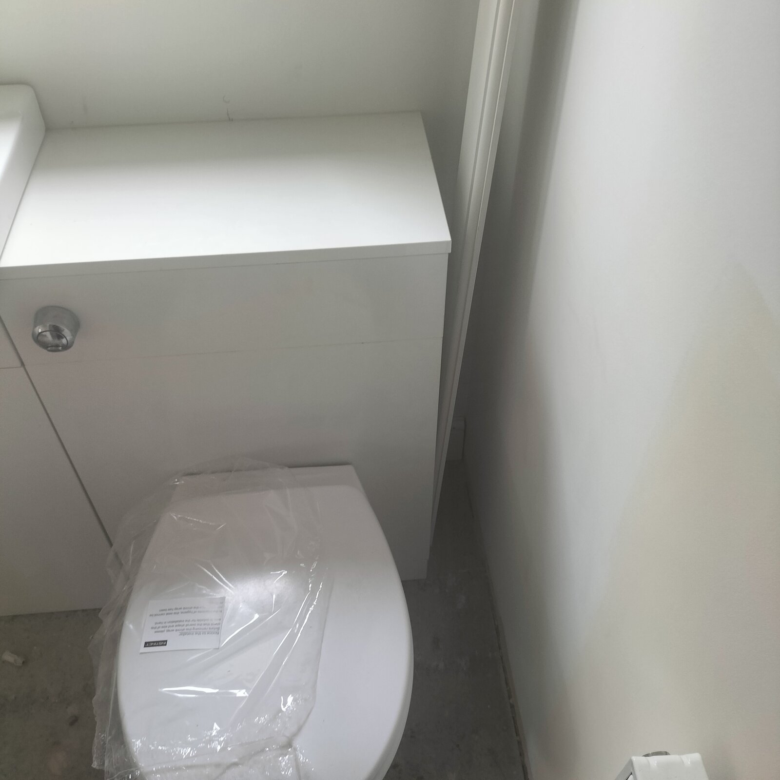

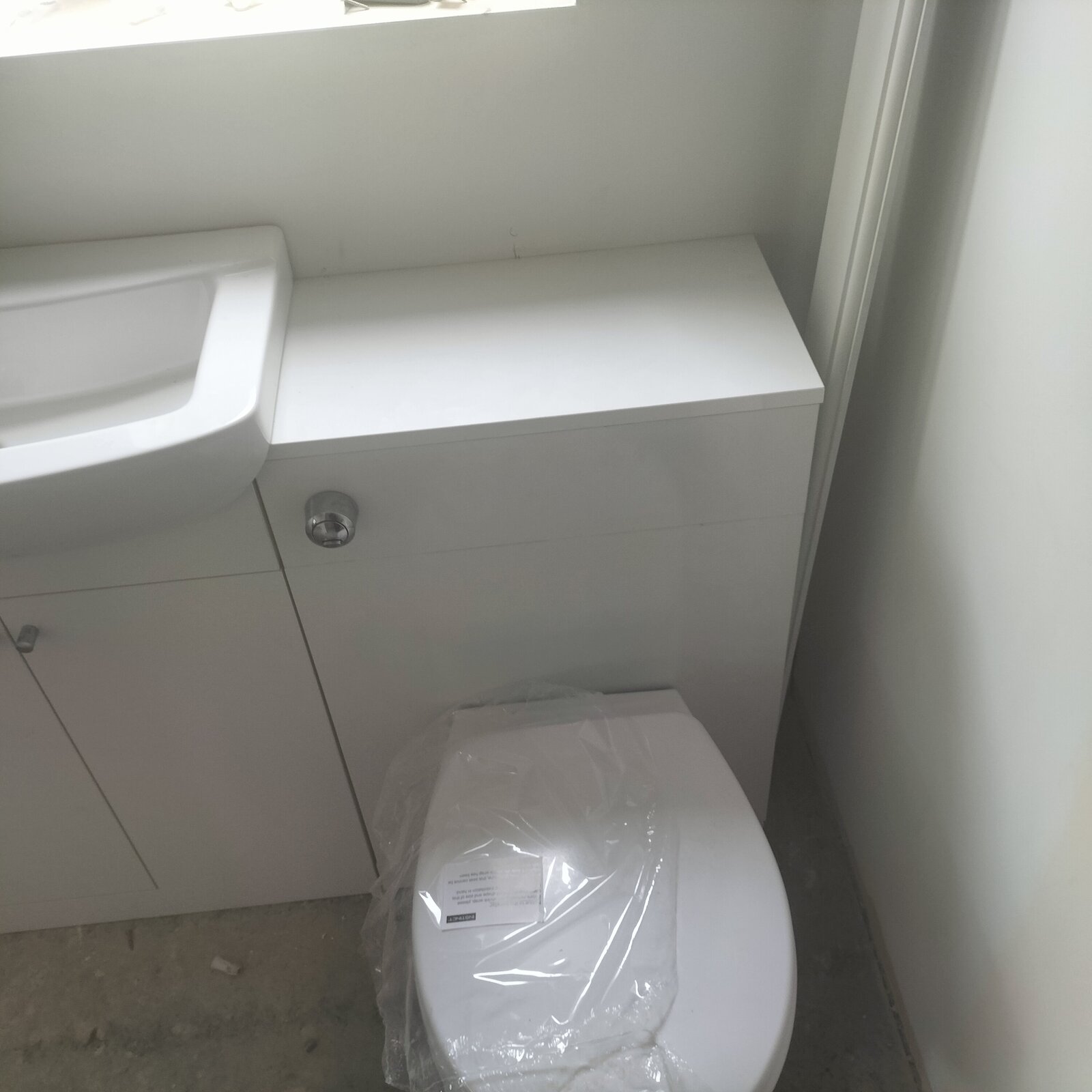

If you fit these concealed cistern toilets with vanity attached flush to the wall is it pretty much impossible to full the top bit off with flush button for access? Thanks the one in the picture isn't flush to wall but wondered if you can or can't thanks

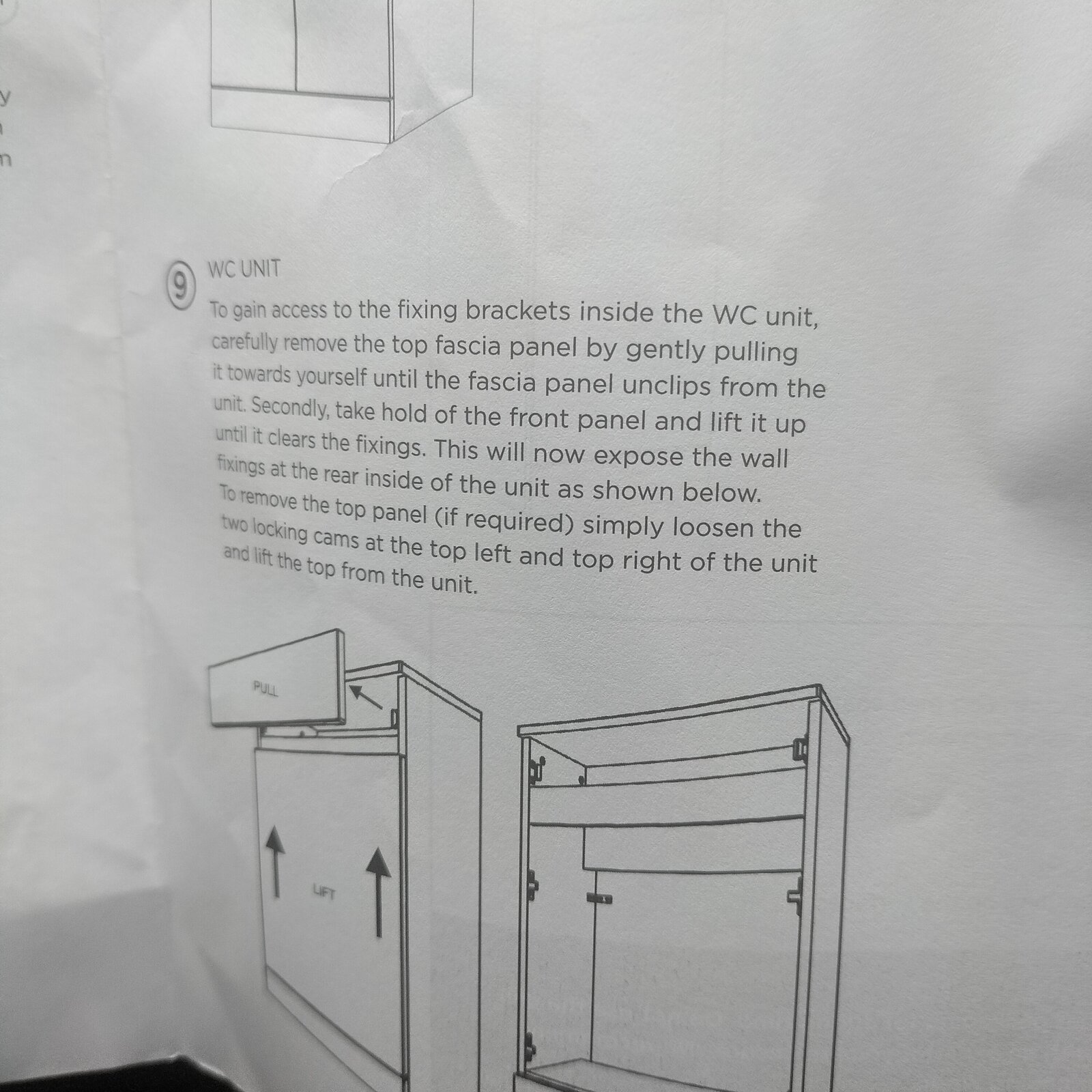

As the diagram shows the front panel with the pushbutton simply pulls off the cabinet (may need a thin blade to assist removal). Then the cable detaches from button to allow panel to be placed out of the way.
Then access to cistern is achieved.
Not especially easy to access the insides but perfectly do-able; and the fill isolater needs thought about how to access and operate that some plumbers give little or no thought about.
Yes sorry but if you fit the unit butt up to the wall one would struggle to get a screwdriver in to remove the cistern panel

If fit butt to wall centre of toilet pan would be 275 from the wall. Too tight?
