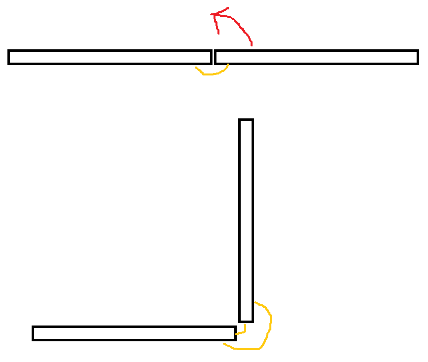

I'm trying to find a way to hinge a sheet of chipboard but concealed. Chipboard is 18mm thick (essentially bits of loftboard I have left over). Barrel hinges look too flimsy to hold the weight.
Here's a crappy MS Paint diagram:
there's a kitchen unit type hinge for that. I have some Blums, the package says "top hinge." If I find them I will post the part no, or you may find it on their website. I think I bought them intending to use them on double/folding doors or a corner unit.
Chipboard is heavy and weak so you will need several hinges.
