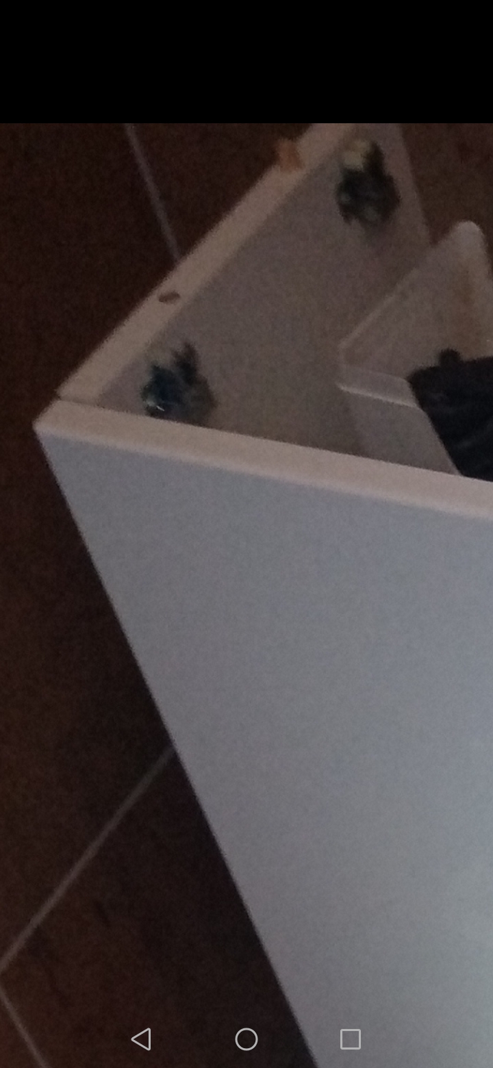

Every concealed toilet cistern I have been to has panels that you push upwards to remove. Or push down to reinstall after fitting or maintenance. I went to one where it appears it is removed by pulling the panel forward. So the toilet needs removing. Seems a real pain. Has anyone had this before thanks.
That's the clips
Correct. The pan has to be removed/ pulled forward. Last one I fitted had wooden dowels between front panel and the cabinet / carcass !!

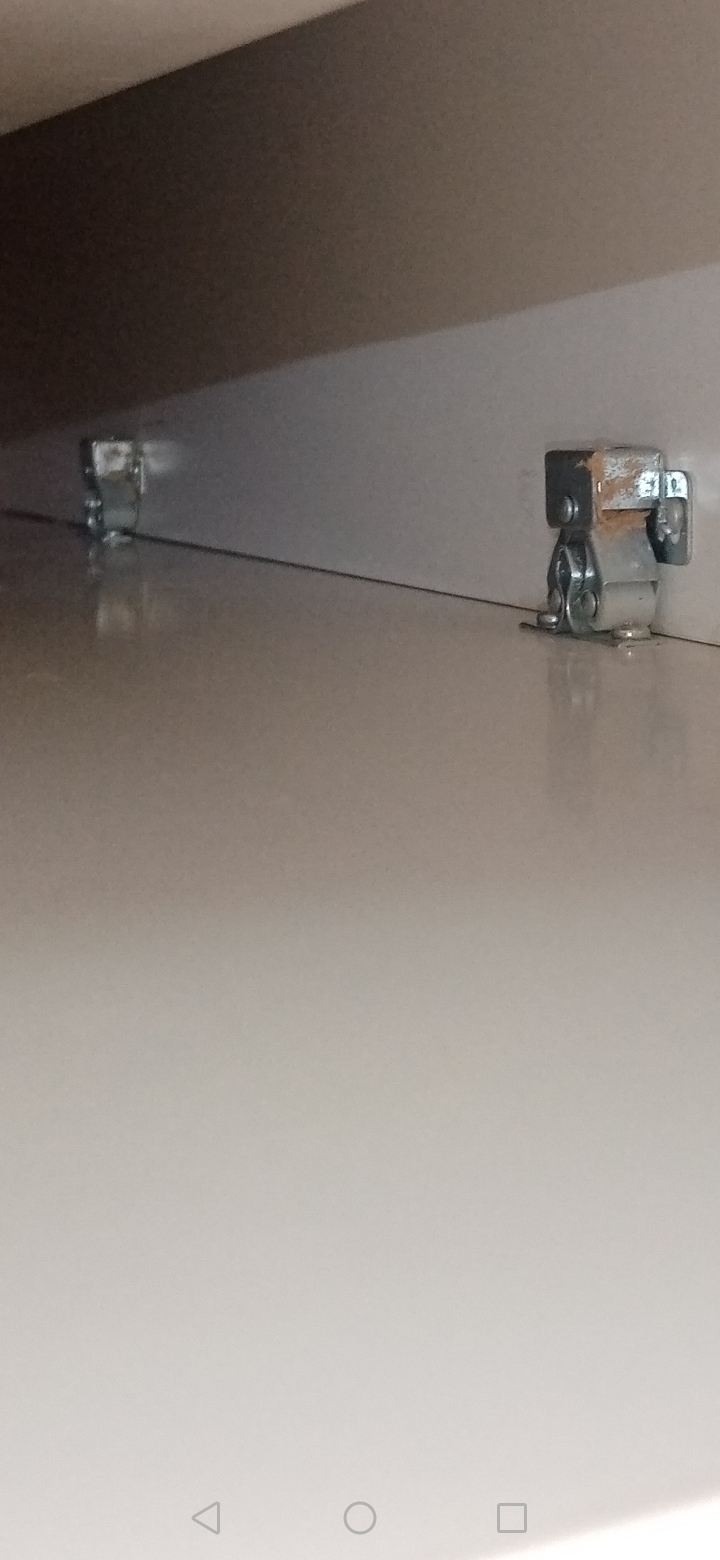

This one may do too. It appears to have then top of the unit.
Have to repair one leaking on flush pipe as leaves cistern and we're enters pan. And seaminly cant get access without removing the pan
