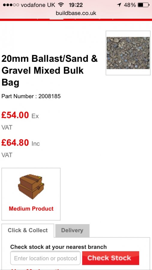

That's great, thanks. But....what's ballast? Lol Is that sand and aggregate mixed?
What mixing ratio do you recommend? I was thinking 4 to 1 but once again, not really sure.

Do I use this with just cement? 6:1 ratio. Do I need pva or plastasiser like when you build a wall?
