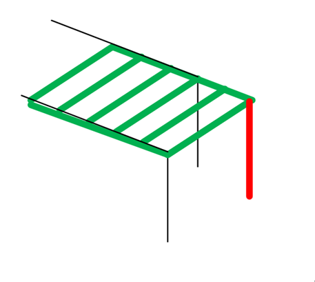

One further piece of advice please
i'm also bringing my garage roof forward a couple of metres
Plan is to install some C16 (47x125mm) vertical bars and joists at 400mm centres between myself and my neighbour (the green lines) which from what i have read, meet the strength criteria allowing access for periodic maintenance
The roof will be boarded with OSB too
But....there will be 1 corner of the roof which is forward of my neighbours that will need some vertical strength (the red line)
I was considering installing something like a 150mm x 150mm wooden post onto a small brick pillar
  1. Would 150mm x 150mm suffice ?
  2. Is there a particular type of wood that i should/should not use ?
  3. Is there some kind of strength rating that i should be looking for ?
thanks in advance as always
Are you planning to cut a chase for lead into the neighbours house? How's that work I'm looking at something similar.
Why can't you cantelever it?
thanks for the reply Woody
My assumption was that the overhang towards my neighbours side would not be strong enough to take the weight of anyone needing to go up and perform maintenance having no vertical support, hence my thought to put a post in place

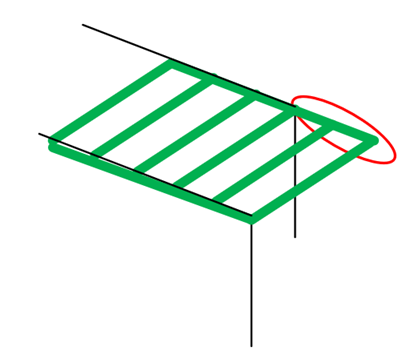

I'd be inclined to cantilever it rather than have that awkward post.
If it can't be done with just timber, add an angle or channel section.
Or if you are worried about maintenance you can design it to take a temporary prop just for those rare occasions.
Agree with woody, looks miles better without post, and worst case, acro prop. Don’t reckon that’d even be needed tho.
thanks again guys
so can i just check, when you say cantilever, you mean basically, nothing else is required other than the horizontal beams/joists bolted to each house, where the one extends approx 1.5 mtrs on the right hand side, and no vertical support would be required in your opinion on that corner ?
would there be a limit on the length the joist that extends forward of the house, before horizontal support is required ?
