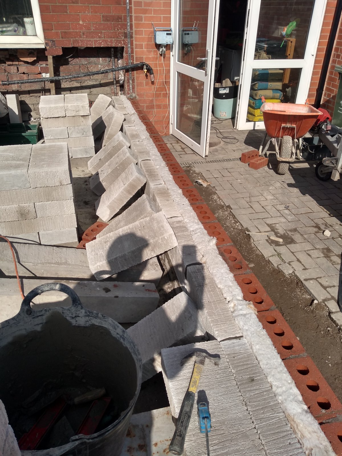

Sorry I can't really help you but I'd love to be laying heavy blocks. I'm using thermalite turbo blocks (2.9N) with a 75mm full fill cavity and it's a PIA!. The blocks are so light the insulation batts keep pushing the blocks outwards, especially on the DPC course where there's no real adhesion at the bottom. I had to prop them up till they went off:
If you can sort out the u values I'd use heavy blocks throughout - and think of the muscles you'll have at the end!!
