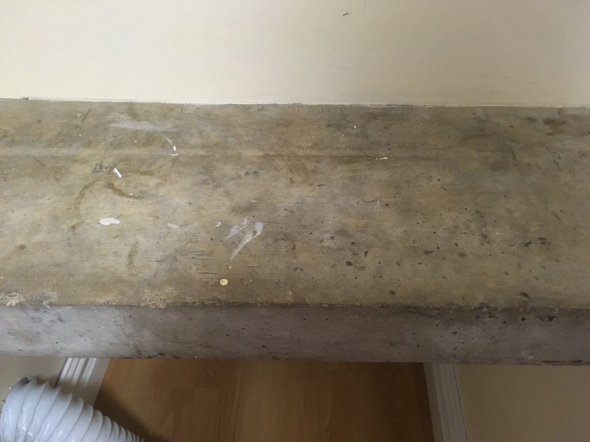

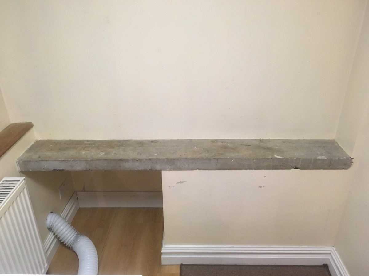

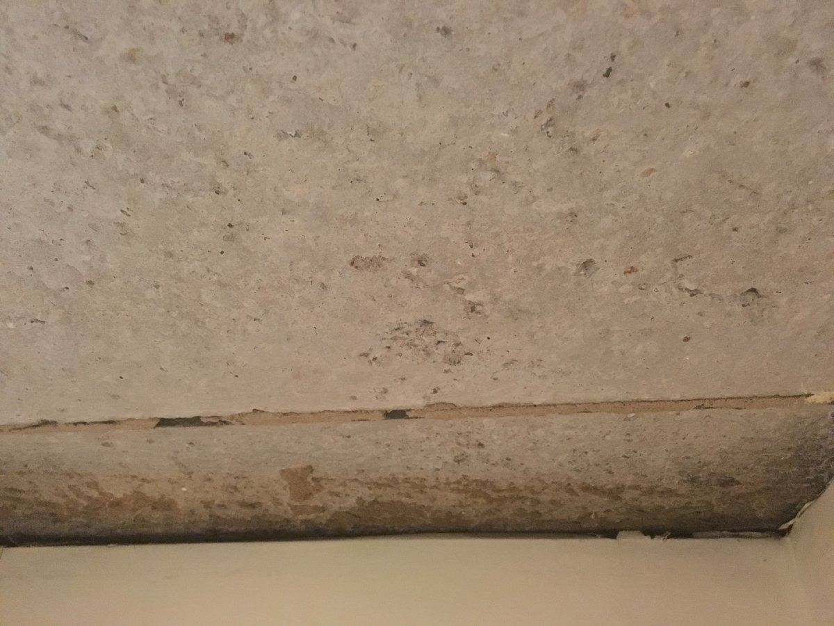

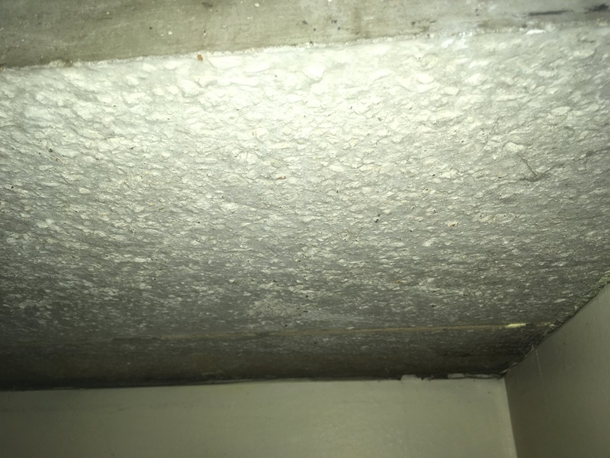

I've posted photos of the concrete and it was the rough underside that was cleaned with the wire brush. Can those with more expertise in this subject, please comment on the likelihood that I may have disturbed asbestos? Hopefully, all I inhaled was concrete dust.
Many thanks in advance.
Photo 1: The upper-side of the shelf.
Photo 2: Close up of the upper side.
Photo 3: The underside of the shelf #1 (The section that I cleaned using a wire brush) - Note that the flash makes it appear brighter than it is. (see next photo)
Photo 4: The underside of the shelf #2 (The section that I cleaned using a wire brush)

pcm77, good evening.
Possible confusion? Asbestos bound Cement board is common, used in roofs, Corrugated in nature, generally contains "White Asbestos" [try Googling this material]
As for Asbestos being incorporated into a Concrete slab, for me at least does not fit?? Concrete in slab form and Asbestos Sheet do not jell unless the Asbestos Sheet was used as a form of Shuttering and not removed?
Concrete is a mix of Sand, Chips and Cement, the possible combinations of three simple ingredients are verging on the endless, at no time does Asbestos feature in the "mix" it is not strong enough and provides no added value to Concrete.
As above Asbestos bound board has historically had a value.
Ken

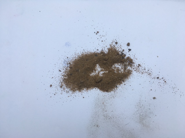

I attach another picture which is the material that brushed off (which happened to be in my vacuum after the job). To my untrained eye, it looks benign.
My final query before I put this topic to bed. Would you be in agreement with this conclusion?

It looks to me like a simple concrete slab I have never heard of asbestos in concrete. Why would you use it? concrete is fire proof, incredibly hard and if you need more strength you just build in steel rods.
The confusion I suspect is where boards are constructed like AC (asbestos cement) like flue pipes and garage roofs, or AIB (asbestos insulation board) used as fireproofing in heater compartments and sometimes for house soffits.
Both are quite thin and brittle the fibres give what is in effect a thin sheet of cement some strength. They are not load bearing and not at all suitable for the construction you have there.
US sites will tell you asbestos was used in everything! When you delve deeper they are usually linked to personal injuries claim companies!
