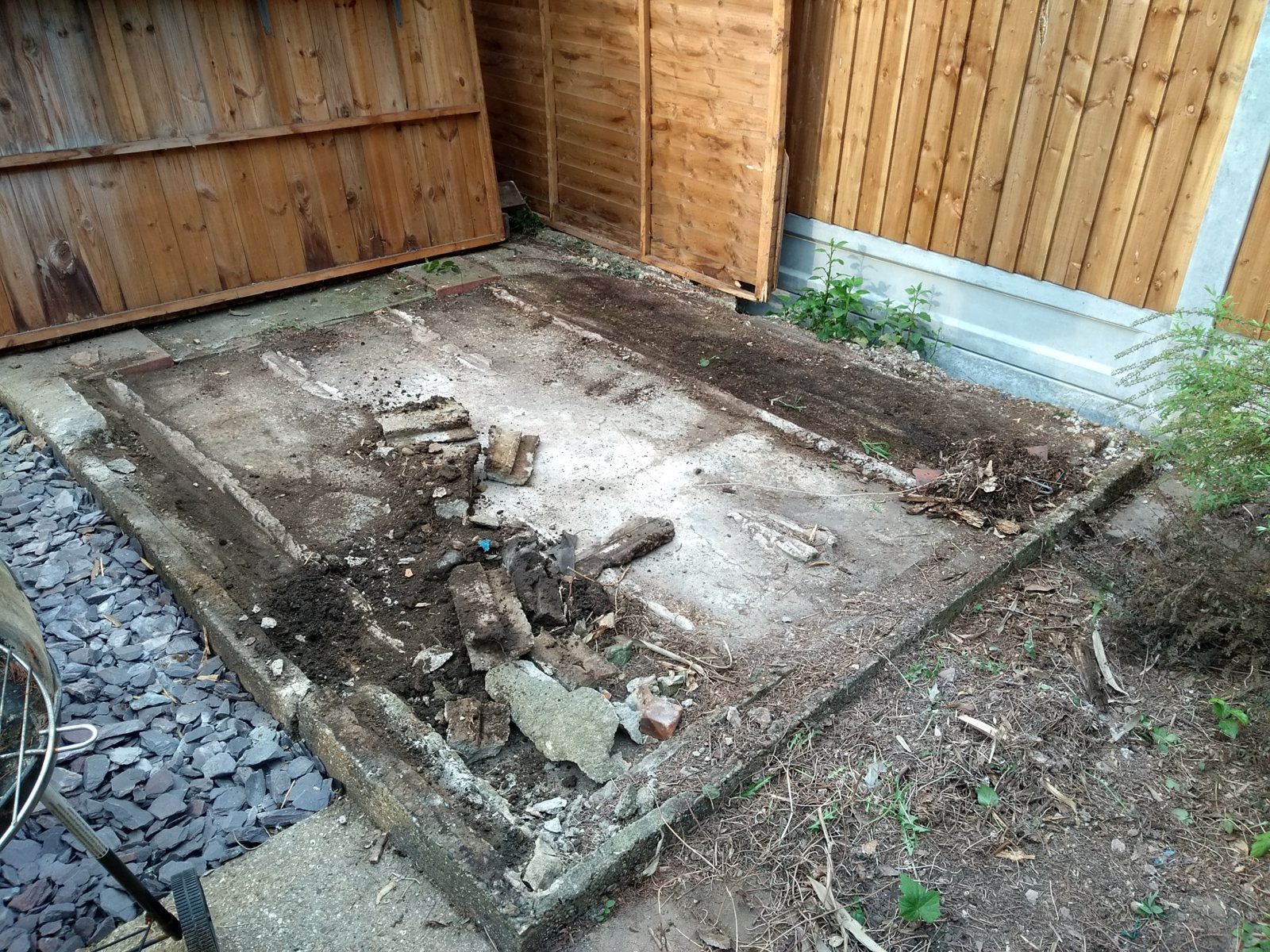

Got a 7x9 foot shed. Just removed a 4x6 ft shed that was on this old base. Base is about 7 ft square. The shed was testing on 3 9ft 5x2s, which rotted a bit.
So, thinking of putting 3 9ft concrete fence posts down to support the base. Will over hang old concrete base, but i can support end a bit, although doubt they'd need it?
Obviously will clean base up more.
maybe overkill? Just use normal wood?
You say your old shed was smaller than the base. So rainwater will have fallen on it, and possibly pooled, accelerating rot in damp timbers. Especially if you did not have gutters to remove water falling on the roof.
If the new shed is big enough to overhang the base, and you scrape away surrounding soil so it is lower, water will not run onto the base and you will only have dampness rising from the ground, which DPC under the bearers will block.

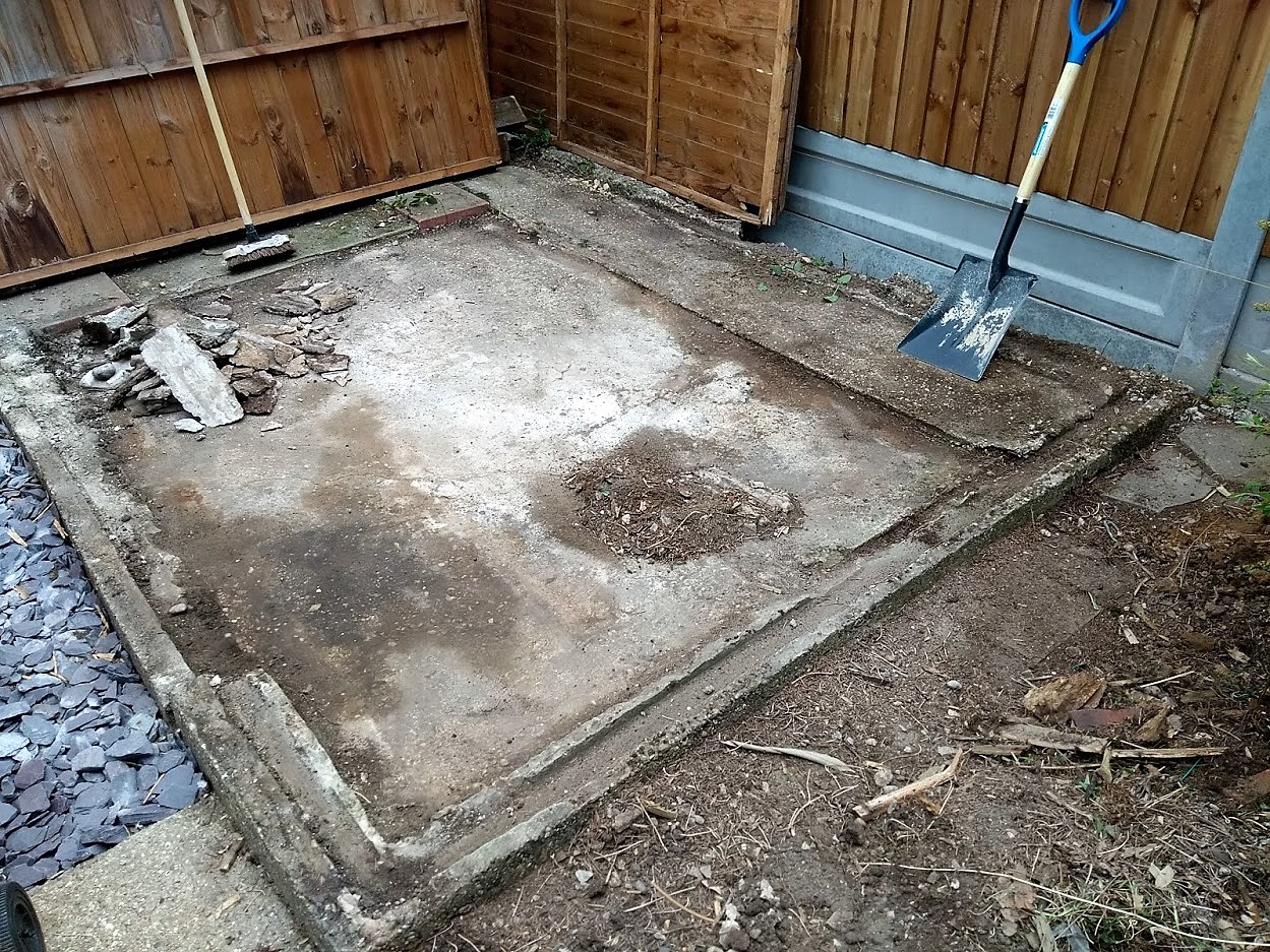

Good point. Have cleared more of the base - I guess there was once a larger building on it. There are lots of grooves which were full of soil, leaves, woodlice, ants, worms etc. Think it might make sense to have a new layer of concrete over the whole lot.
The previous shed had no bearers, just a chipboard base on the ground. With a carpet in it to help reduce air flow!
The base is just over 7 foot wide, and the strip of concrete by the fence is a bit higher too.

Sorry the pictures didn't load for me originally, just seen them now -- leveling and extending that base is the best method. You can hire a mixer by the day relatively cheaply (£12 a day here) and get a half-tonne bag of ballast and a few bags of cement. It is a small job for a tradesman so that's probably why you're struggling.
It's hard work shifting it all but worth it.
If you were to just use posts, you'd have to do put a lot of packing underneath the posts to secure them with weight on the top.
