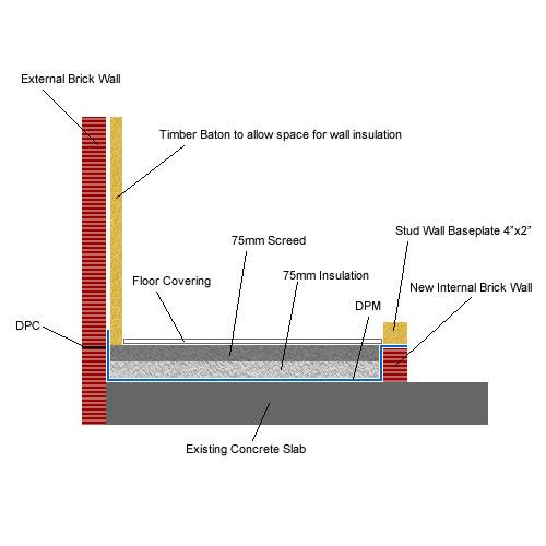

The above post was a bit long, to help I've put a picture together. This picture shows what I am proposing to do:
I've guessed the answers to my own questions to generate this, and gone with 75mm insulation with 75mm screed. DPM under insulation and overlapping up the wall past the DPC.
If the above is all correct can anyone answer the two remaining points:
Will sand be OK to 'level' the concrete floor before putting the insulation on top?
Do I require the polystyrene edging so that the screed never touches the walls? Somehow I prefer the thought of the concrete going right to the edges!
Thanks in advance
Have guessed the answers to my own questions to generate this, and gone with 75mm insulation with 75mm screed. DPM under insulation and overlapping up the wall past the DPC.
Answer. Okay
Answer. Yes, just a whisper to level her up.
Answer. Suggest you use 75mm Celotex instead of polystyrene, then 75mm grit sand and cement screed 4 to 1 with added fibres as reinforcement. 25mm x 150mm deep perimeter insulation to all eternal edges and unheated adjoining edges

If you are not doing it under Building regs, then use polystyrene. Why we said celotex, is that you need approx half the thickness again of styrene to equal the u value of celotex.
The old story. Yous gets whats yous pays fors.
50 and 25 will be okay and you can use the 25 round perimeter.
Put the 50 on top of 25.
Do not reduce screed under 75mm and do not forget fibres
