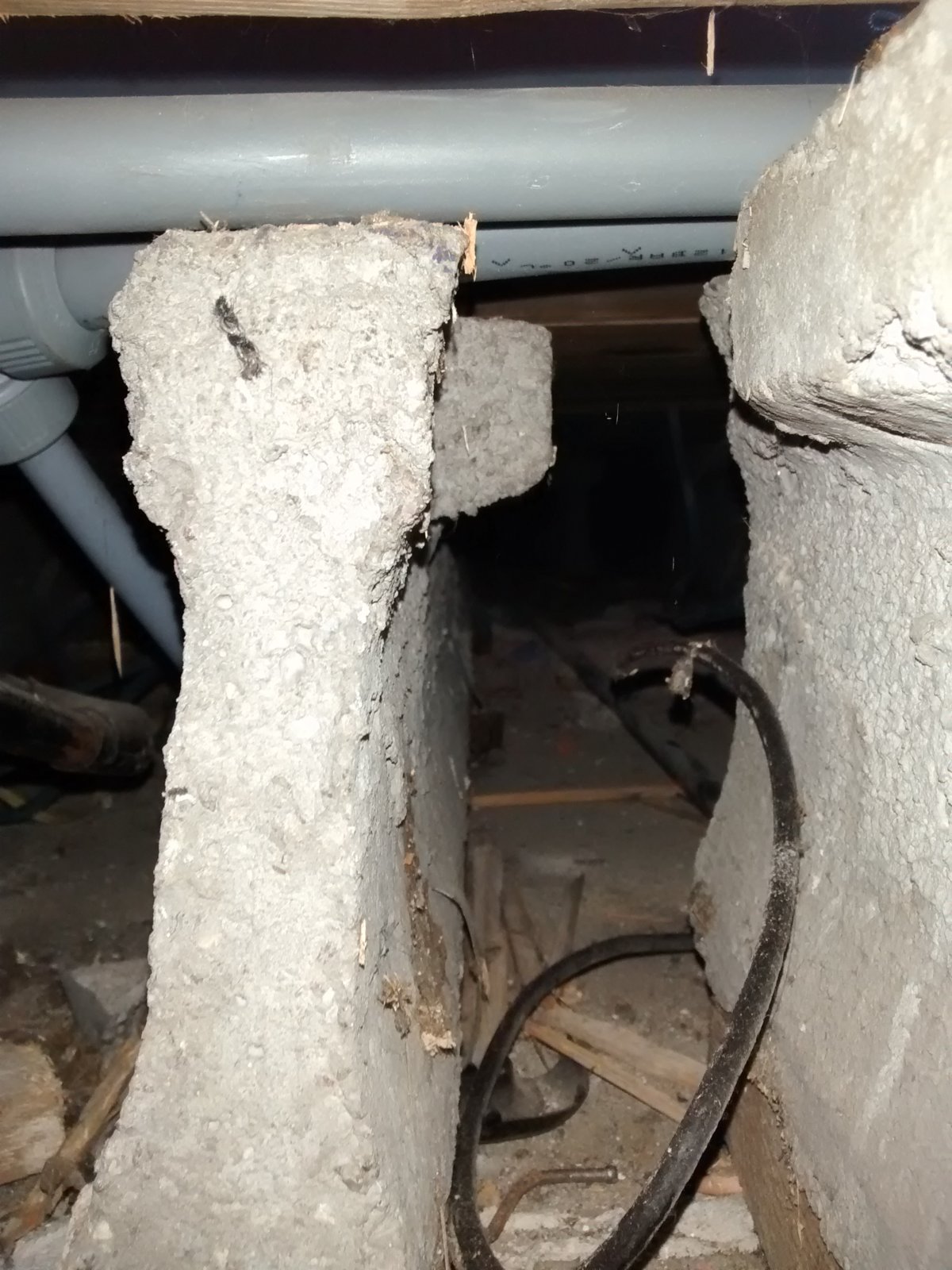

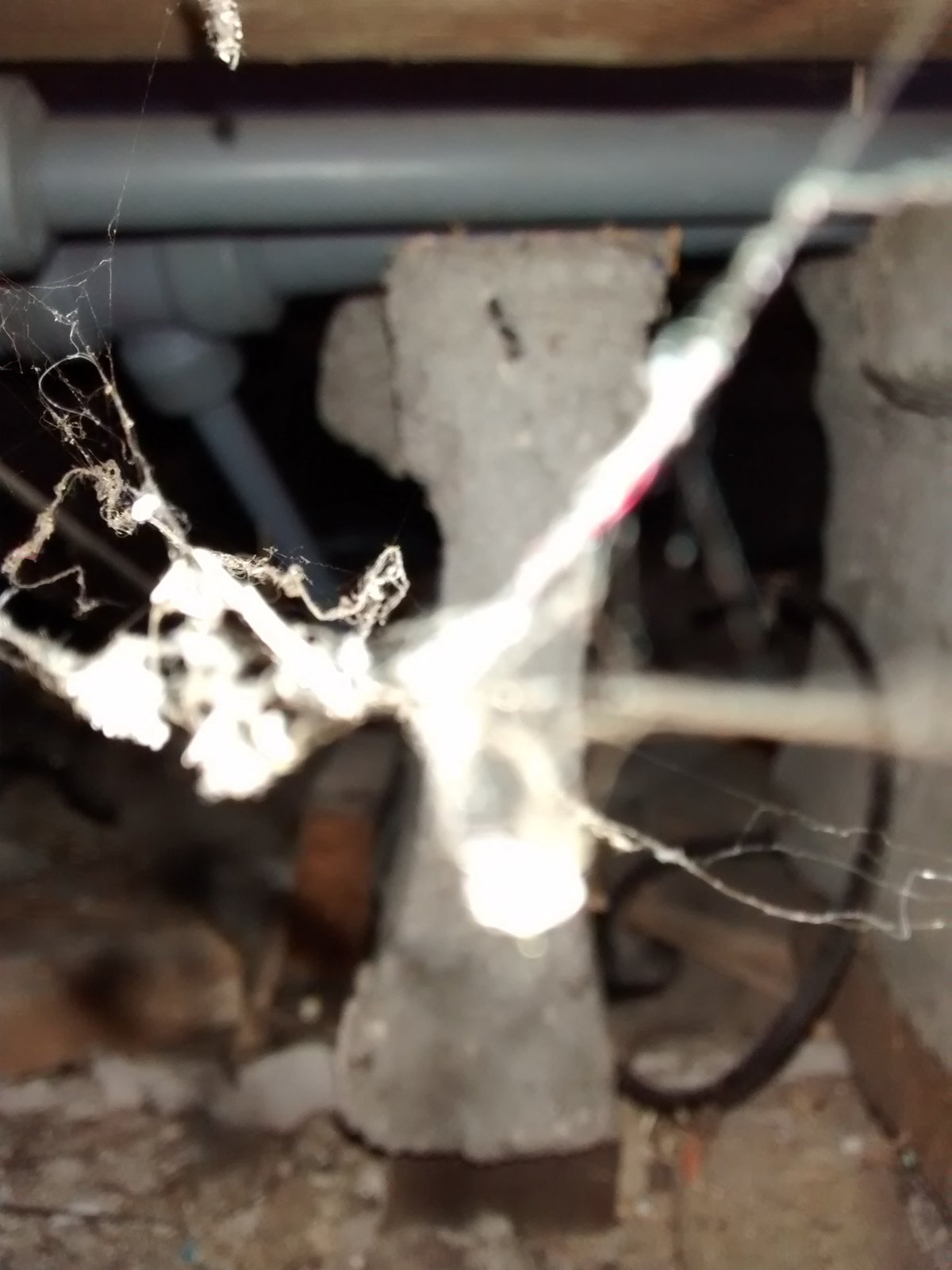

OK, had some boards up again the other day (to pull some wires in) and got some photos.
I also double checked, and yes, it's red brick in the walls.

There are thin straps cast into the concrete, these have been wrapped round the batten and nailed to hold the batten in place.
