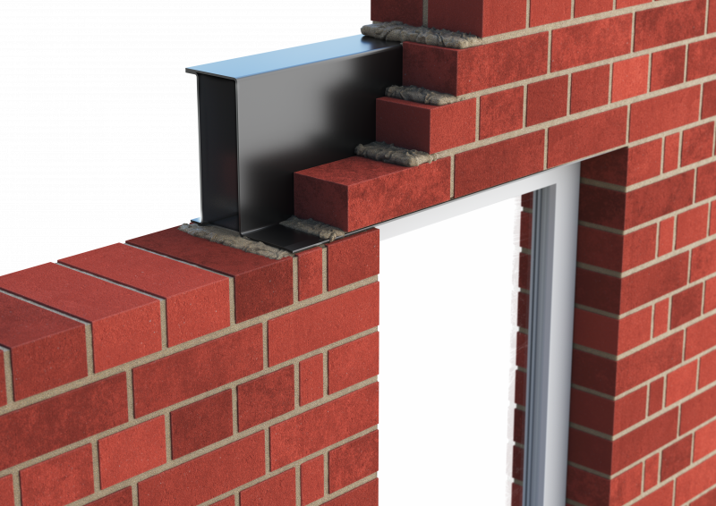

I'm fitting 3.1m bifold doors into a solid brick external wall.
There's only going to be a few courses of brick above the door and a flat rubber roof, so not much weight.
What type of lintel or beam would be best for this? There's lots of different types of RSJ beams out there and I don't know which one is best for an external solid brick wall.
Thanks.
A beam with a bottom plate to carry the outer brickwork would be suitable. If the wall is rendered then you could just stick in a wider beam and render to expanded metal lath between the beam flanges.
You might get a precast concrete lintel to work depending on the loads above.
Is your bifold floor supported or hung off the lintel? How thick is the wall? 225mm?
Floor supported, yep 225mm

The wall isn't rendered. A beam like the one in this pic? So the width of the welded plate would be 225mm which would sit on the bricks, but how would the bricklayer lay bricks on top of this? by building up the outer brickwork on top of the plate? Thanks.
Yes that would. It's a lighter weight / more efficient version of the beam with a plate welded on the bottom.

An opening over 3m in width isn't allowed in the normal Part A of the building regulations so to get an opening of that size they'd either already need an engineer to help (who could have specced a lintel) , or it'd have been designed new and so wouldn't be solid wall.
