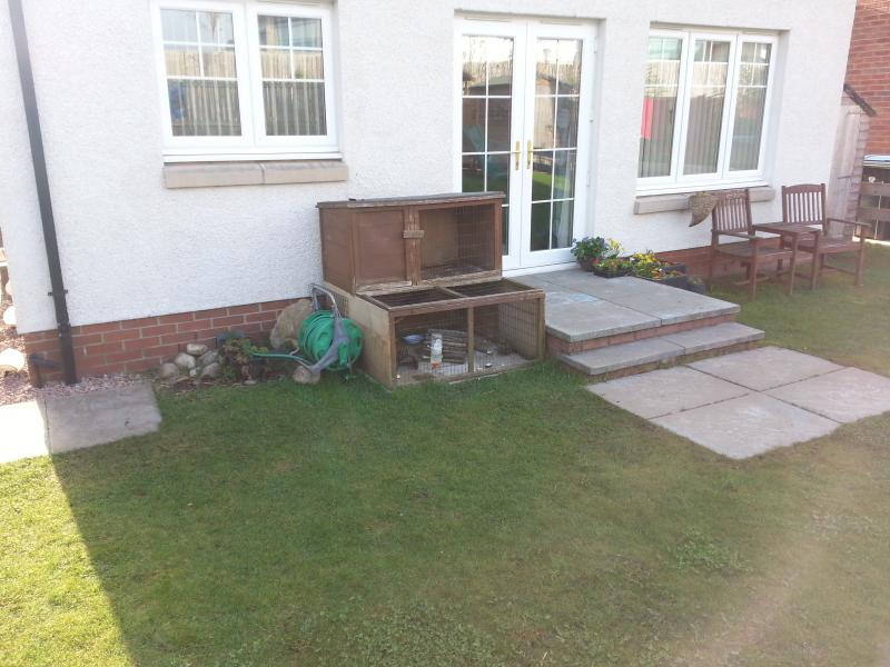

The garden currently looks like pic 1 below and I would like to build the deck from the end of the wall on the left hand side to just past the patio doors. The area will be 4.8m wide and come out from the house 3m.

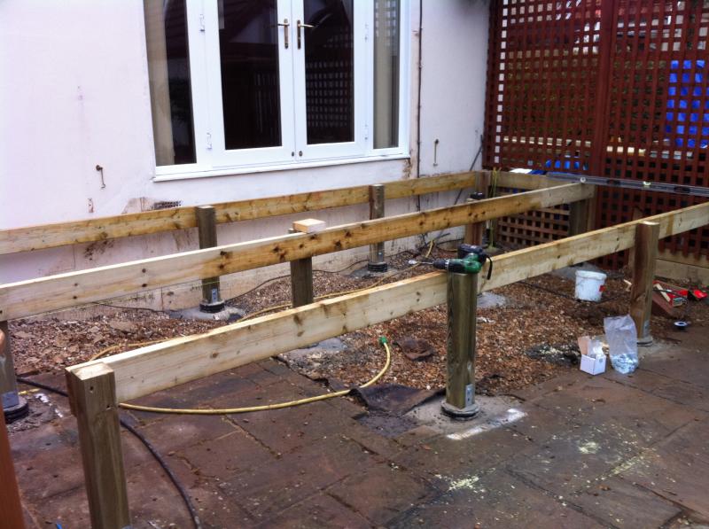

What I am aiming for is like pic 2 below

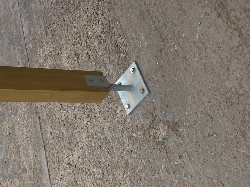

1. I was planning on concreting 100x100 fence posts for deck supports and also legs for pergola into the ground however I have been reading that is is not a good idea since the posts will rot in concrete. I read that it is better to use concrete pillars in the ground and then use bolt down anchors to attach deck supports and pergola legs to the concrete pillars. Something similar to the pic below. Is this advisable ?
2. If I went with the concrete pillars and the posts attached the top would it be advisable to do this for the pergola legs and also use these legs as supports for the deck ? So basically use the pergola legs as part of the frame for the deck. Or should I build the deck and then attach the pergola legs to the top of the deck using the bolt down anchors like in the picture below

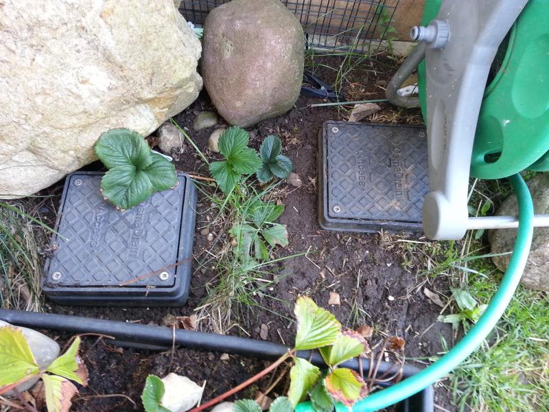

3. I would be building the deck over the below access points for drains so had thought I could have a section of deck which can be lifted (like a trap door) to give access to these drain points - is this advisable or am I just asking for trouble building a deck over these
4. My plan is to raise the deck to the height of the patio doors. As you can see from the picture below there is a raised step area roughly at that height. Do I need to completely remove this step area or could I lay deck boards directly over the top of the step area which is at the same height at the patio doors. There will be a pergola with roof over the top so not too much rain so fall on the actual deck but I was bit concerned that the deck boards that were sitting on the paving stones could be sitting in water and rot

For decking support post if you use timber you should make sure that they are UC4 treated. This is better than normal Tanalised treatment as it has a water repellent in it as well.
You can also buy incised posts that have small indentations before treating this makes the treatment go in further.
The Canadians use a system of small concrete pads for each pillar as you have suggested to raise the post out of the ground, have a look for the TV show Decked Out for some great ideas. Also searching Q-deck will give you some great guides on what to use for each component and how.
