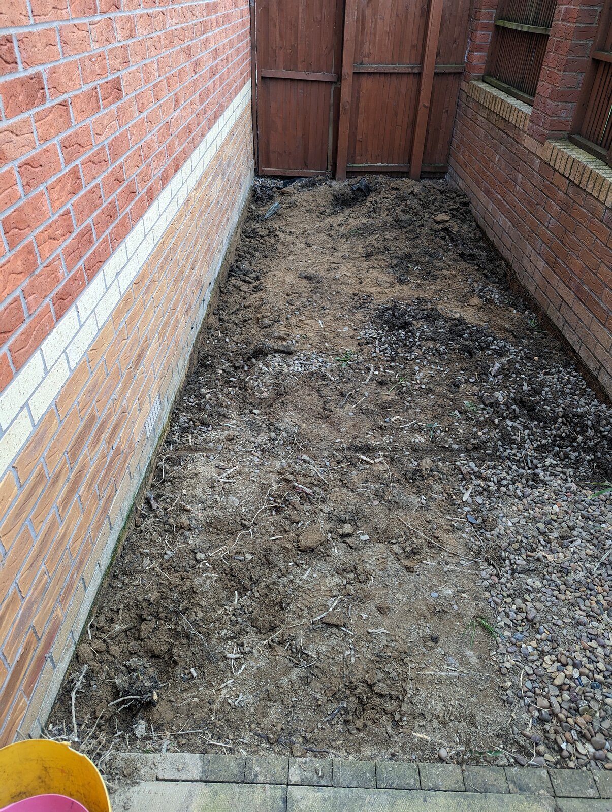

I've lifted the paving slabs next to my house and intend to pour a slab to build a bigger shed and am looking for advice.
I've attached a pic of what I have dug up (bamboo roots everywhere which I've removed).
I've read a pour needs to be 3 courses below the DPM.. is this right? And also about an expansion joint against the house.
50mm of hardcore and 100mm of concrete sound about right?
Appreciate any help.. thanks
A few tips, if you include a DPM it will make the shed less damp. The shed must fully cover or overhang the slab or it will get wet with rain. Run the gutters and downpipe to take rain away. Cast in conduits for electricty, conduits, perhaps water.
I see no picture.
Nice brickwork.
The bricks at the foot of the wall already look damp. See what you find when you dig.
The finished height of the slab must be three bricks below DPC. Can you see it?
