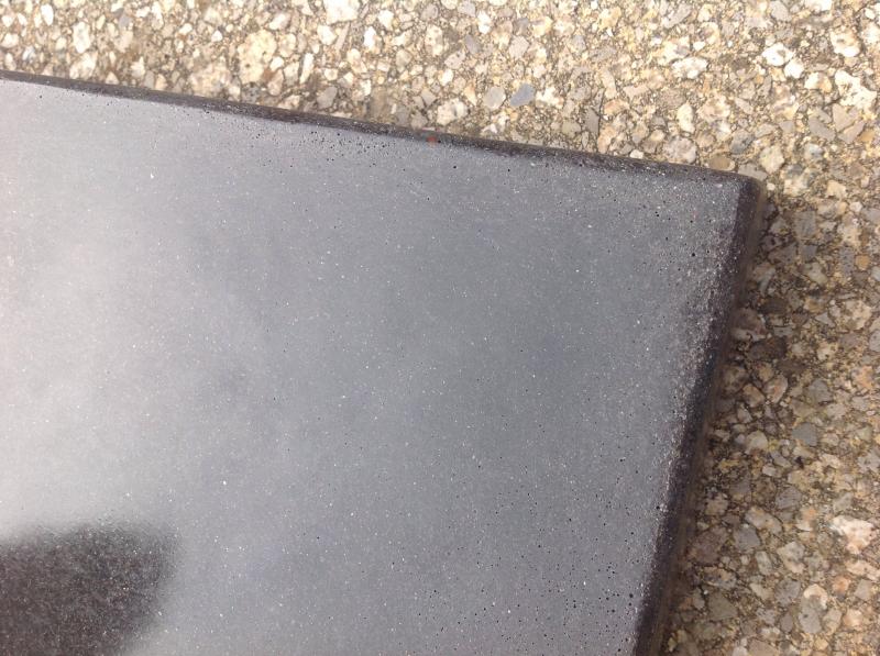

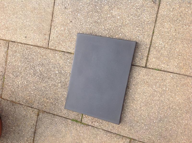

Hi everyone, few months on and after quite a few different mixes this is what I've got. This was my final tester which I could have filled all the pinholes but frankly couldn't be bother spending the time for a tester.
The problem I have is that I sometimes get a bit of discolouration around the edges on my testers and was wondering if anyone knows how to get rid of it if it happens on my actual worktop? Or better yet how to stop it happening all together?
Many thanks!
Is that a hand trowelled finish? Or is that the finished face from the base side of the mould were looking at?
Hence the air pockets.
Maybe your trowel didn't finish out to the edges evenly due to side bullnoses being left on?
I don't know but it looks good.
The image on the left looks "matt" whilst the closer up image has more shine.
