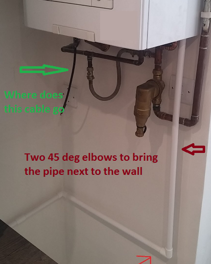

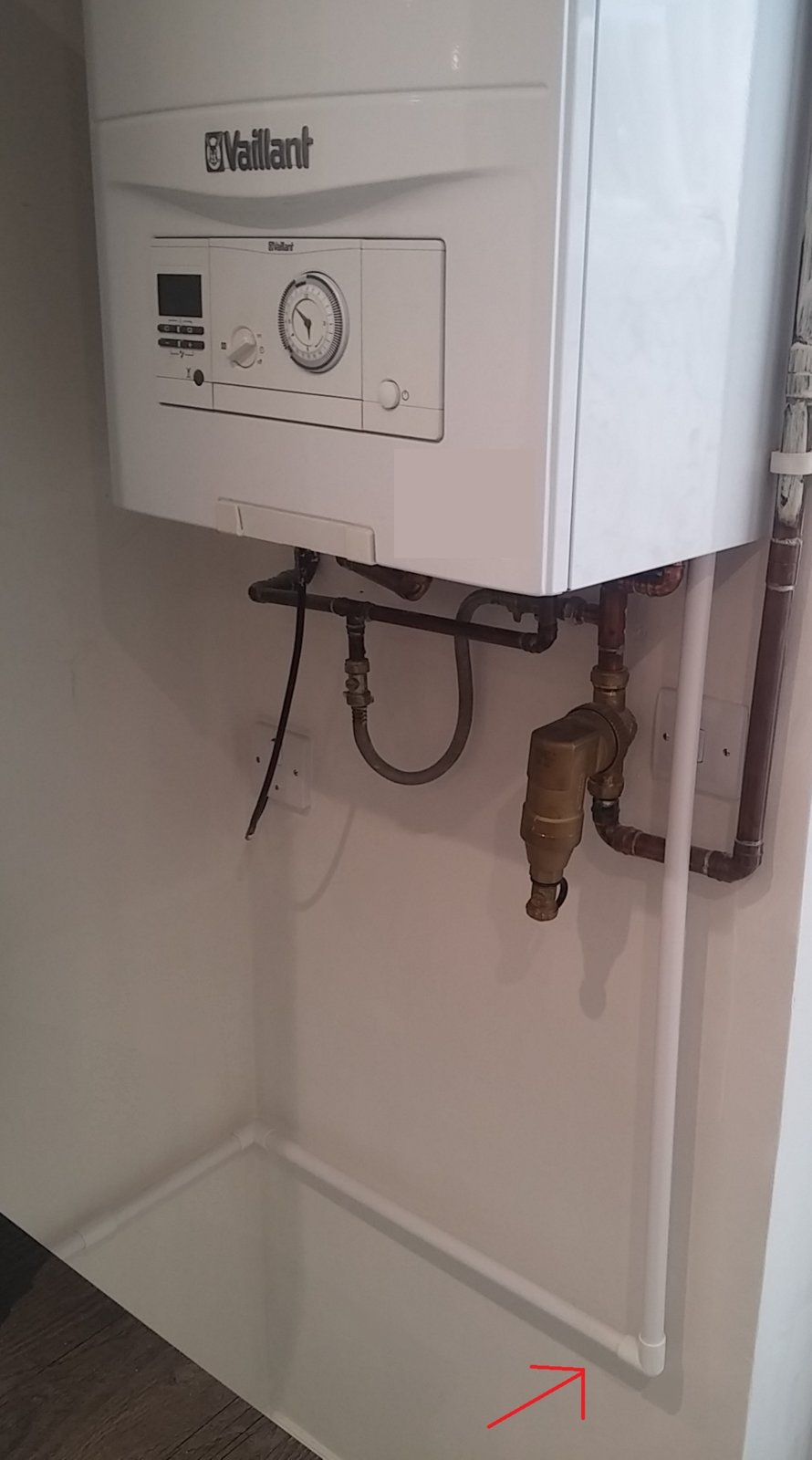

My condensate pipe falls down occasionally
I would like to place something where I have placed the red arrow, to prevent this.
However, I wanted to ask what would be an ideal thing to use?
I believe that clips are out of the question as the condensate pipe sits far from the wall

As suggested if you can get the installer back then get them to use spacers or offset using a couple of fittings. Also be careful near that switch :eek:
How old is it get installer back to install it correctly that would be the ideal thing
Yup, as @gas112 mentions, get the installer back in. He should be using spacers and clips, leaving it unsupported is bad practice.
No worries chaps! I will get the installer back on the job as it was me :D:D
Guess i did a cowboy job :mrgreen:
So i do as @baldykev suggested, with a piece of wood to the wall, then add the clip? Just curious whether there are there any other options?
Thanks guys
Thanks bernard. The cable is the power cable for the boiler.
Thanks guys
Is it your first?
You use Talon clip over clips, and the clips sit on the spacers and they are then screwed into the wall. They are usually used with pipes with insulation but it may give enough space to span the copper.
