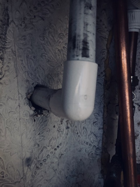

Hi, I had a boiler installed in my first floor flat and the engineer has left the condensate pipe sticking out of the wall by a few inches - it doesn’t connect anywhere. He says it can just drip into the earth below. Does that sound right?

No, it's wrong.
Was he a registered gas safe installer? Where did you get him from?
Yeah, website says they’re registered. They’re local. I just rang and asked him to take it to drain.
Can you give us a pic or 2, 1 from inside under the boiler and as the pipe heads into the wall and outside as it exits, it's definitely the condensate?
It will eat the render/mortar/brickwork over time if left like that.

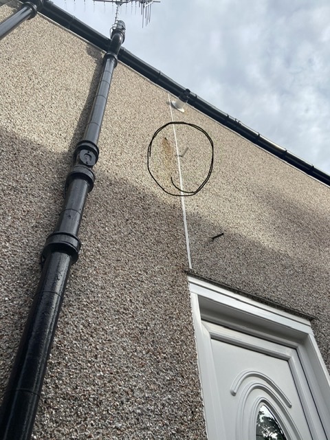

Posting
pics - inside boiler cupboard and outside wall.
No that is completely wrong, call him and tell him to sort it or call gas safe and ask for an inspection
Oh my .... :eek: and it's not even that far from a soil pipe, not have his ladders that day?? +1 Yup, get him back to get that sorted or reported.
oh... and .... :whistle: ...... It should increase by a pipe size to 32mm if it travels outside ;) and what make of boiler is it?
Hang on this is 21st C. plumbing - not the 1960's where a guy would climb a ladder and drill a cast iron soil pipe for a boss ;)
And drip on peoples heads @ the front door :eek:
