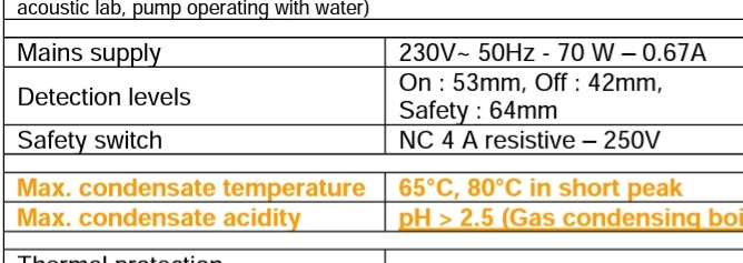

According to the tech specs, it has an auto-resetting thermal cut-out of 105°C,
This sure is toasty, and could cause a warm plastic smell, but shouldn't harm the pump (too much!).

Thanks for the replies, both. I found a number for Sauermann and had a quick chat with them. It's expected behaviour, and (as you pointed out) there's a thermal cut out to prevent fire. I must have got to it before it got to that point.

Yup -

It starts when the water level rises and activates the float and stops when the float drops down, thermal cut outs are a safey device and do what they are designed to do.
