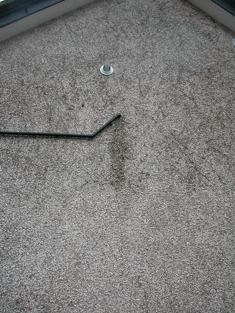

I have condensate leaking from the outlet pipe onto the pebbledash outside wall of my house. Does this need attention, or should I leave it? I understand that cement & concrete are affected by this condensate
Thank you very much John D for your reply. I'm attaching 2 photos. No, the flue doesn't appear to be dripping & the markn dries out when the sun shines on it, but is leaving a whiteish deposit. //www.diynot.com/network/Dakers/albums/
From where the leak is, it seems to suggest that the condensate pipe has actually come adrift at a join somewhere between the boiler and the outside wall....
Does the rest of the pipe have any fall? From the pic it seems to rise slightly.
